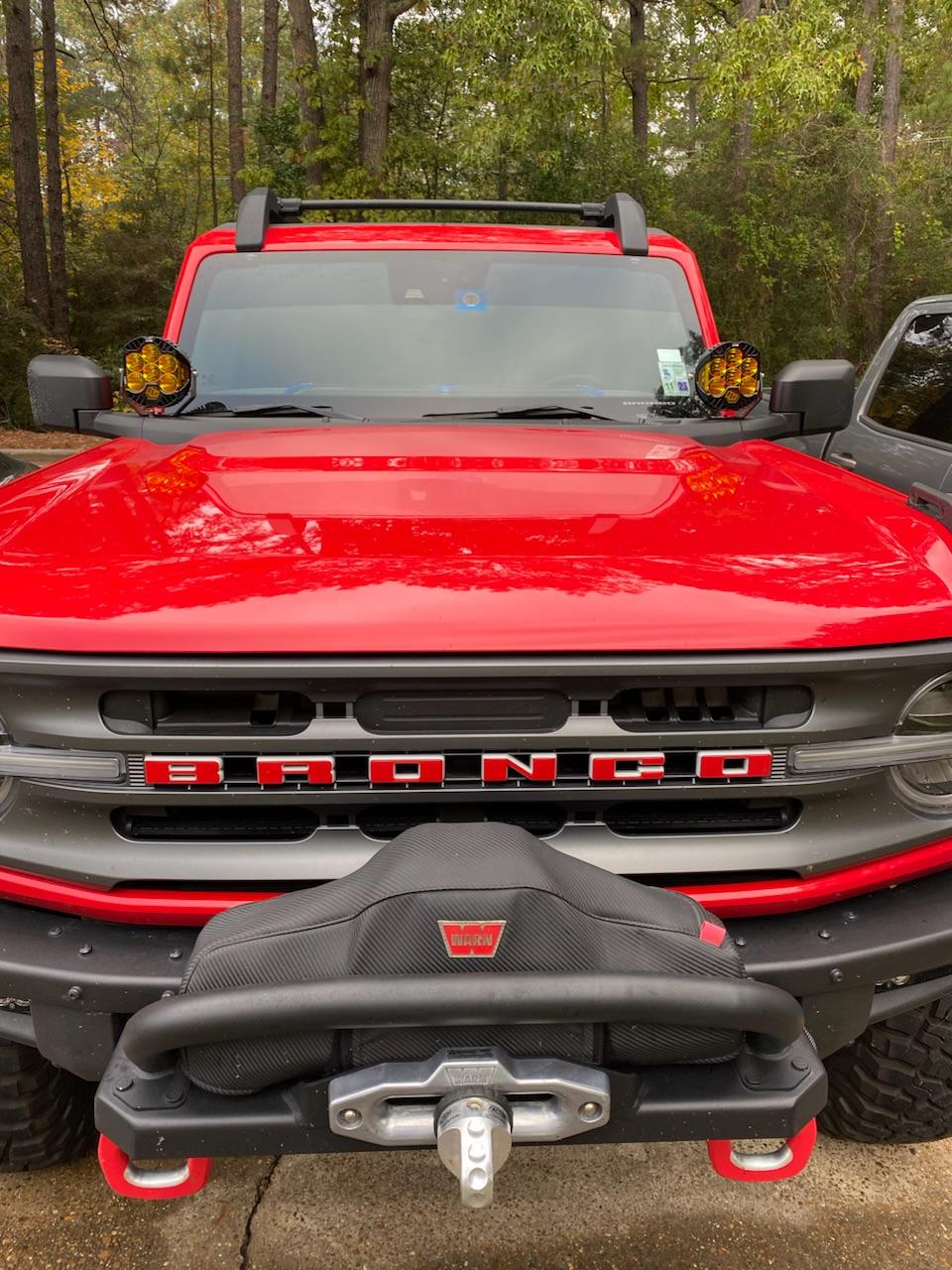

You don't want to run LP6 up there. They are way too big. They are also going to hit the antenna so they won't fit
I mounted my LP6’s on the pillars this weekend and agree 100%. They’re too big for that location, so will be moved to the front bumper. Plus, the glare reflecting off the hood is distracting.

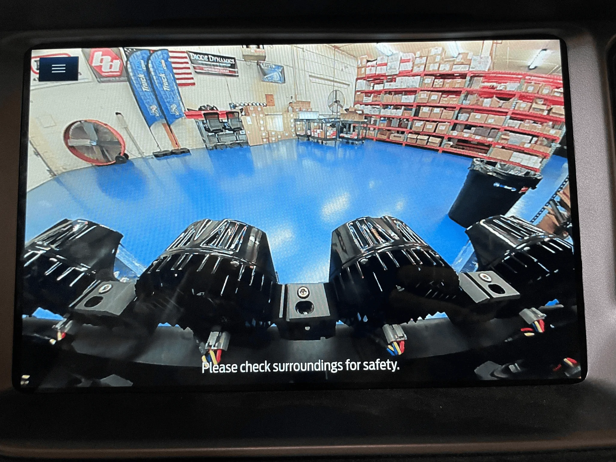

Thank you for the pic. can you also post the 360 pic?
So how much $$ is the 5 LP4 on the mod bumper? Also can you wire them up separately? For example, 3 to one switch and 2 of them to a another switch. I will be wiring them up to a switch pro.
It's a 6x LP4 setup. We didn't do a 5x LP4 setup
https://www.4x4truckleds.com/baja-d...4-pro-for-2021-ford-bronco-hd-modular-bumper/
It's $2,899.95 for the 6x LP4 kit.
They are daisy chained to each other but you can certainly buy a 2nd harness if you wanted to put them on 2 switches. Or 2 extra harnesses to have each pair on it's own switch.
Each pair of lights is 15 amps
I don't know 100% if 5x LP4 will fit with the brackets, nor do we plan to try right now unless someone hands us $$ to build the kit :) The truck is already built with 6x LP4 :)
