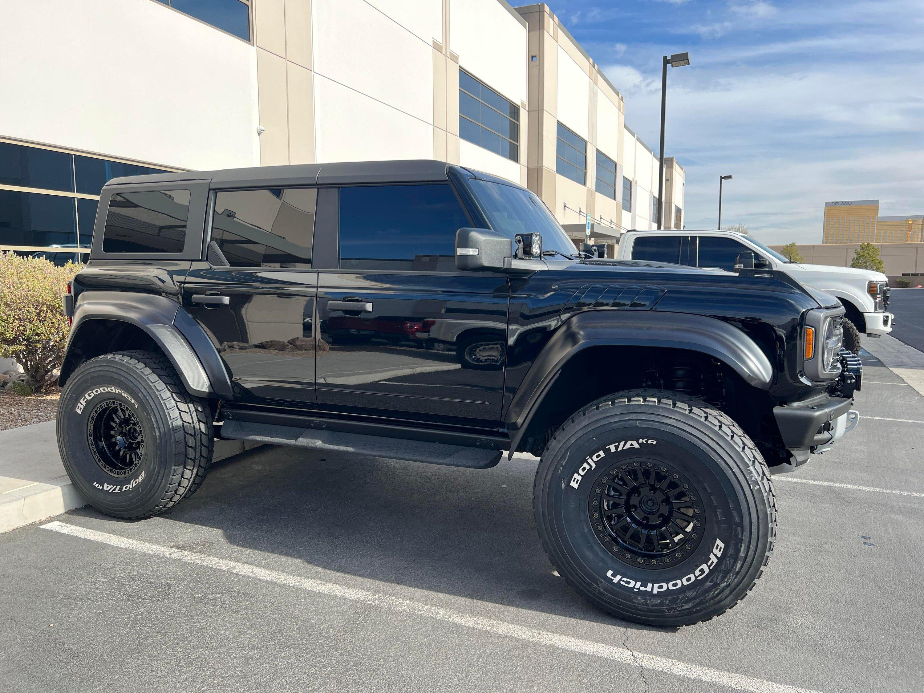

not sure on the 38" we didnt try that. I know that getting a true 39" requires a tiny bit more then just the front level which is about 1.25" higher. you need about 2" in front and plus 1" in the rear. we have that kit in the works and will release it in another week or so if you are interested in that.
This black Bronco Raptor is a buddy of ours and it has the 2" front and plus 1" rear with 39" BFG's looks beefy for sure.
That’s a sick Raptor…. Well done
