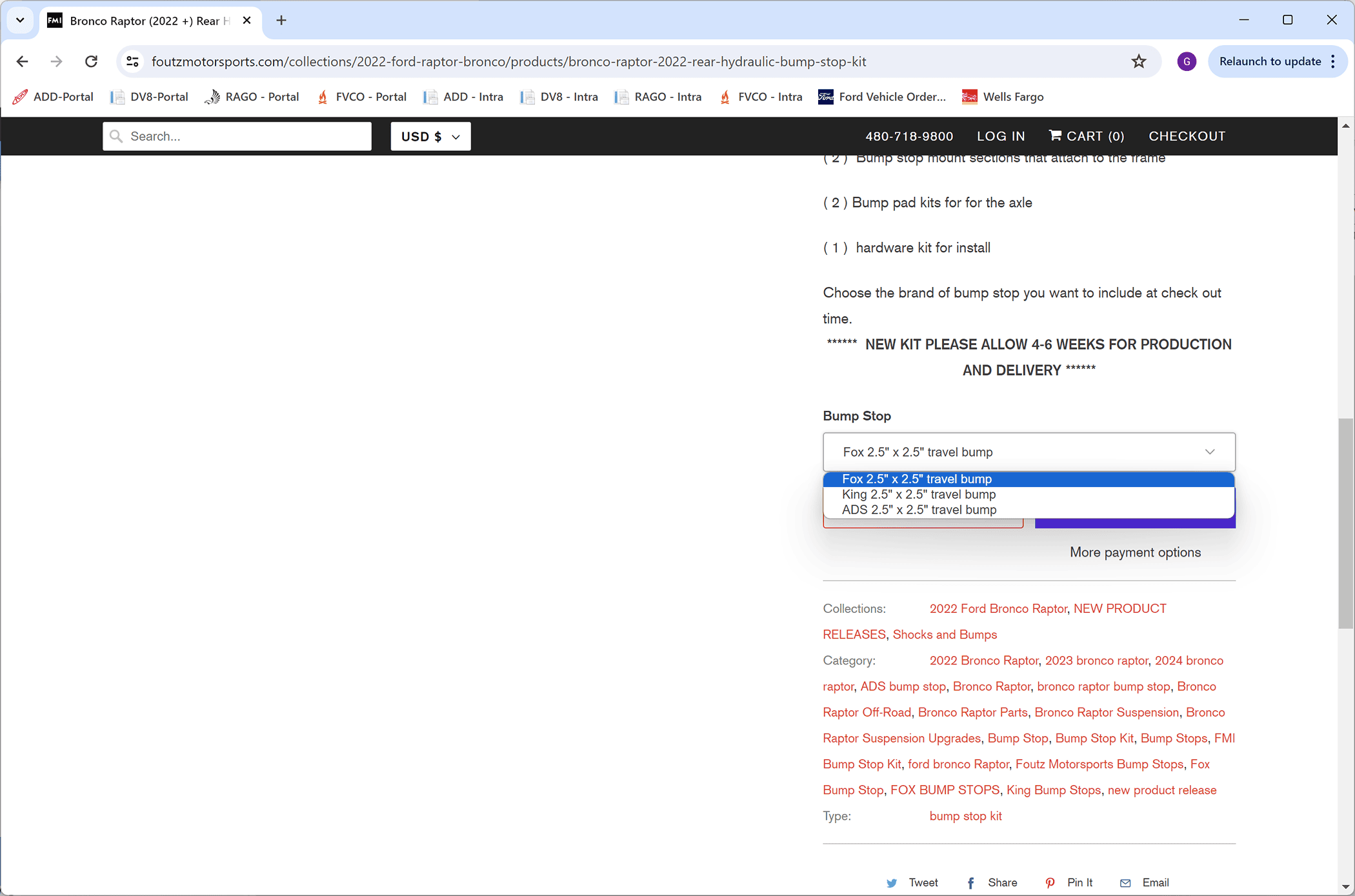

Hey Greg!
I want to used your bump stop kit with a king bump stop any suggestions or recommendations on where I should start or look for which bump stop with work with this kit?
you can just order the kit with FOX, KING, or ADS bumps on the website. there is a drop down box toward the bottom under the description text to pick which one you want.
Hey Greg I only saw ads or fox as options but no Kings.

Sorry for not clarifying I meant for the regular bronco and not the braptor.
the regular bronco rear bump stop kit we made with the ADS bumps only (they have a 2.1" OD and its unique) and have an updated version coming out very soon for that which is adjustable and you can use any bump stop in that kit. Sorry for the confusion there.

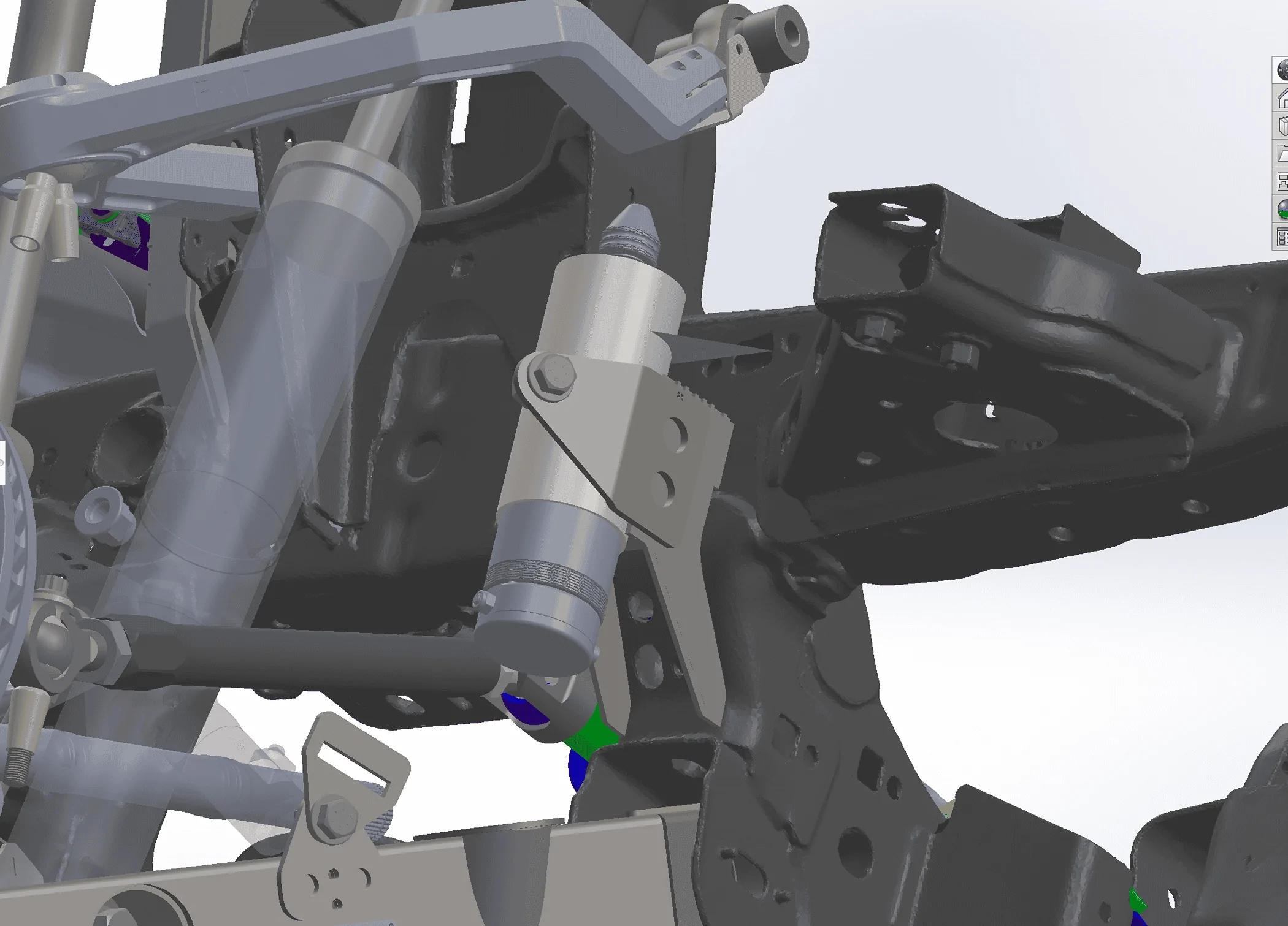

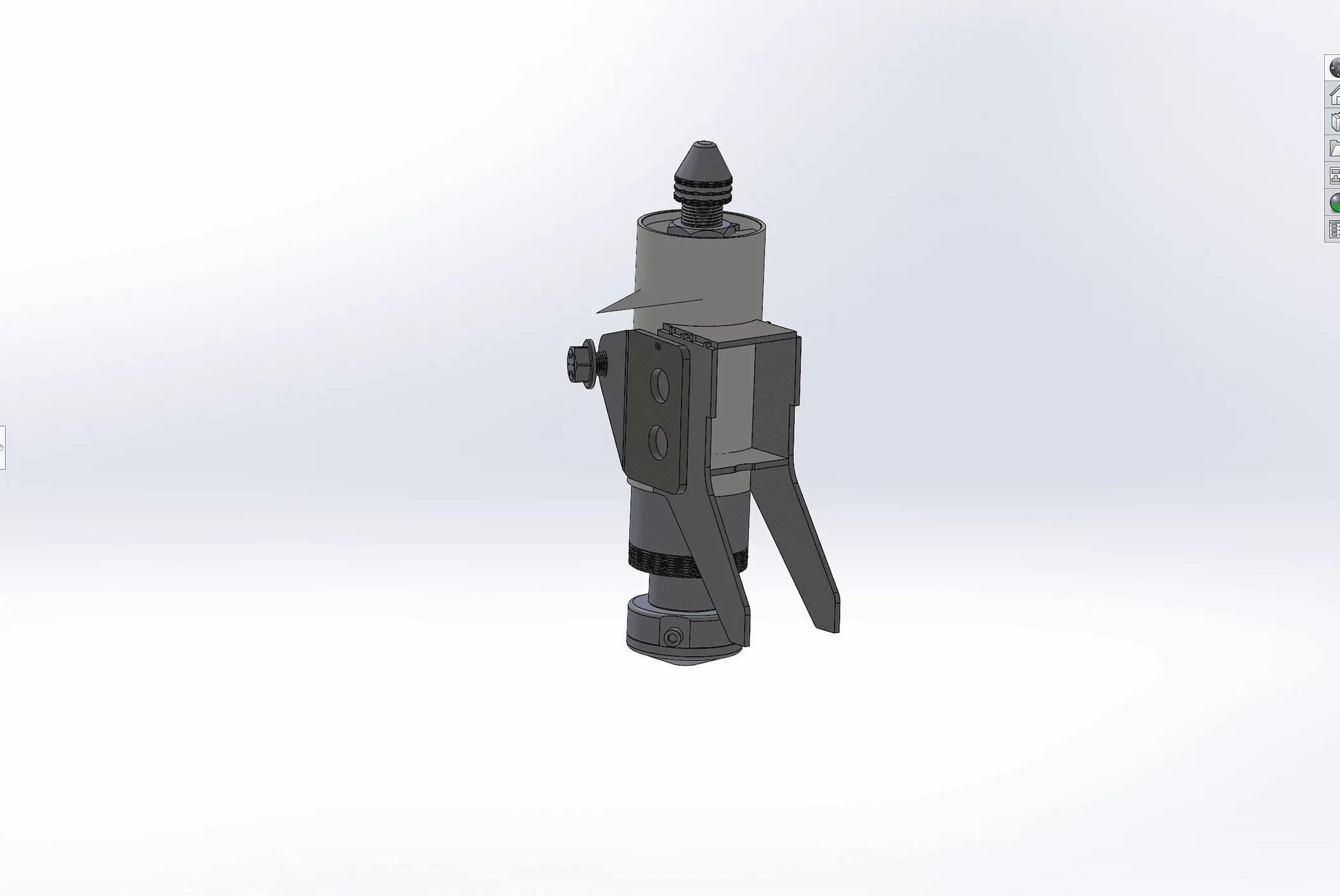

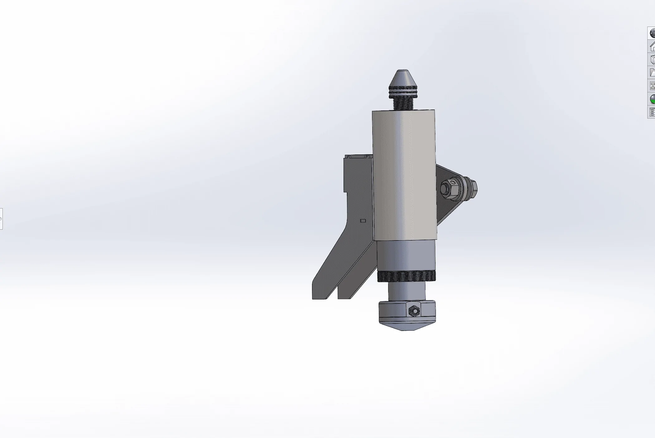

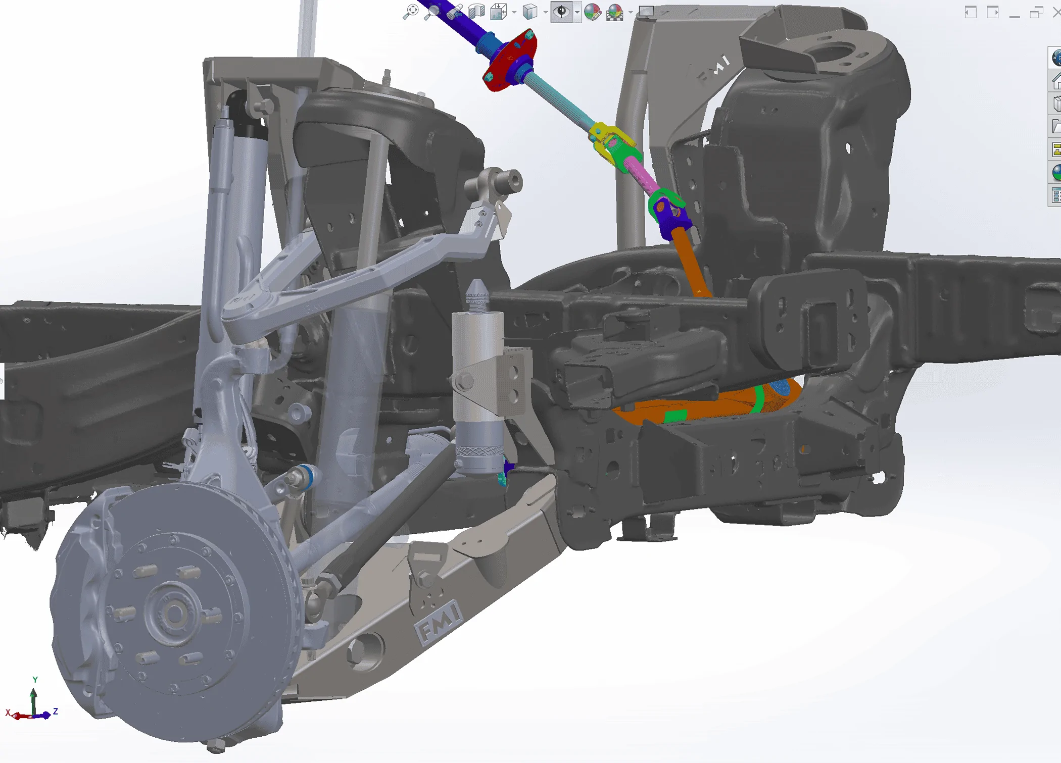

@GregFoutz - Do you have a pic of the front mount before it's welded on? I'd like to show it to my welder so he can see what I'm asking him to do. Looks to be pretty simple to me, but a pic would be helpful.
Here are a couple of CAD screen shots for you. Does that get you what you need?
