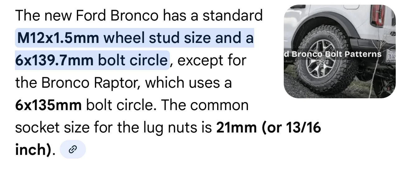

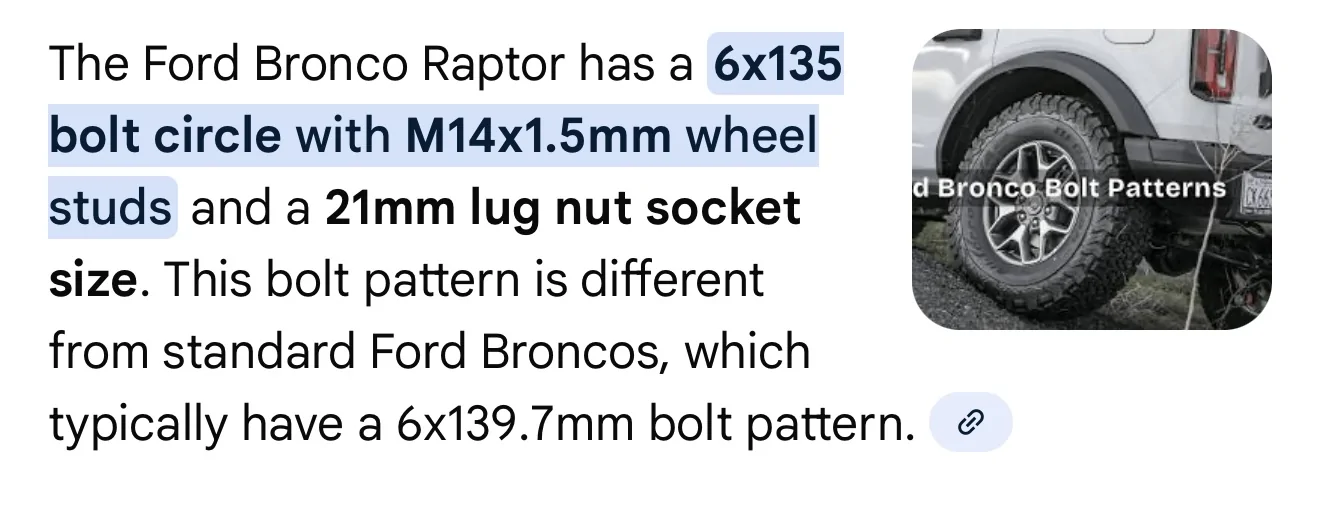

I know you mentioned the fender flares, but also put on the list:
All four fenders are different. Also the modular bumper has Ridged lights, stronger tow hitch set up, hubs are different, bolt pattern different/stronger, wheels are different. At the time padded dash was different. Carbon fiber interior option available. True dual exhaust totally different.

Thanks much. I added some of this. I couldn't verify that the hubs or wheel lugs bolt circle are specifically larger nor stronger (the bolt circle is actually smaller). I do suspect the hubs and hub bearings are likely larger and stronger. Some things such as something both cosmetic AND optional (CF interior) I chose to leave out. "Editorial" decisions I suppose...
My understanding is the raptor has a different bolt circle and larger diameter studs. I will check into it tomorrow..
Smaller bolt circle and indeed larger diameter bolts. Added that.
This is what i found if true. Thank you again for all the great info you have posted so far.
