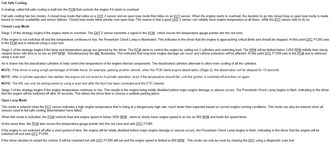

The vehicle would've went into limp mode and severely limited power far before significant damage likely would've been done.
There's a few different stages for the overtemp strategy. Sounds like you were probably only in the first stage most likely.

Wow! Good info. Looks like I was still in the early stage of overheating. Thanks!
