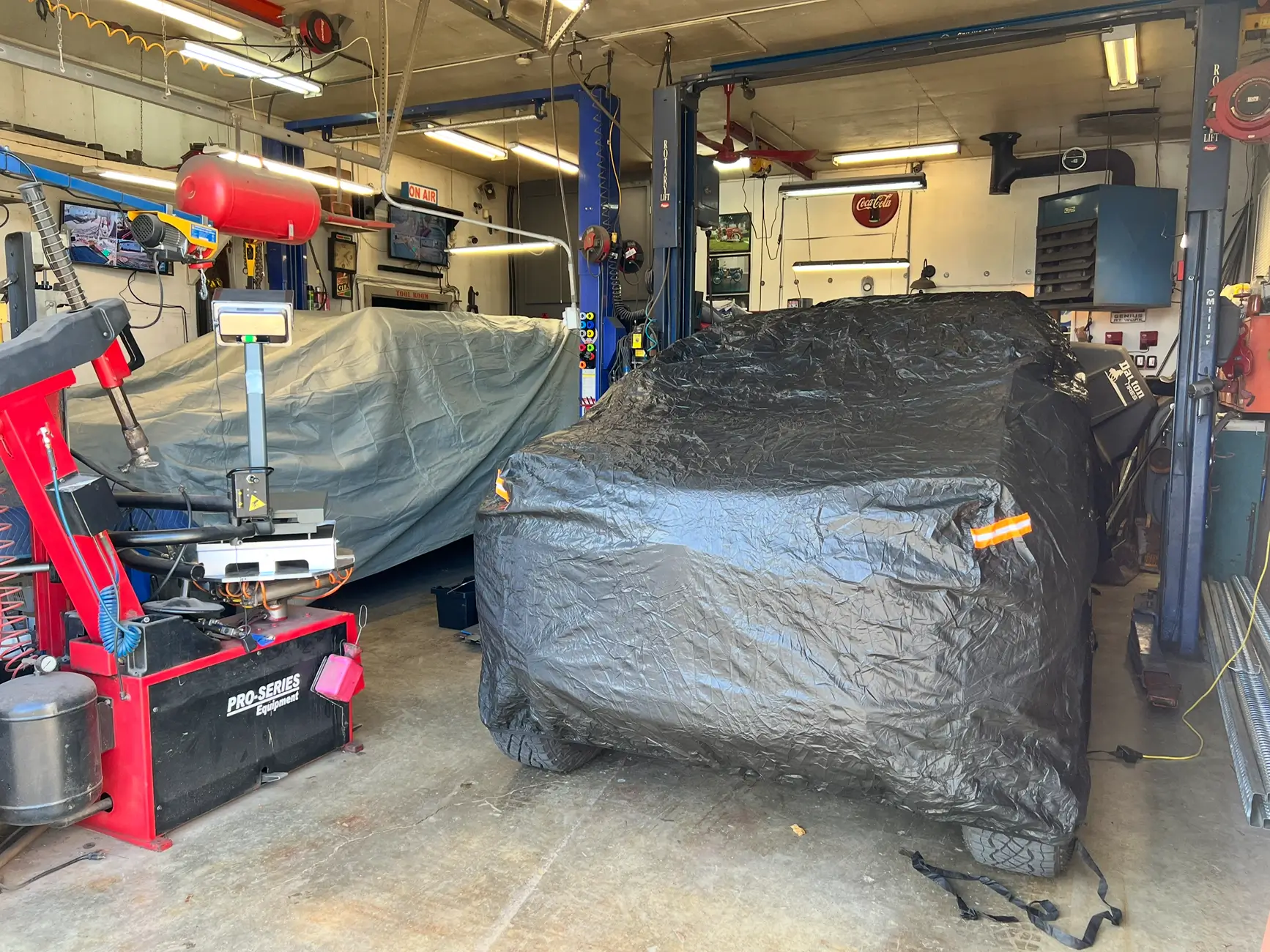

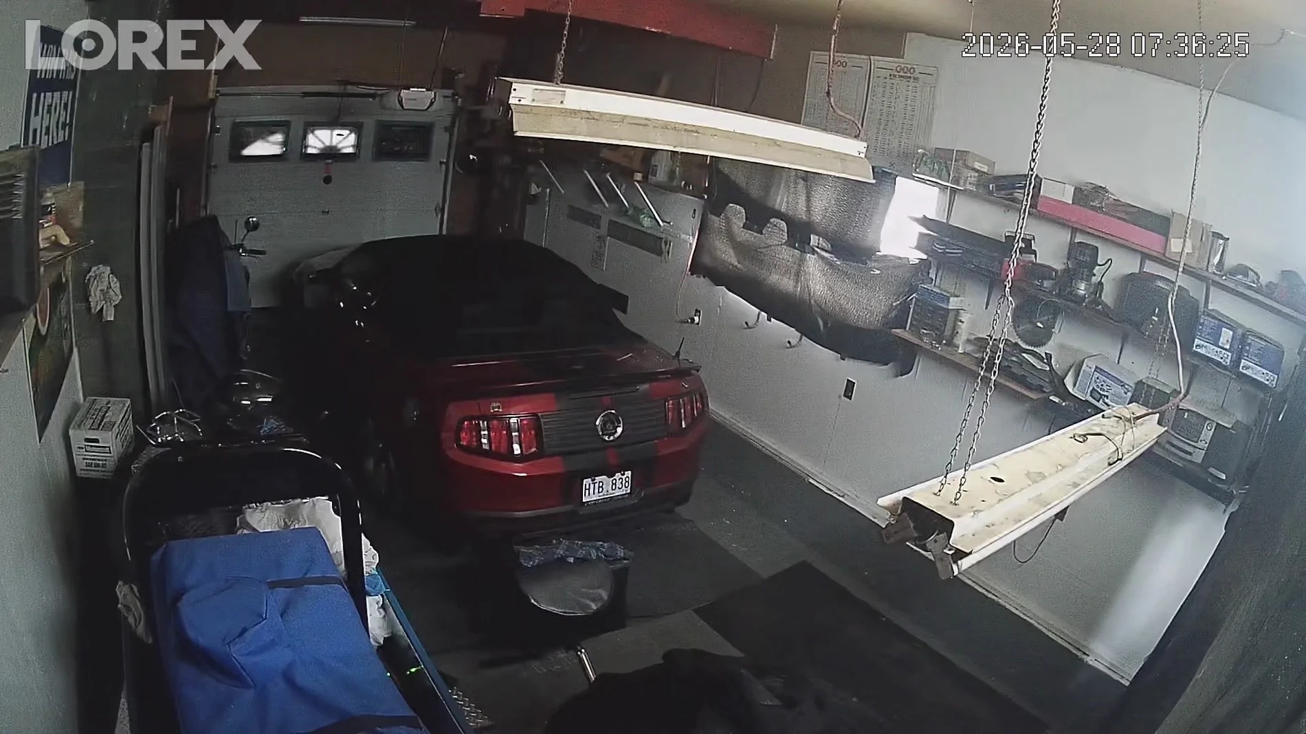

This is how I store our vehicles in the winter. Battery tender, no fuel additive, don’t worry about what’s in the tank and they stay firmly on the floor. The 2012 Mustang is stored the same in our other small shop. After 6 months get in, turn the key and drive off.
