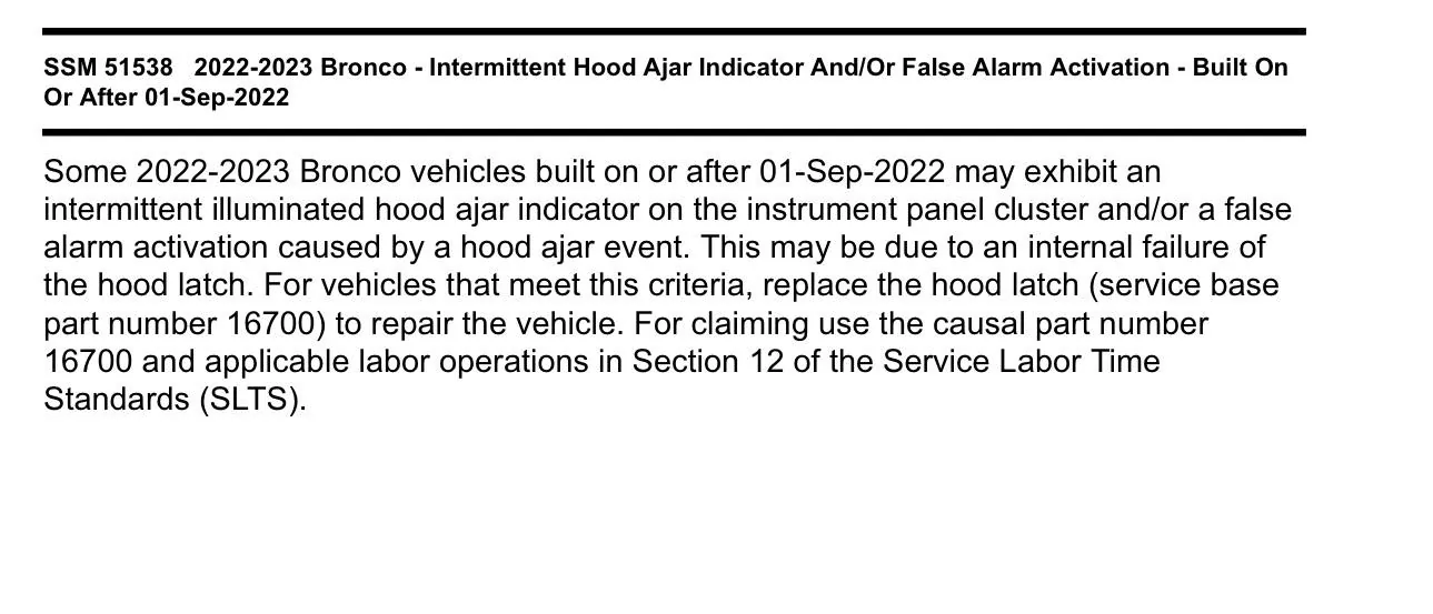

Call your dealer. I typed up a long thing about it I got this from another member.
Remember. We still love our broncos. We all are suffering from first world problems.
