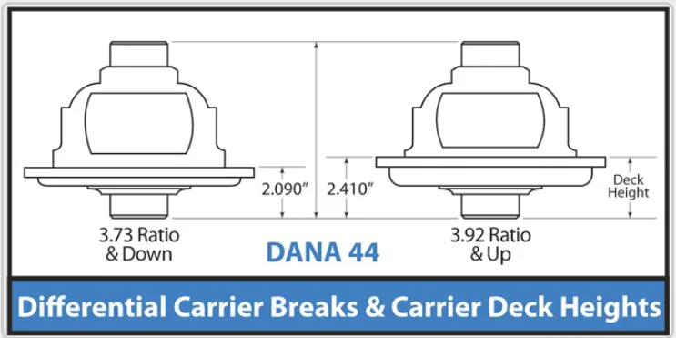

These are the old school D44 carrier differences. My carrier matches neither, though it's closer to the 3.92 carrier at 2.390".

Hmm. I'd also note Dana 44 and Dana 44 AdvanTEK are two different things too. The older Dana 44 was a 8.5" rear end, the newer AdvanTEK is 220mm - so slightly different despite having an almost identical name. I'm sure you know that already, just posting for other folks who see your picture and don't realize it isn't the same as what's in our M220s
