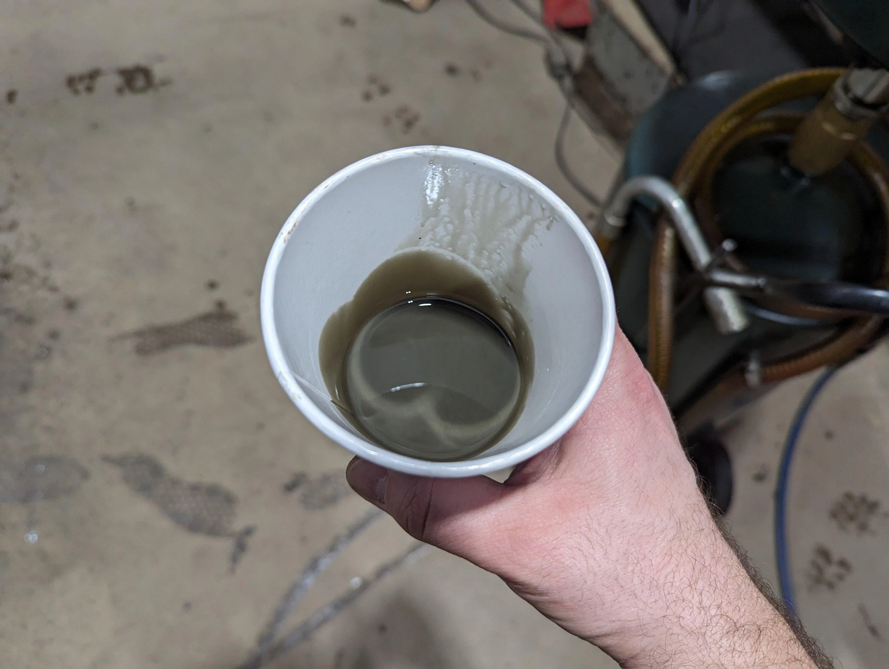

So I had them change my diff fluid in the shop yesterday in case some water got in.... good thing I did.
Ford Bronco Broke another Axle... (Video) PXL_20240214_203020724.MP
