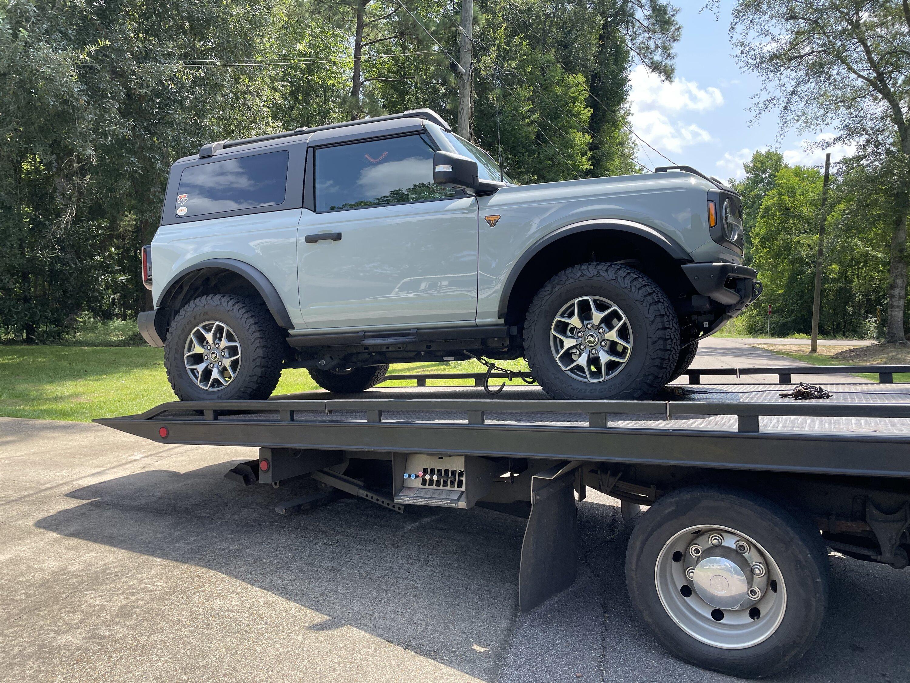

Wrecker service came by to remove the paperweight. He tested both the battery and key fobs. Both were fine, but the Bronco was a total brick.
Cannot put the truck in neutral w/o power to the system. Has to flatbed transported when this type of failure happens.

Under the shifter boot is how one moves the vehicle gear from park to neutral. You pry up the boot and then insert a screwdriver to manipulate the lever that allows the gear to be change when the vehicle has no power or wont start. I realize it is a new vehicle but the majority of towers will know how to do this. The step by step instructions are in the owners manual.

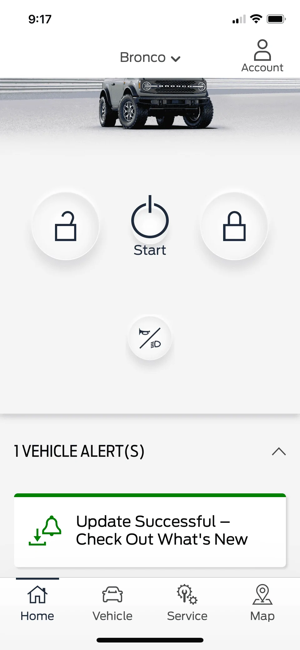

Ran prefect until this morning. Dead as a doornail. No response from anything except the alarm system.
Technician said it might be the battery. 13V to crank and 3V for the alarm. Sure enough 12.5V on the battery (measured correctly this time).
The truck is less than 1 year old, and had zero indications of low voltage.

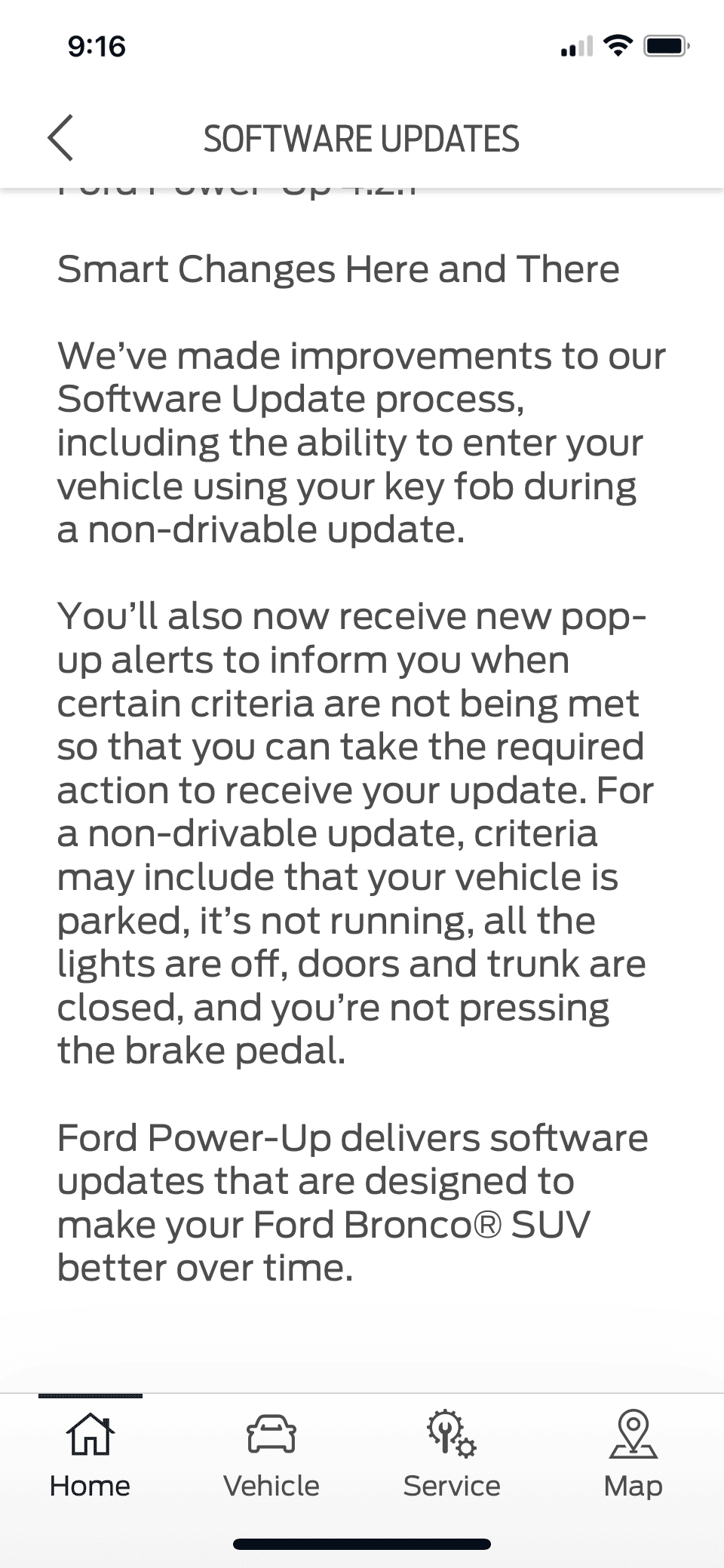

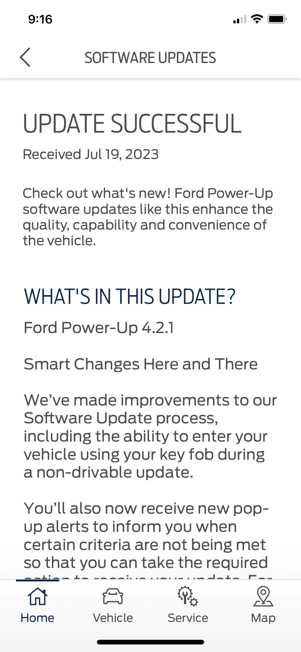

There was a recent software update this week, so I'm wondering if anyone else is experiencing voltage issues this week.
or... Is it just me?
Update:
I remeasured the voltage after connecting a charger to the battery for 30min. The battery holds 13.5V without issue. Zero life in the Bronco. Brick....
Software was updated last night...

yup it got bricked and the only way to fix it is with FDRS at a dealership. OTAs should not work this way but whatever, Ford IT sucks. Better option is turn updates off and do them if you take it in for an oil change or just schedule it so its not sitting at a dealer for days.
