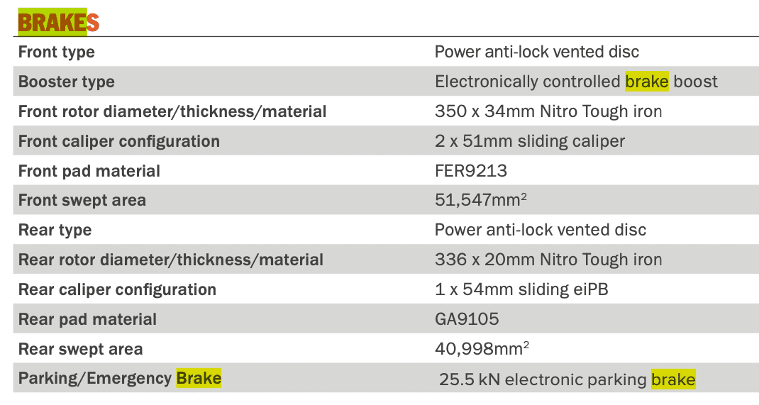

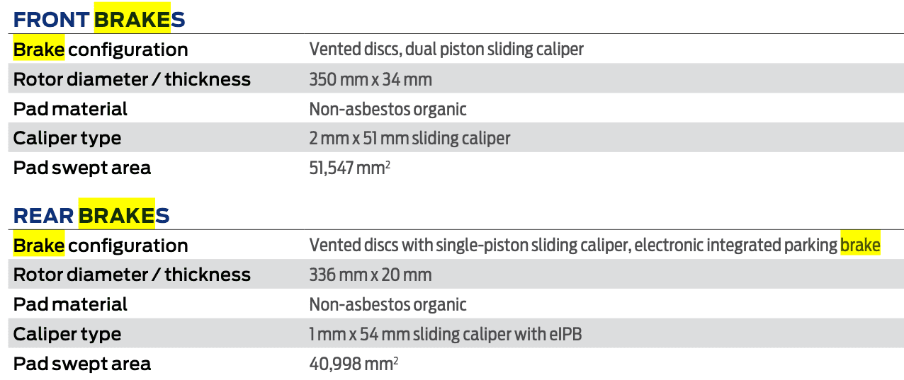

That is not the Bronco spec, here it is.
Rotor diameter/thickness, Front 311 mm (12.25") x 34 mm, Rear 308 mm (12.12") x 24 mm
2021 Ford Bronco Full Tech Specs
