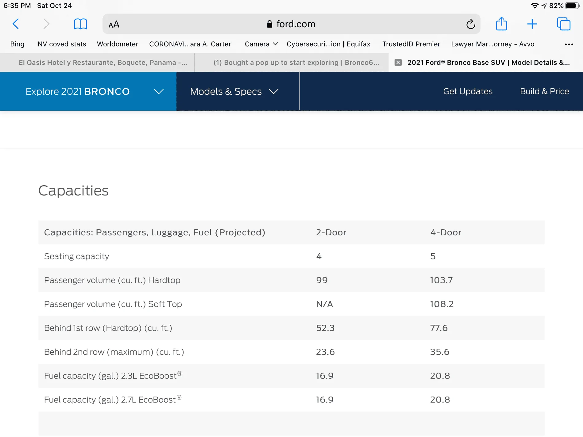

You have 5 people in your family, however the Bronco has 4 seat belts ...I believe.
The 4 door definitely has 5 seat belts, just like a 4 door Wrangler. However, the Bronco has been determined to not meet my needs unfortunately.

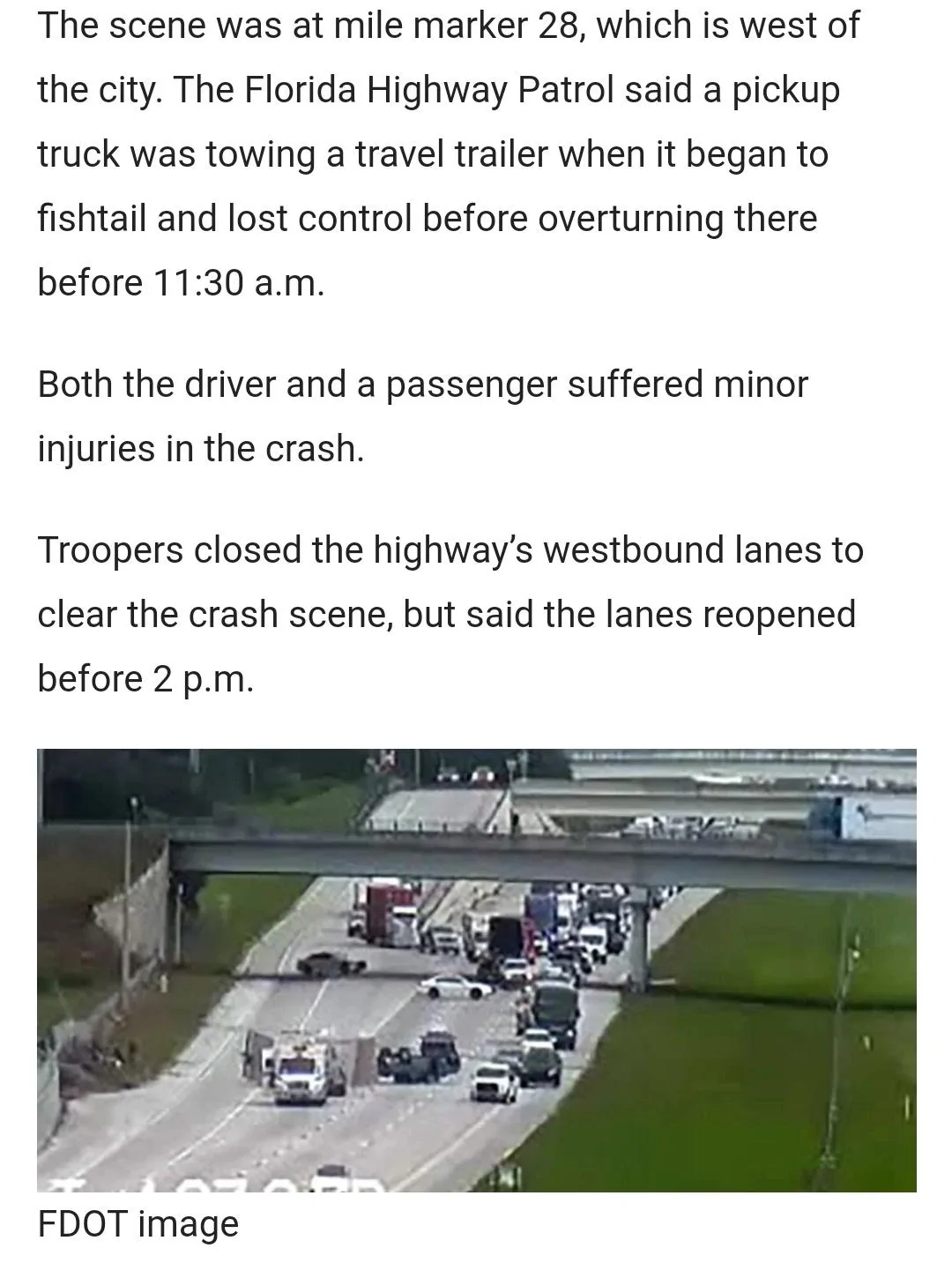

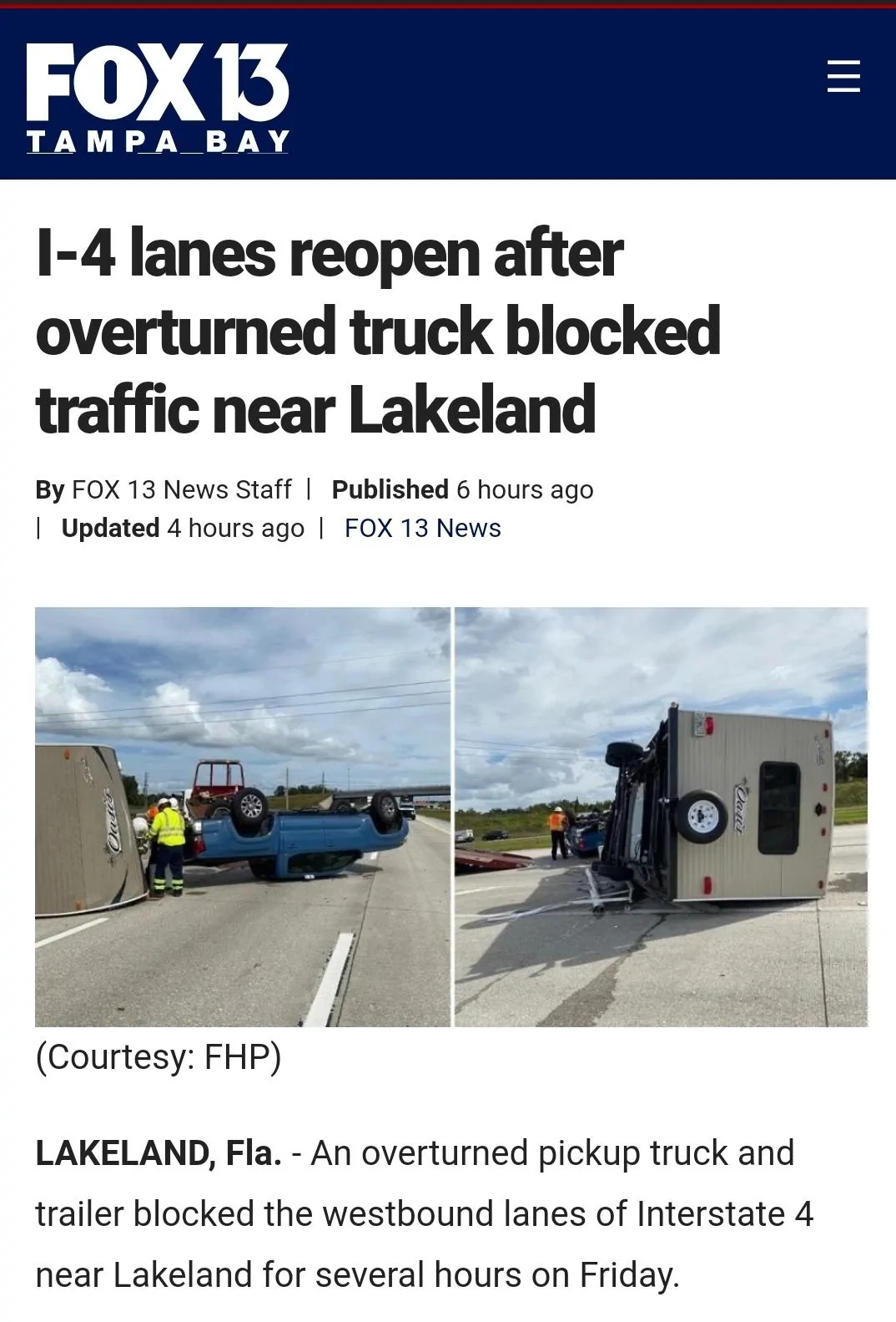

I wanted to add the real world example of a trailer overpowering a tow vehicle for anyone whom may come across this thread in the future. If this can happen on Florida where there is little to no elevation then I could not imagine when going through the mountains.
You're absolutely right. This whole time I thought the 4 door had just 4 belts and it does, in fact, have 5.
Also a good warning to not push the weight limits. That pic got my attention!

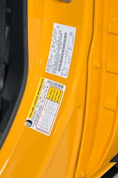

I just caught a glimpse of the payload sticker in another thread. 816 pounds! Granted it is from a two door, no idea what the four door will be? 816 seems light though. Two adult men, a winch and a cooler might be pushing it.

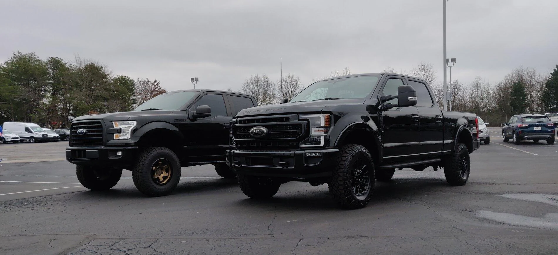

Here is my new tow rig that I picked up yesterday next to my F150.
Ford Bronco Bought a pop up to start exploring IMG_20210109_124508

Good for you. I think you made the right decision. The Bronco really is a one purpose vehicle and towing is not it.
