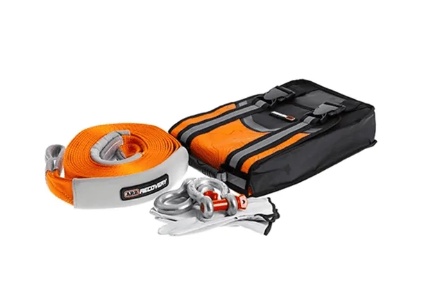

You can't go wrong with one of the ARB "kits"
ARB Weekender Recovery Kit
https://www.4x4truckleds.com/arb-weekender-recovery-kit/
Ford Bronco Recovery Strap - Where do I start? 1657418973236
Includes:
  • ARB 17,600 lbs snatch strap (ARB705LB)
  • 2 type “S” Galvanized 4.75T rated shackles
  • Leather Recovery gloves
  • Rugged PVC recovery bag

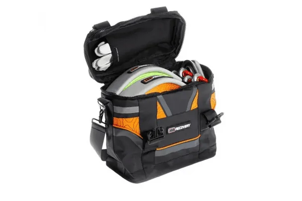

ARB Essentials Recovery Kit
https://www.4x4truckleds.com/arb-essentials-recovery-kit/
Ford Bronco Recovery Strap - Where do I start? 1657418996560
Includes:
  • 17,600 lbs snatch strap
  • 26,000 lbs tree trunk
  • 19,800 lbs snatch block
  • Snatch pack storage bag
  • Two 4.75T bow shackles

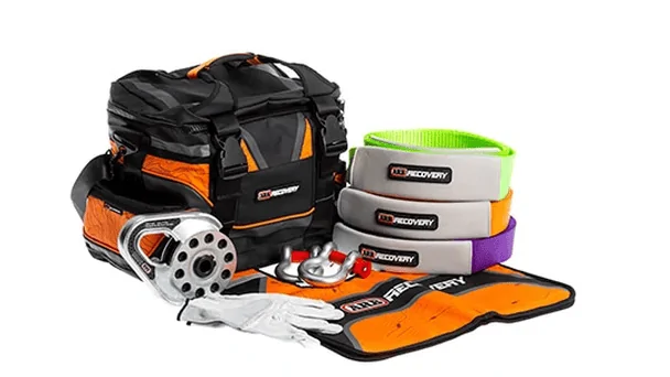

ARB Premium Recovery Kit
https://www.4x4truckleds.com/arb-premium-recovery-kit/
Ford Bronco Recovery Strap - Where do I start? 1657419034272
Includes:
  • 17,600 lbs snatch strap (ARB705LB) featuring genuine 20% stretch, 100% nylon, and made with reinforced eyes
  • 9,900 lbs winch extension strap(ARB720LB)
  • 26,000 lbs tree trunk protector (ARB730LB)
  • 19,800 lbs snatch block (10100020)
  • Recovery damper (ARB220)
  • Winch pack storage bag
  • Pair Recovery Gloves – cow grain leather palm, cow split leather back
  • 600gsm PVC recovery bag (ARB501A)
Basically a snatch strap is used to have another vehicle pull you out of something like sand. You get a bit of momentum from the first vehicle and as it pulls the line stretches and "snaps" you out.
A recovery strap is used for a steady pull. NEVER get a running start with a recovery strap. Used if you are stuck in a hole and need someone to help pull you out as you drive out. Again you don't use existing momentum but you assist someone by pulling them as they drive out. This is also used with winches as you'll attach it to the tree safer/trunk protector.
A trunk protector/tree saver is a smaller strap that goes around a tree. It helps protect the tree so that your winch/lines don't dig into the tree. Throw it around a tree then attach your winch/recovery strap to this and winch yourself out.
Winch extension straps are used as they definition is... to extend a winch line a bit.
No matter what if you are hooking up any of these to something else (winch, tree, another vehicle) you want to use a dampener over the line. The Premium kit includes that, which goes over your lines, whereas the other 2 kits you would just use the bag itself. In a pinch, throw a towel/shirt/matt over your line. But ALWAYS have something thrown over your line. The idea is IF your line snaps, it'll fall to the ground from the weight of the dampener rather then fling around and hit someone.
And ALWAYS stand clear of vehicles/lines when a vehicle is being recovered. Do NOT stand next to a line. Just be safe.

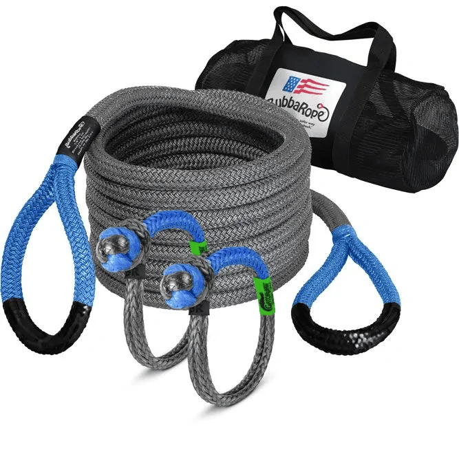

I had a 7/8” Bubba Rope for my F-350 for years. Pulled out forklifts, my truck, other 1 ton trucks, fedex trucks. Sold the rope to a fedex guy that “had to have it”. The Bronco’s weight is on the edge of what a 3/4” kinetic rope will do, but I’m getting the 3/4”x20’ this time around. That 7/8”x20’ is a pretty bug gear bag. But they can get kinda violent. Make sure you know what you’re doing. Tow straps that have no stretch won’t slingshot at your head, but that violent yank is tough on both vehicles.
Eventually you’ll want a couple straps, a winch, shackles, and a kinetic rope.
Most guys should start with an ARB kit (bullet proof quality) as others have suggested. The kinetic rope is more fun, but a little advanced (make sure whatever you’re pulling on is strong - like a recovery point. The Bronco tow hitch is kinda weenie. If the other guy’s hitch snaps its coming back at you at a great rate of speed)
