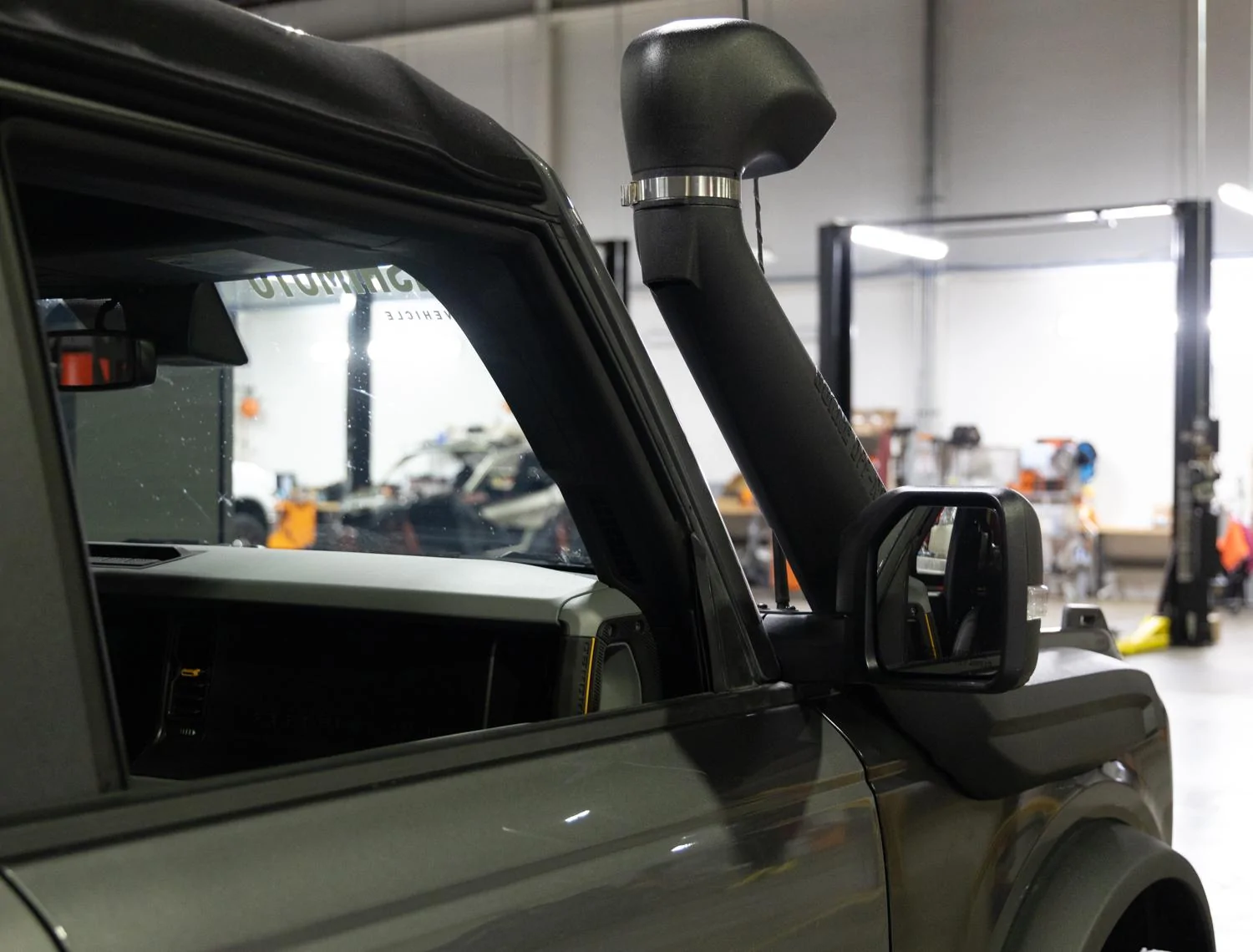

Any pics from drivers side front. How big is the gap between A-Piller and snorkel?

Sure thing!

Love the design. Couple things I notice :
- That gap, I wish there was a way to make the A Pillar and "downtube" come together.
- The air intake grill : WIll there be a way to put a filter in there for dust, like a "pre-filter". The snorkel is especially helpful with dust.
- Sometimes I see the intake reversed, pointing backwards. I dont know why people do that, maybe for dust. This looks like it can pivot.
- Some snorkels have a "hat" - that appears to keep rain out....
* ok thats alot. super curious about this project. looks like thoughtful work!!

Great questions!
I'll also have more info on just these topics coming in the next blog update too, but here's some more info on these specific questions!
- The gap between the A-pillar and the snorkel was left for a reason, which is primarily to reduce flow restriction when only using the snorkel. Adding that much length of tubing to an intake has a negative effect on air flow no matter the circumstances so we wanted to make sure that our design kept things flowing smoothly.
- Yep! The head can be rotated and removed for those extra dusty terrains. We used a standard sized head opening so that you'll still be able to use cyclone separators and pre-filters with our snorkel setup
- I can get some more photos of these but our head does have a sort of asymmetric shape with the top section hanging over slightly. We also incorporated two drain holes on our design as well for any rain that does sneak its way in to the snorkel. The first is right after the first bend, and the other is right before it transitions into the airbox

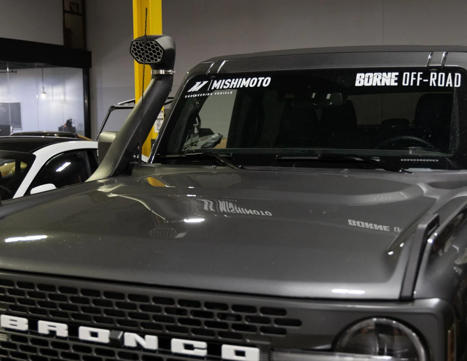

Hey Guys!
Just a quick bump since we've been doing some work on this behind the scenes. WE made some minor adjustments to our design and our latest sample arrived today! We're working on our final test fit and install guide this week. More to come soon!

That gap!!! :oops:
Customers look for two things when purchasing products: performance and styling. Which first depends on the customer and the product.
Given that the Bronco can never be submerged enough to actually require a snorkel (for reasons other than air intake) - I would think styling would take precedence over performance for this application.
That huge gap is certainly not very stylish. It smacks of something somebody made out of PVC pipe from home depot.

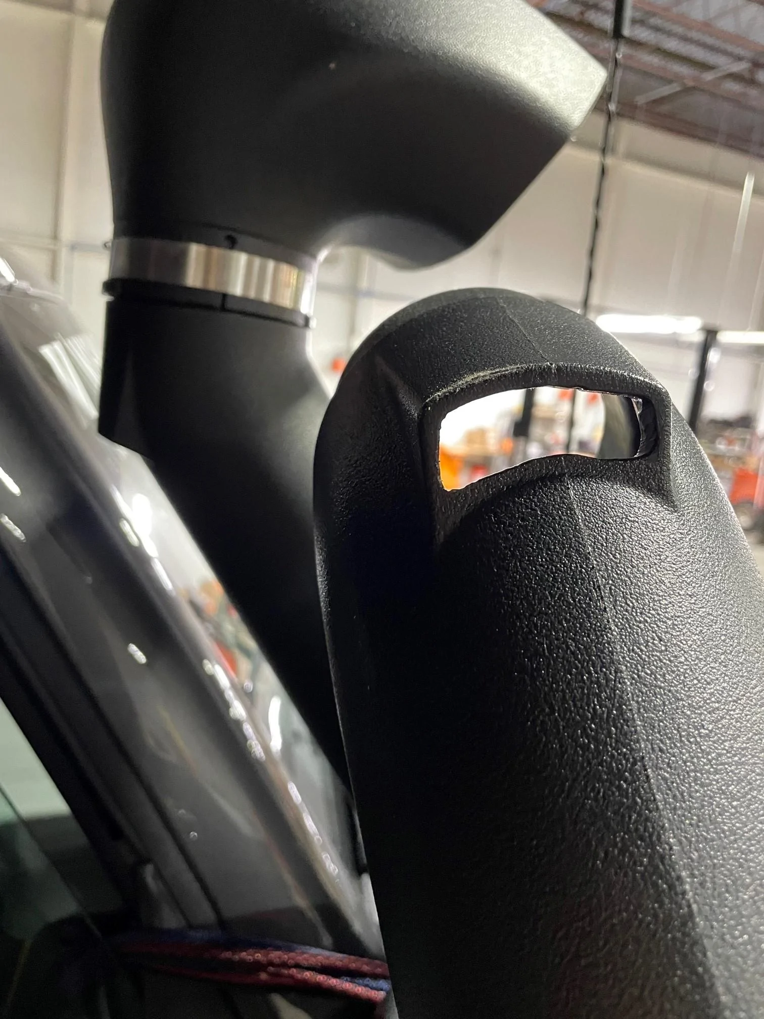

While we are in the process of bringing this product to market, I thought now might be a good time to share some cool features.
Removeable/adjustable head + water drain
Some people prefer to run their head facing backward or prefer different head designs altogether. Our removable/adjustable head allows you to customize it depending on geographic (dusty) or weather (rainy) conditions.
The upper portion of the snorkel tube has a drain so that if you run into a freak rainstorm, the rain will hit the back of the snorkel head and drain out this hole.
Ford Bronco Borne Off-Road Snorkel R&D Bronco Snorkel Water Outlet

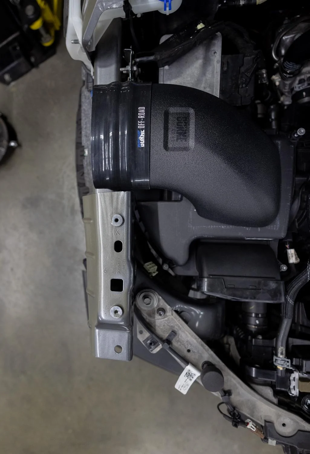

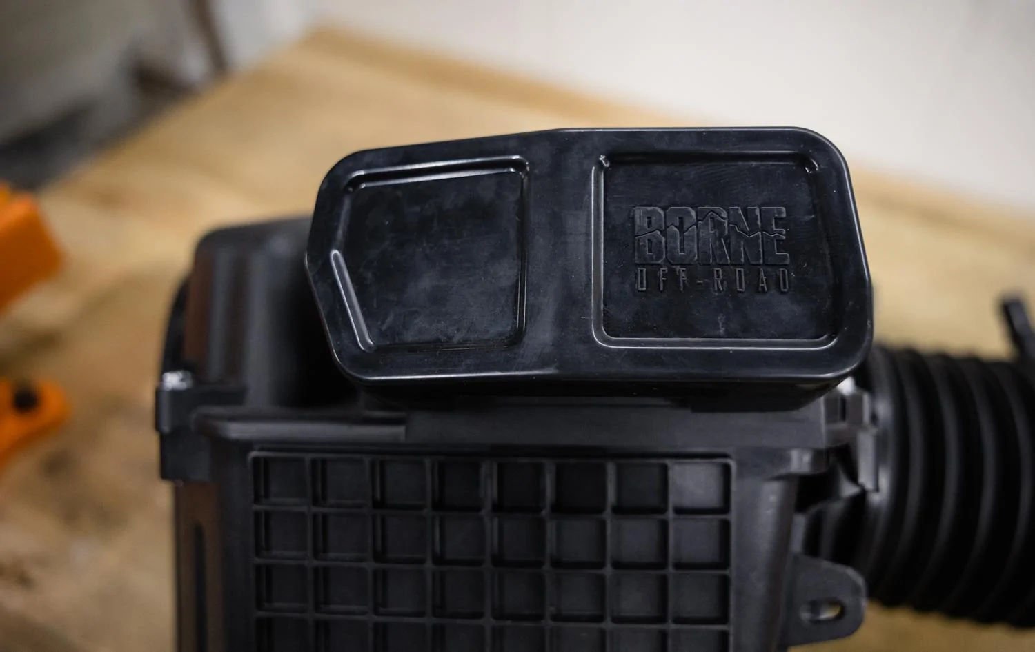

Front airbox inlet cap
Our snorkel includes a cap to seal the front OEM airbox inlet (the inlet which draws air from the front grille). Because our 2.3L and 2.7L intakes utilize the stock inlet (with dust flap), this cap will also work with our intakes.

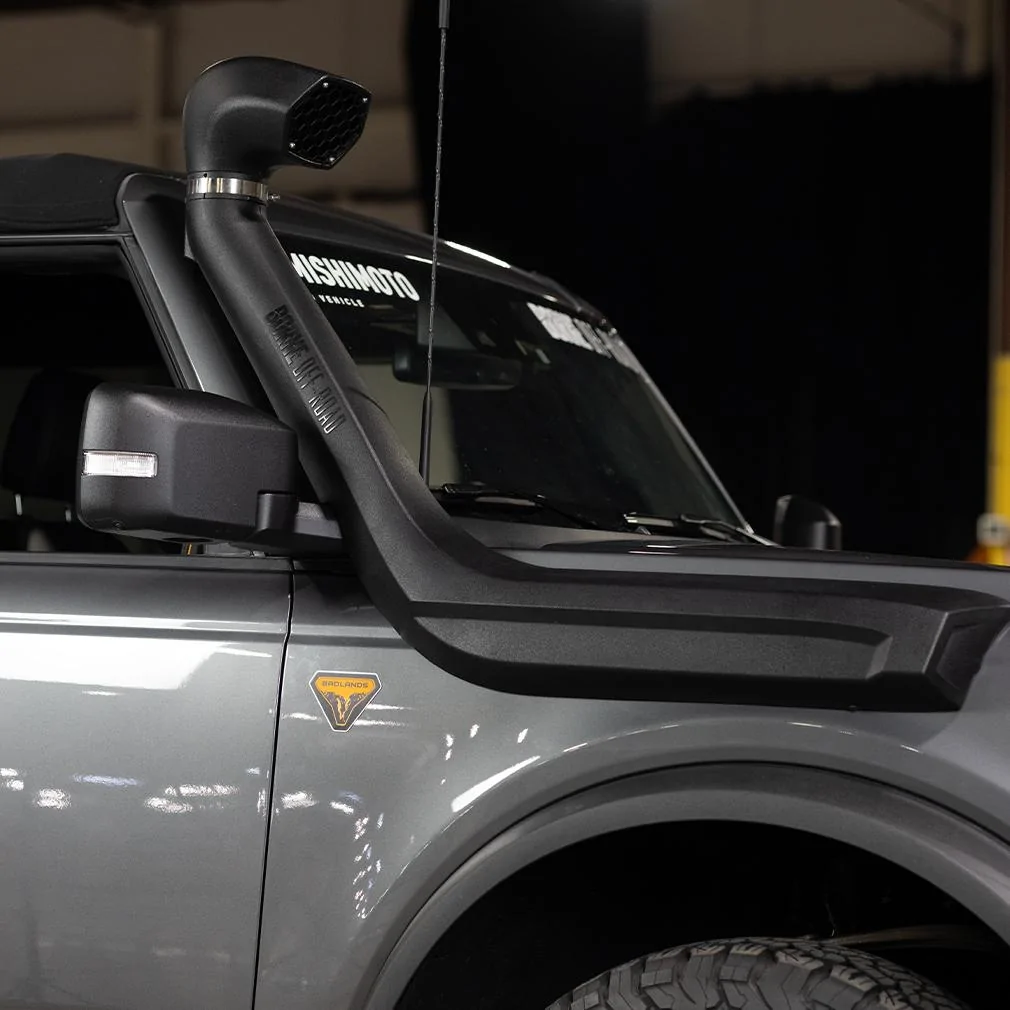

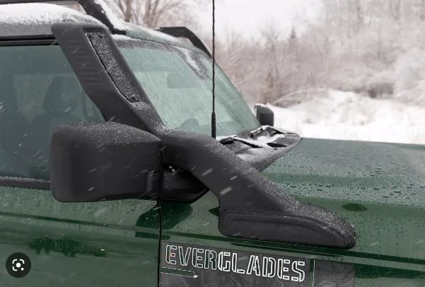

@Mishimoto I appreciate the work you guys are putting into this design. I have to agree with others here, though, that the gap is a deal breaker for me.
I understand the need to minimize bends and flow restrictions, but there has to be a way to get over the mirror mount and hug the A pillar without cutting off the flow. The everglades snorkel accomplishes this. The current gap is not the most appealing and also offers no support to the snorkel when driving through tree branches etc.
For what it's worth, I think you'll lose a significant number of customers by not adjusting your current design!

Hi @BroncoUT - thank you, we appreciate the feedback. We understand that our current design might not be for everyone.

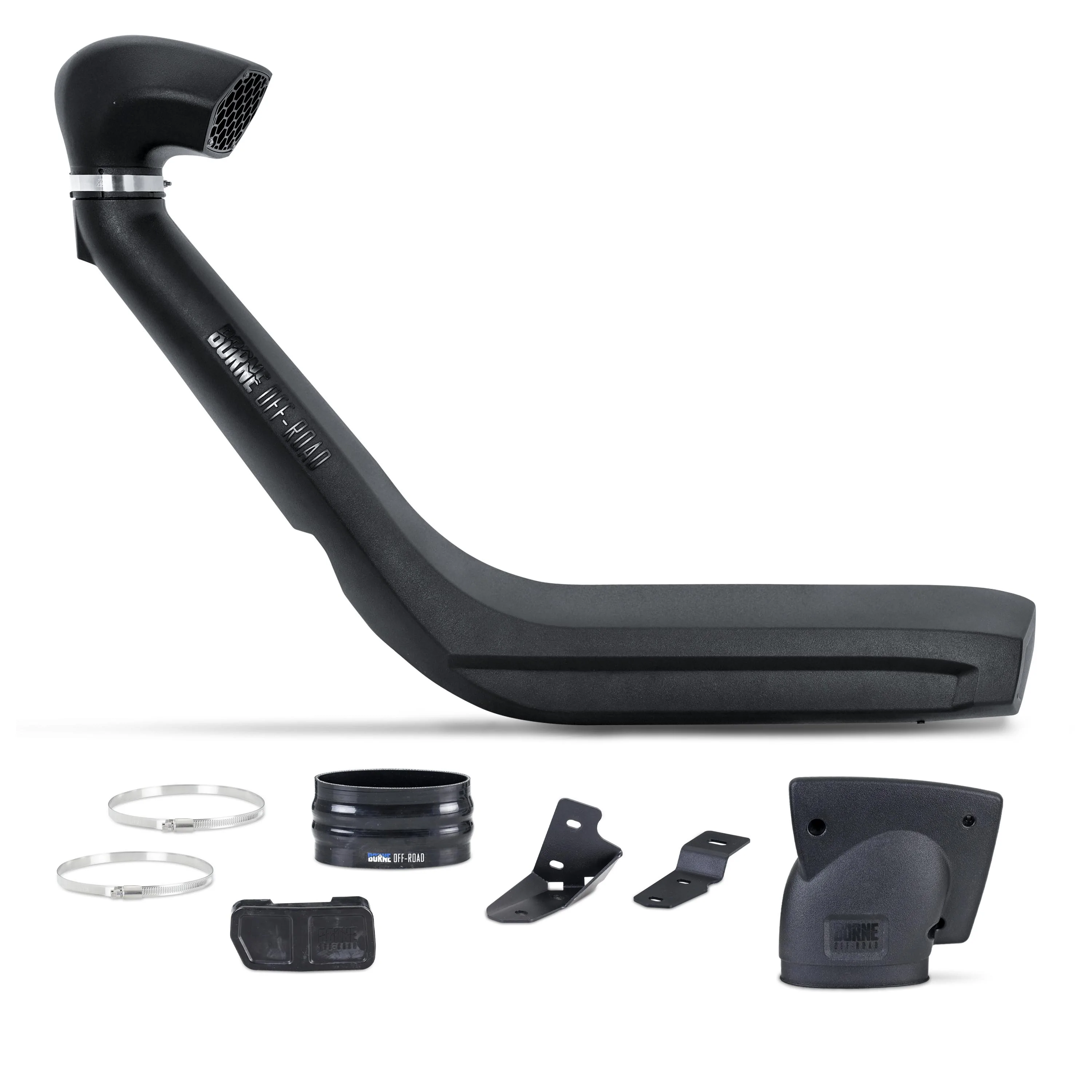

Snorkel pre-sale announcement!!! [link here]
Ford Bronco Borne Off-Road Snorkel R&D MMAI-BR-21N_2

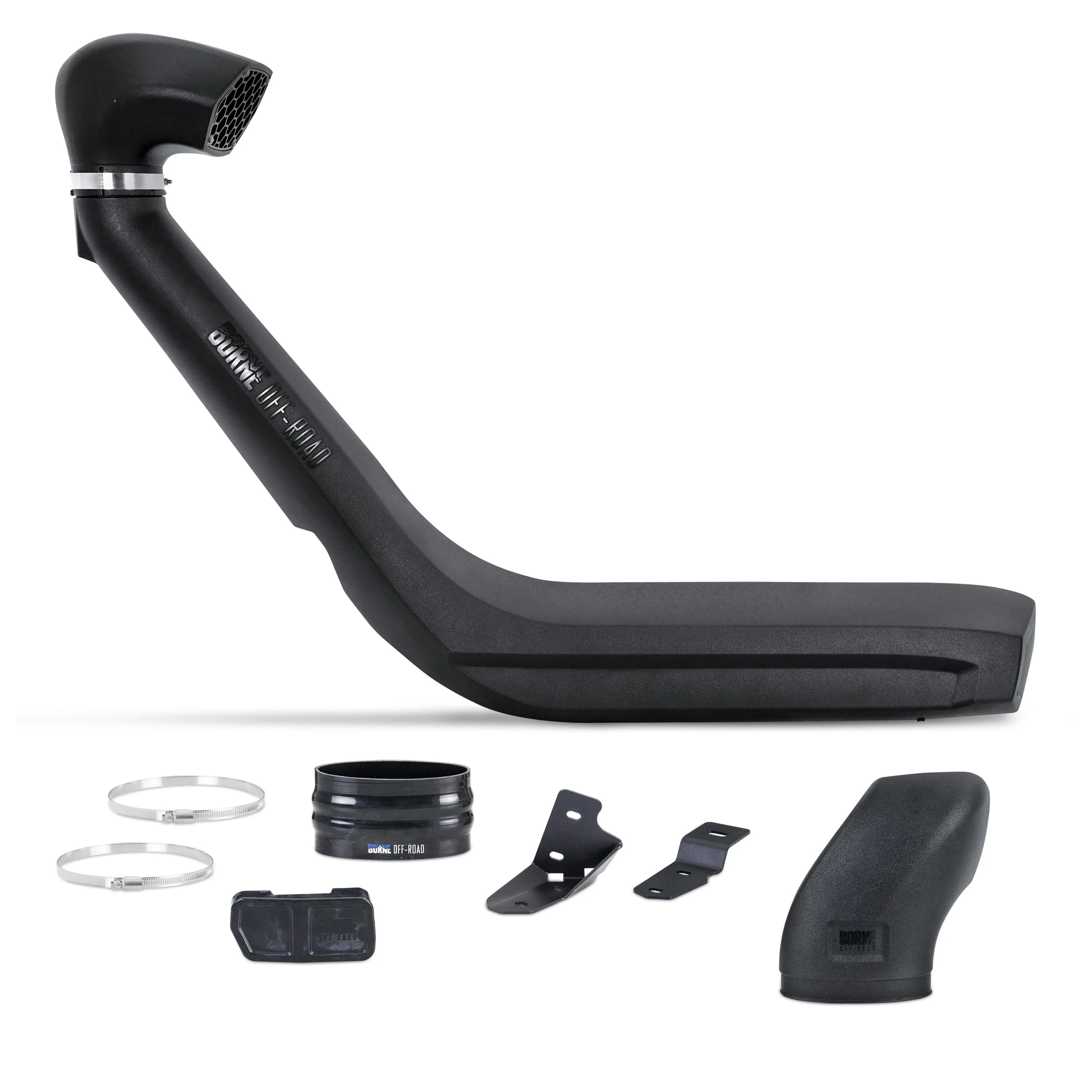

What's with the Snorkel Airbox Adapter?
This is meant to customers who buy our snorkel and then later want to upgrade to one of our intakes.
Ford Bronco Borne Off-Road Snorkel R&D MMAI-BR-21NMM_1
^this is the kit with the airbox adapter designed for the Mishimoto intake, specifically
Ford Bronco Borne Off-Road Snorkel R&D MMAI-BR-21NS_1
^this is the kit with the airbox adapter designed for the stock intake

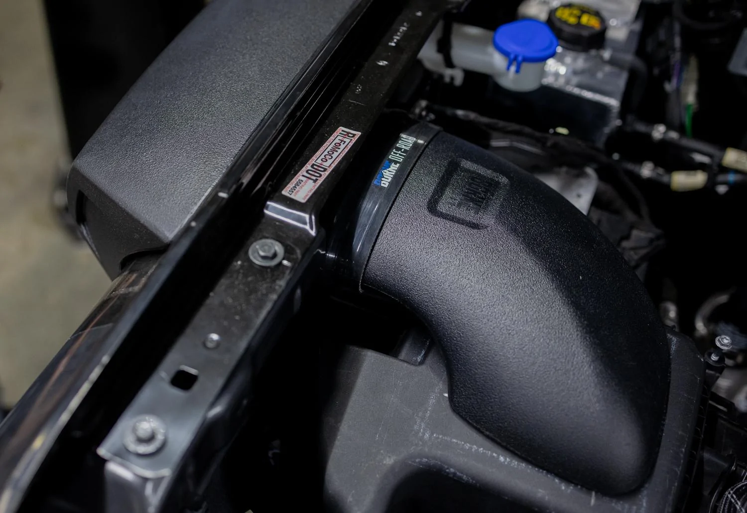

Ford Bronco Borne Off-Road Snorkel R&D NT6_6904
^this image shows how we connect to the stock airbox. It also shows the included plug for the front of the intake inlet (near the grille). Note - disassembled Bronco with no fender.
