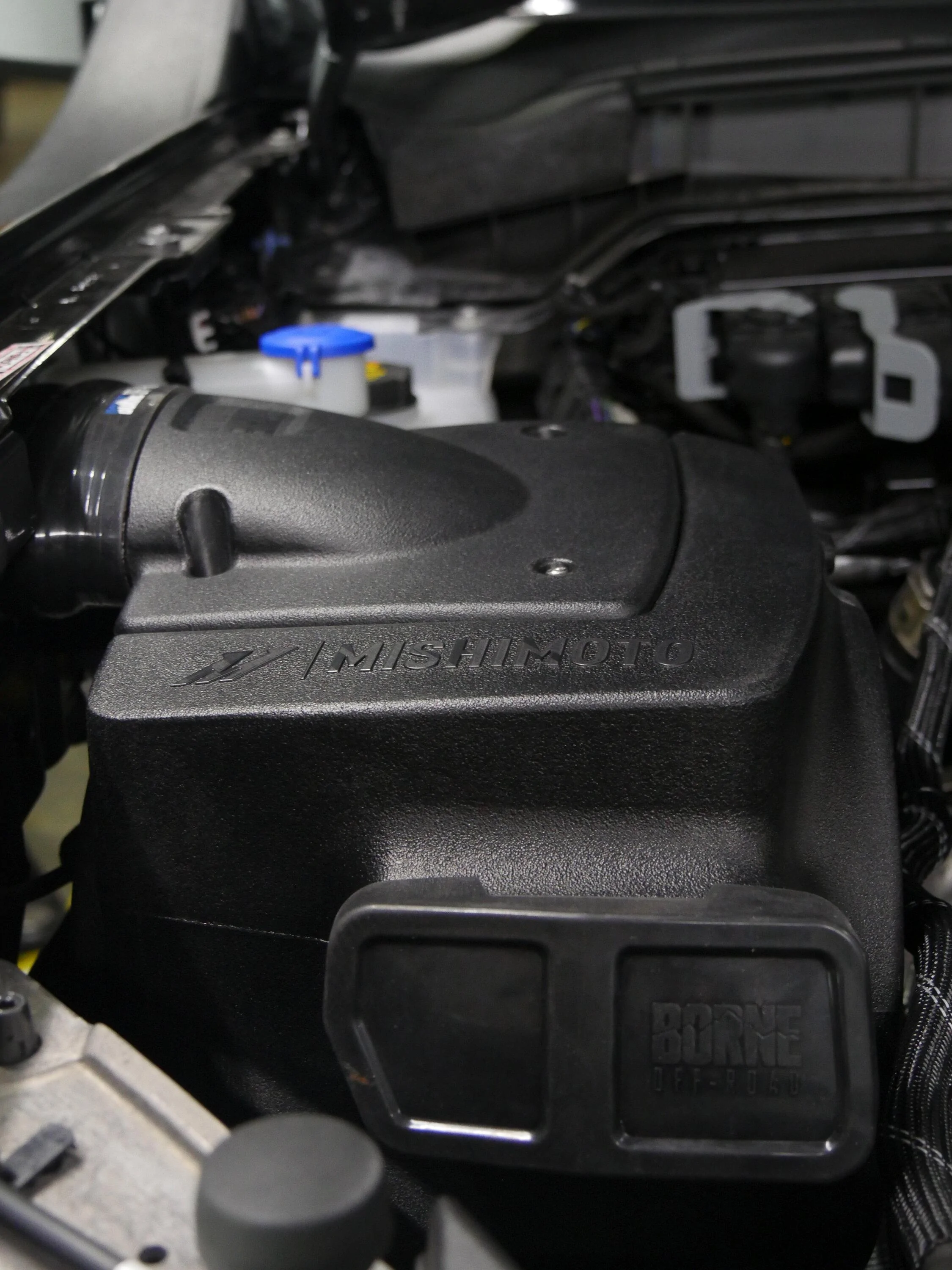

If you already have a Mishimoto intake, we designed the airbox to accommodate the snorkel connection. Seamless! This also shows the included plug for the front inlet portion (which attaches to the front grille area).

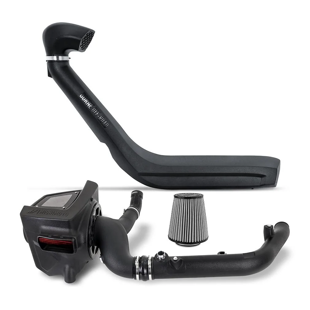

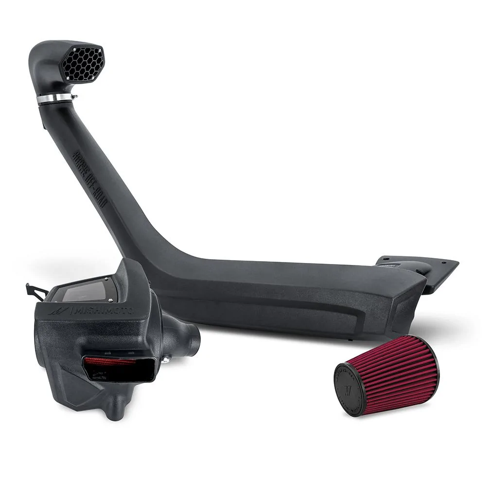

For those of you looking for a comprehensive kit including both the Borne-Off Road Snorkel AND Mishimoto 2.3L or 2.7L intake, both pages are now live for pre-sale! This seamless kit means no drilling a hole in the stock airbox. We designed the intake and snorkel at the same time to ensure they connected flawlessly (see picture above in Post #35).
Ford Bronco Borne Off-Road Snorkel R&D MMB-BR23-21_1
*oiled filter option shown above. You can choose the oiled or dry-washable filter using the Option dropdown!
Ford Bronco Borne Off-Road Snorkel R&D MMB-BR27-21DW_1
*dry-washable filter option shown above. You can choose the oiled or dry-washable filter using the Option dropdown!

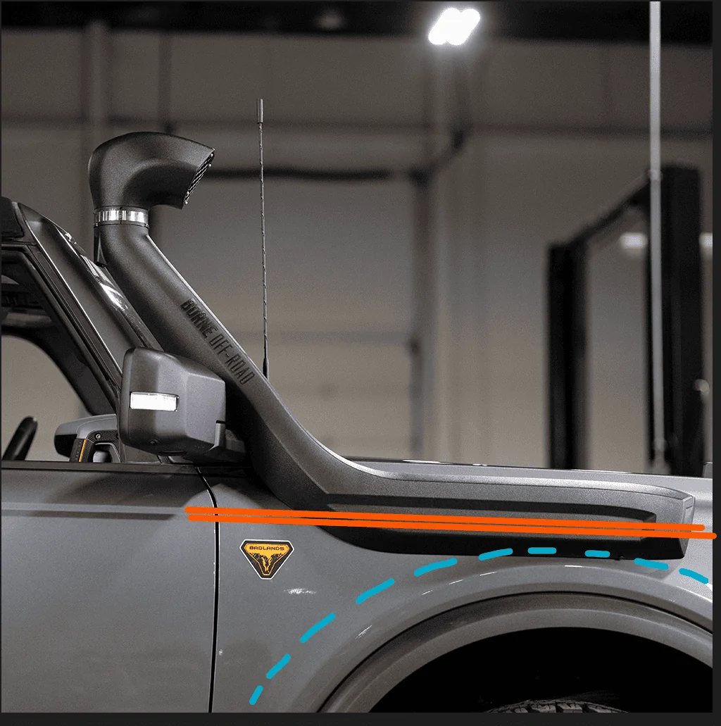

Will this fit using ADV fiberglass fenders?
Hey @Tex - great question! We have not personally test fit on a Bronco running ADV fiberglass fenders, so I cannot say for sure (at this moment in time). I checked the ADV images and as long as the flare does not start flaring before where it does on the OEM fender, I believe you should be good. It appears their design utilizes that same 'groove' which runs down the side of the Bronco, so as long as there is a reasonable distance from that groove to the start of the flare, you will likely be ok.
I hope this image illustrates what I mean. Excuse my amateur paint skills:

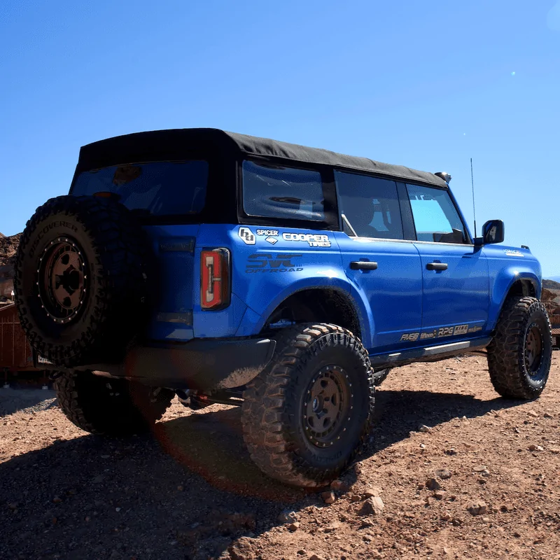

I don't think the snorkel will work with the ADV fenders. I think their flare starts up much higher than the stock fender.

Thanks for the info! I have another question...what kind of plastic is the snorkel made of? Is it able to be re-shaped with a little heat?
Just going off what I can see in pics, if there's a clearance discrepancy, it doesn't appear to be a huge one. The larger flares (+5) might be a different story though. I bet I could take a heat gun and do a little form fitting to the snorkel if necessary. To me, cutting a hole in aftermarket fiberglass and modifying the snorkel is more preferable to cutting a hole in my OEM fenders. I'd rather have my originals sitting in the garage unmodified and use aftermarket fenders to cut up and bash if that makes sense. Plus, a large hole in fiberglass is a lot easier to fill in than aluminum if I change my mind years later.

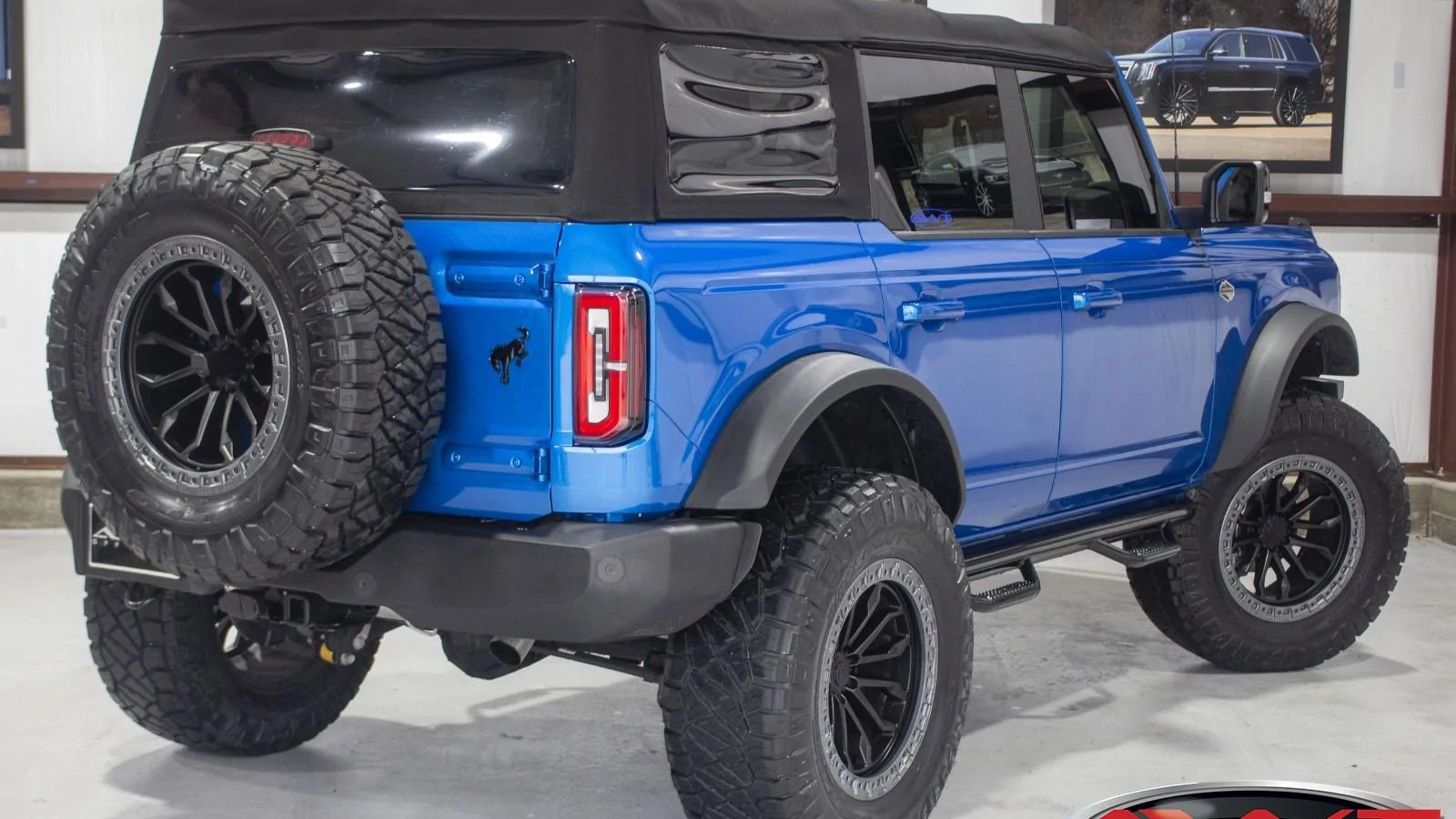

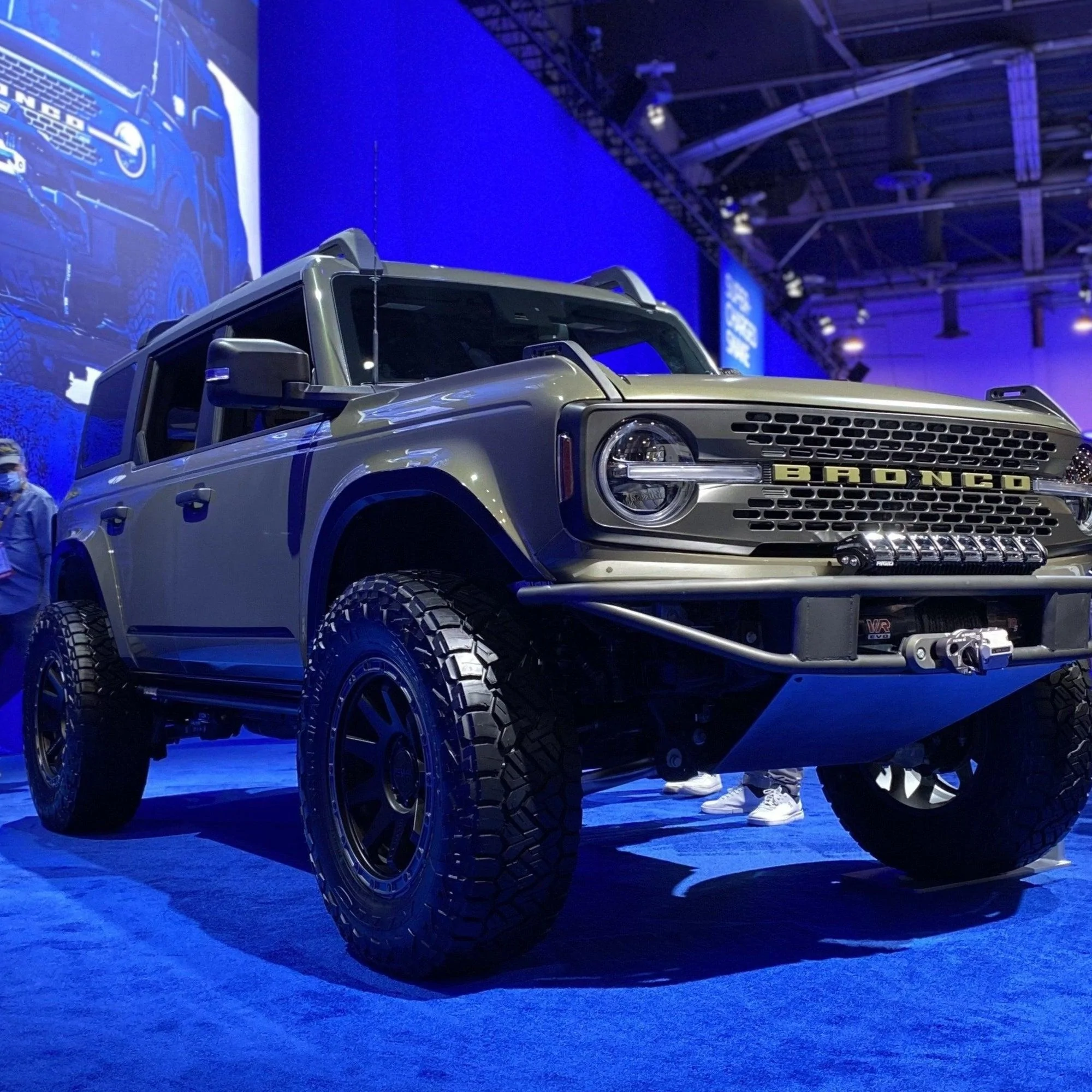

I tried to get a good angle with two identical shots, and this is the closest I could come up with:
Ford Bronco Borne Off-Road Snorkel R&D 39b16909c9758884176afe0137f24713.jpg?v=0.1
Ford Bronco Borne Off-Road Snorkel R&D creenShot2021-11-07at1.04.09PM_800x800_crop_center
It's really deceiving, almost like an optical illusion, because it seems to me that the actual flared portion starts lower with the ADV. The OEM starts higher but the transition is so gradual that it's almost flat and you can't really see it unless you're at the right angle. The ADV has a sharper transition and ends up being further out a little higher up than the OEM, if that makes sense. How that affects clearance I couldn't really say, but I doubt the snorkel would need much to clear it, like maybe .5" of reforming the bottom of the snorkel at most? I wonder if some of that clearance could be made up just in the joints and mounting points :unsure:
