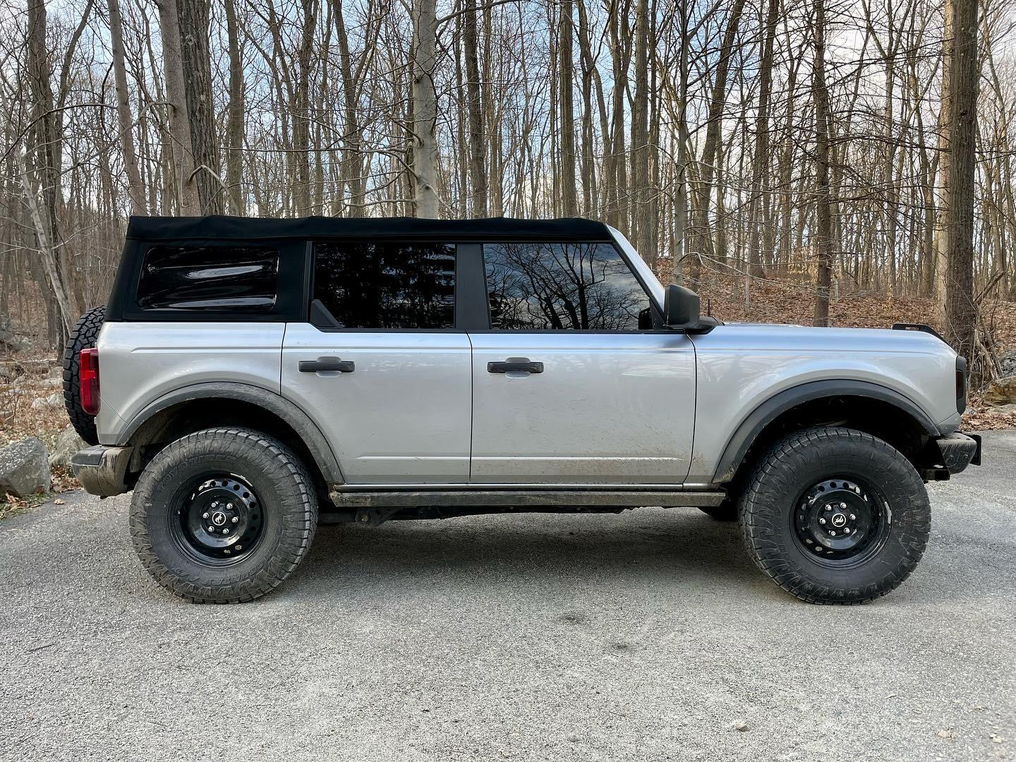

I just swapped in Sasquatch Bilsteins from a 2.7L 4DR Badlands with Auto onto my Black Diamond with Manual and alleviated the rake. Gained 1.1” from the suspension and 1.5” from the tires (Toyo AT3 285/75R17 on stock 17” steelies). Super excited about how it turned out. Did a quick few laps on a muddy backroad, some uneven and windy roads. Much better handling than the Hitachis.
Would love to see more pics from other angles!

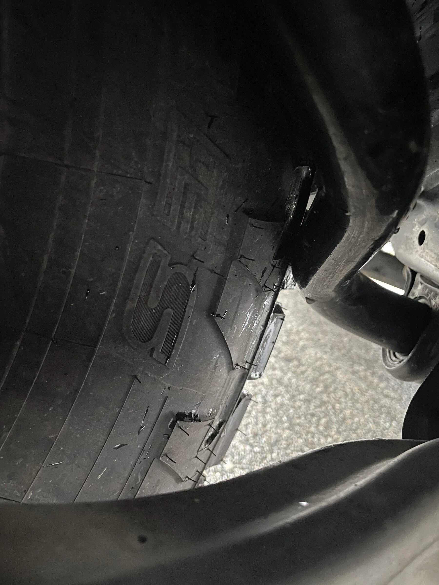

Well, final stance may be in flux. Hate to be the barer of bad news. Went to go reinstall my skid plates this morning and when making a sharp turn on a somewhat down hill driveway into my garage - I heard the dreadful rub. Turns out - 285/75 on steelies are going to need some spacers…at full tilt, they’re hitting the swaybar. Ugh.
Ok, now I'm really confused. If you use either the badlands or sasquatch takeoffs (like you did), there should be plenty of room right? I guess the slightly taller sidewall of the tires vs badlands 33s is causing it?
I think it’s the 11.5” wide that’s the issue. Others have done the 35x10.5 Kenda Klever w/o issue. So, without offset on the steelies…I need an inch tops…

I’m gonna take it back to the alignment shop.
I’m not apt to use spacers. I’m thinking it’s something else going on. I can’t recreate it on the driver side. I’ve tried hard turns up and down hill and it’s only downhill steering right on passenger side downhill.
