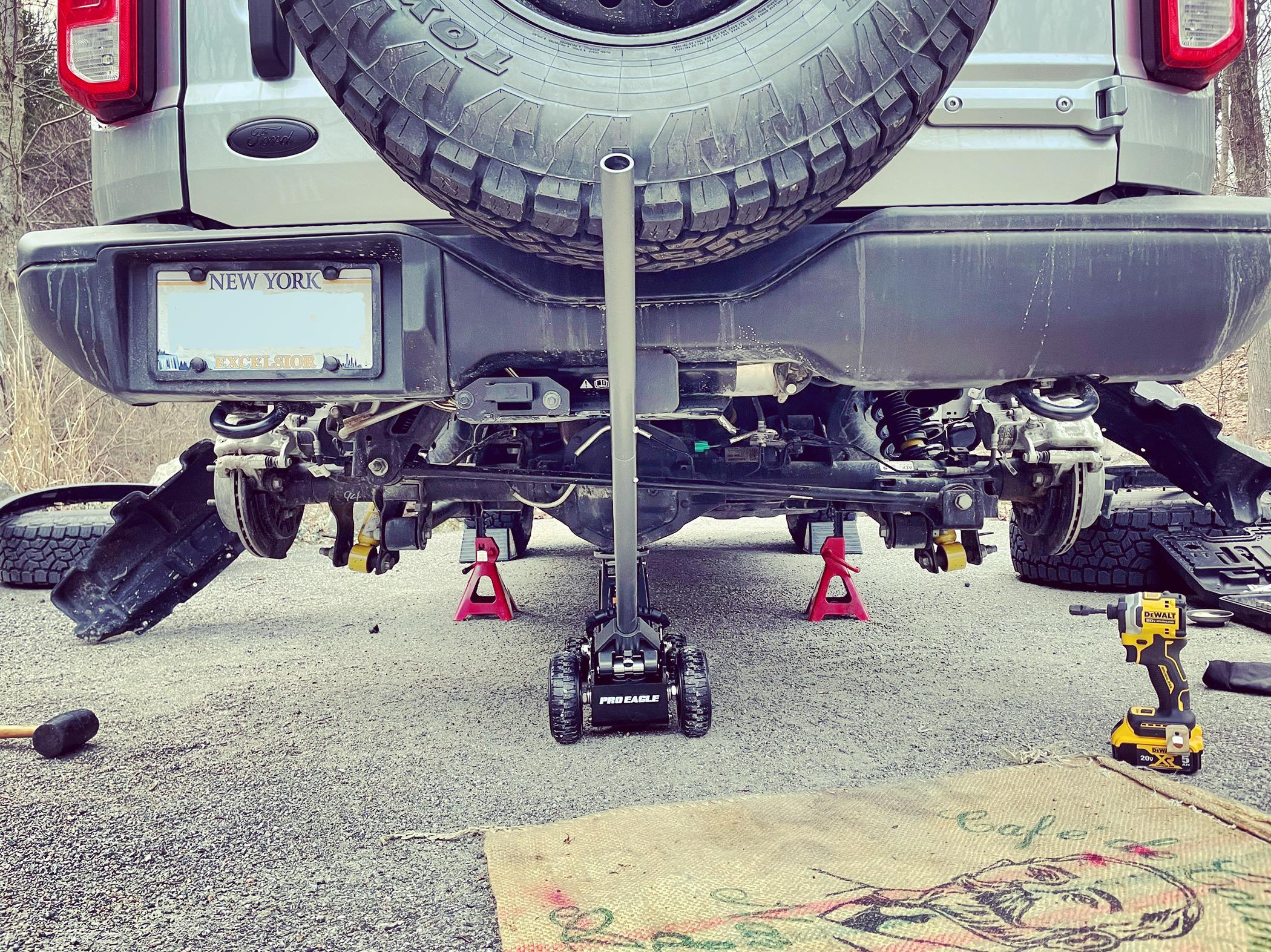

BL suspension installed on OBX. Pure plug and play. Just have it aligned afterwards.
Edit- I did a complete stack for stack replacement. I didn’t break down the OBX shocks for tophats or bump stops. BL stack was 100% factory new, complete set for a BL twin of mine- 2.7, 4dr, tow.

Not sure yet! Only the rears are in as of this evening. Fronts getting tackled tomorrow.
I have a perfect section of trail I’m going to return to to test the difference.

I just swapped in Sasquatch Bilsteins from a 2.7L 4DR Badlands with Auto onto my Black Diamond with Manual and alleviated the rake. Gained 1.1” from the suspension and 1.5” from the tires (Toyo AT3 285/75R17 on stock 17” steelies). Super excited about how it turned out. Did a quick few laps on a muddy backroad, some uneven and windy roads. Much better handling than the Hitachis.
Thanks for sharing. Did you do the work yourself?
