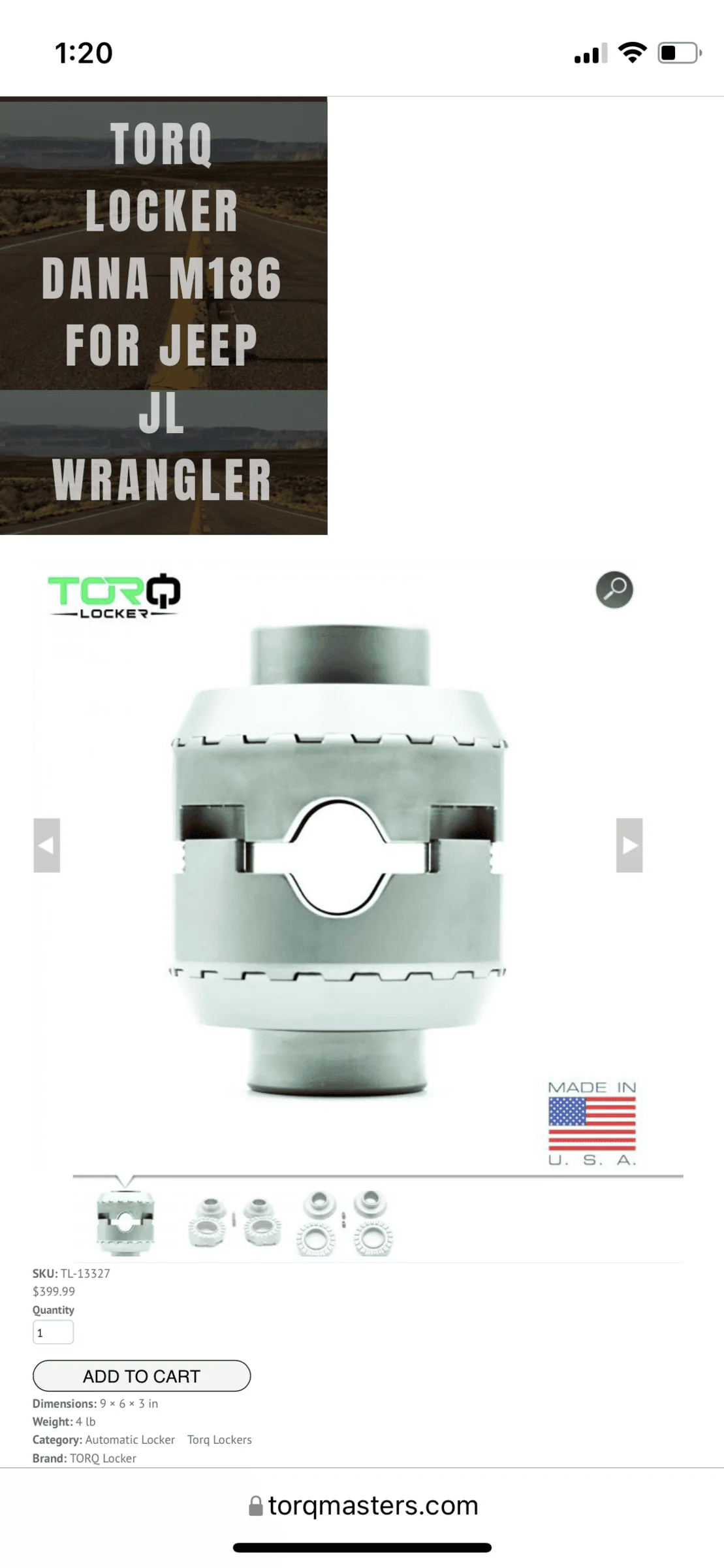

@Jack D Who makes an LSD for non-Rubi Jeep JL front differential ???
Whoever does would be the ones to ask when they’ll have an LSD for the AdvanTek.
Torq makes a d30 front ratcheting locker. It’s been out for about 2 or 3 years now
Is that for the actual Dana 30, or for the Advantec M186/190 that is often called a Dana 30? Ratcheting lockers are kind of horrible for street use.

Good question
I ask because just like with the rears, people are conflating the names of these axle models. Jeep still says Dana 30, 44, etc. But these new axles are not interchangeable with the earlier ones. The M190 / Dana 30 are a lot more similar to each other than the 44 /M220 though. But still have different splines, bearings and ring gear bolts. And welded ring gears on the Ford M190.
