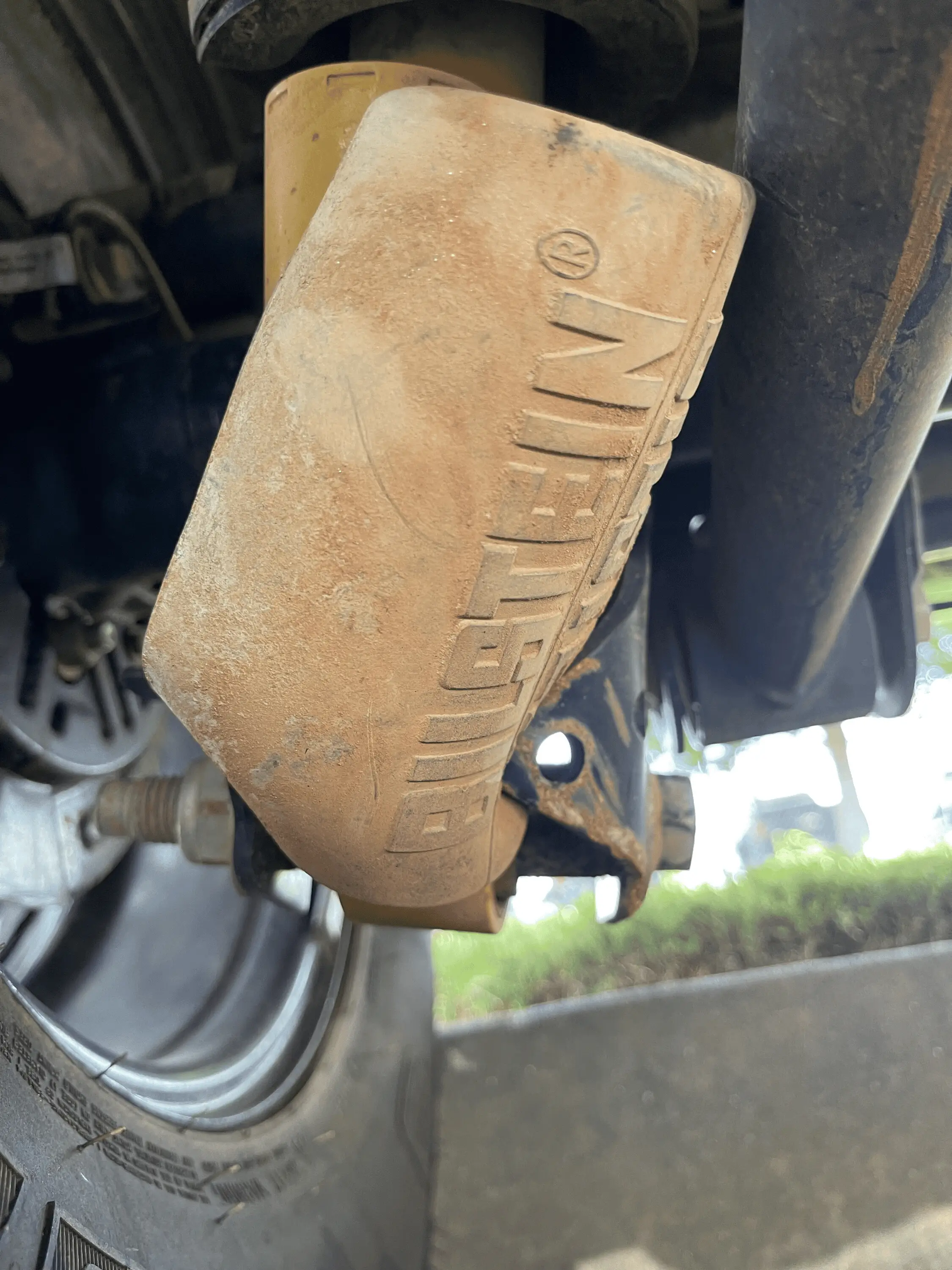

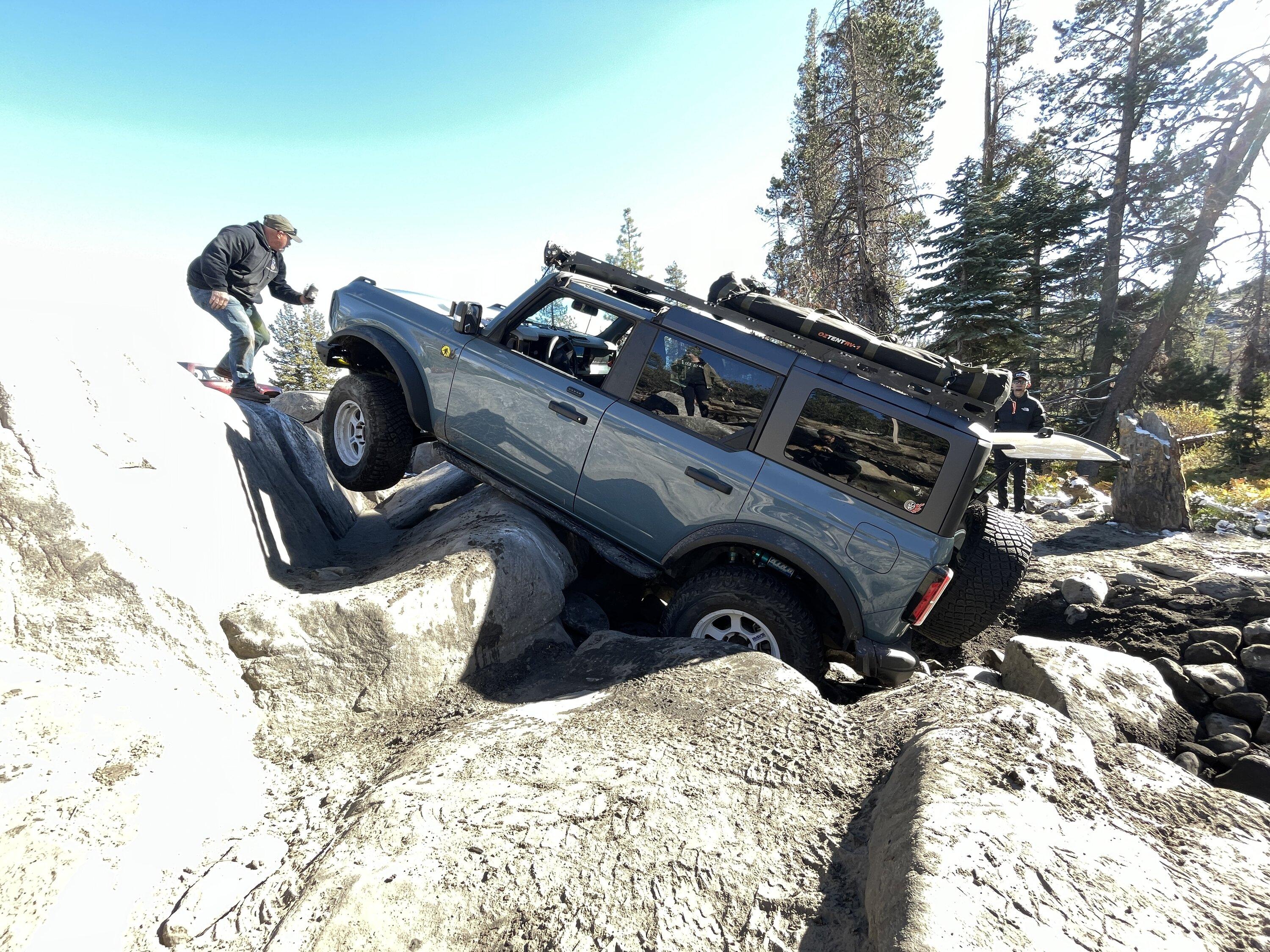

Here's some pics from the weekend where it all went down at the Soup Bowl at good ol' Rubicon :(

I bent both of mine one side way worse than the other. You'll need to remove the shock to get access to bend the mount. Find a very large adjustable wrench because you'll need the leverage and the ability to fine tune where you want the bend. Apply a fair mount of heat (torch) so that you'll be able to bend it. Have an extra pry bar or anything for wedging to keep from bending the mount too far out. Use a bolt that is the slightly wider than the shock mount and wedge it in between to help you bend the mount if you pulled it out too far. Get some paint to spray the mounts after you are done because you'll probably gouge the mount a few times.
My mans! Is that a shock or a banana🤣?
Holy cow, how did you do that?
Thanks for your advice on how to bend it back. I've decided to hold off on hammering and wait till the reinforced replacement mounts from Barnes come in.

He has a skid on there and, apparently, it did not help with whatever situation he put his Bronco in. Generally, the skids will work for regular wheeling.
you mean mall crawlin?

Props on hitting that, I haven't seen another 6G try to hit that.
looks to me like 5g had a wheelbase advantage...Rubicon driven more-door = damage, who woulda guessed?
The damage had nothing to do with the wheel base. The driver was just a little unseasoned but at least was trying. 4 doors actually do great on the Rubicon.

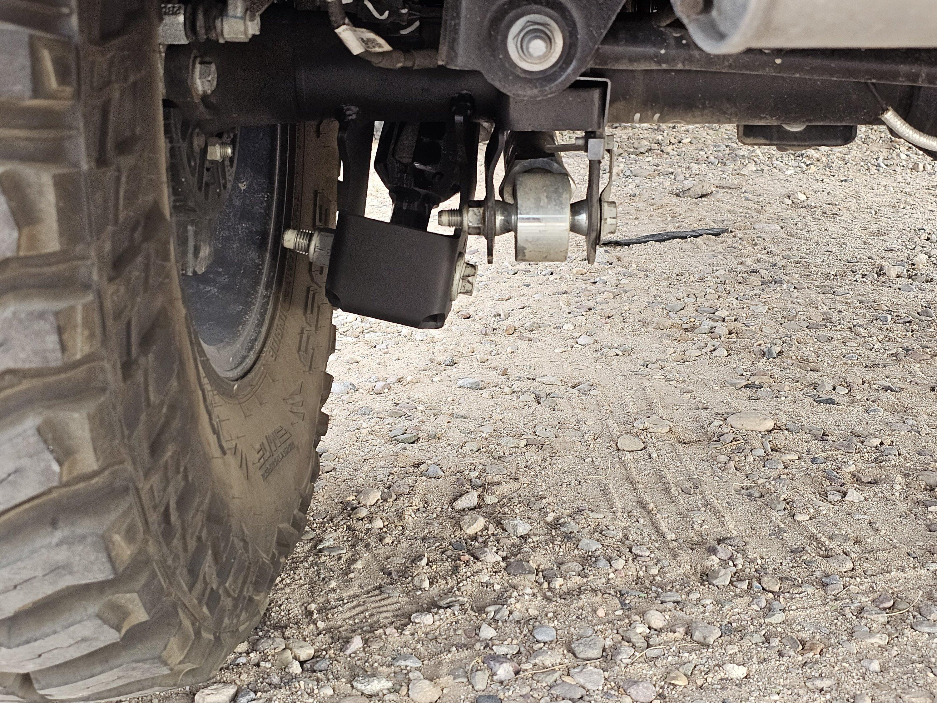

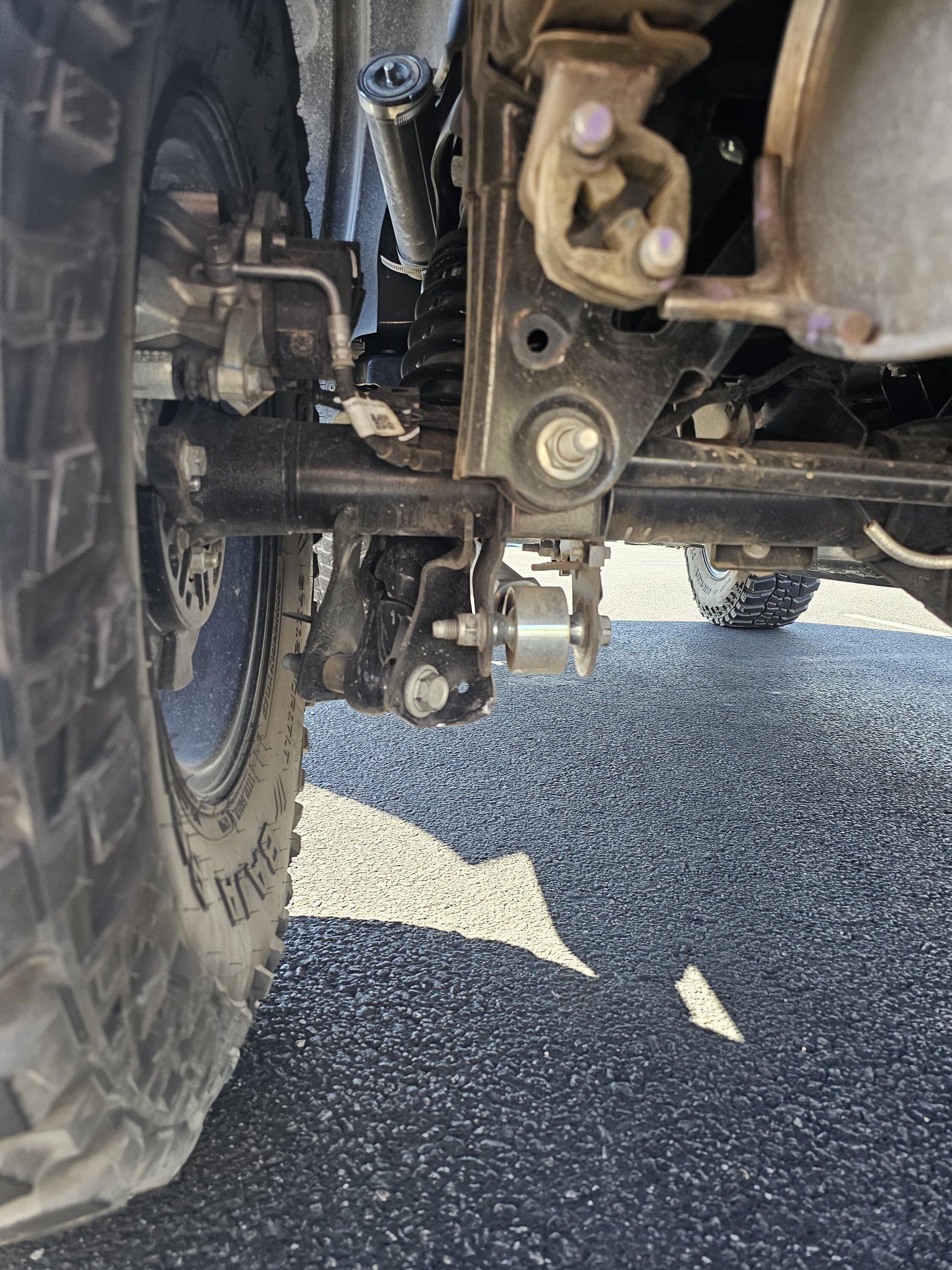

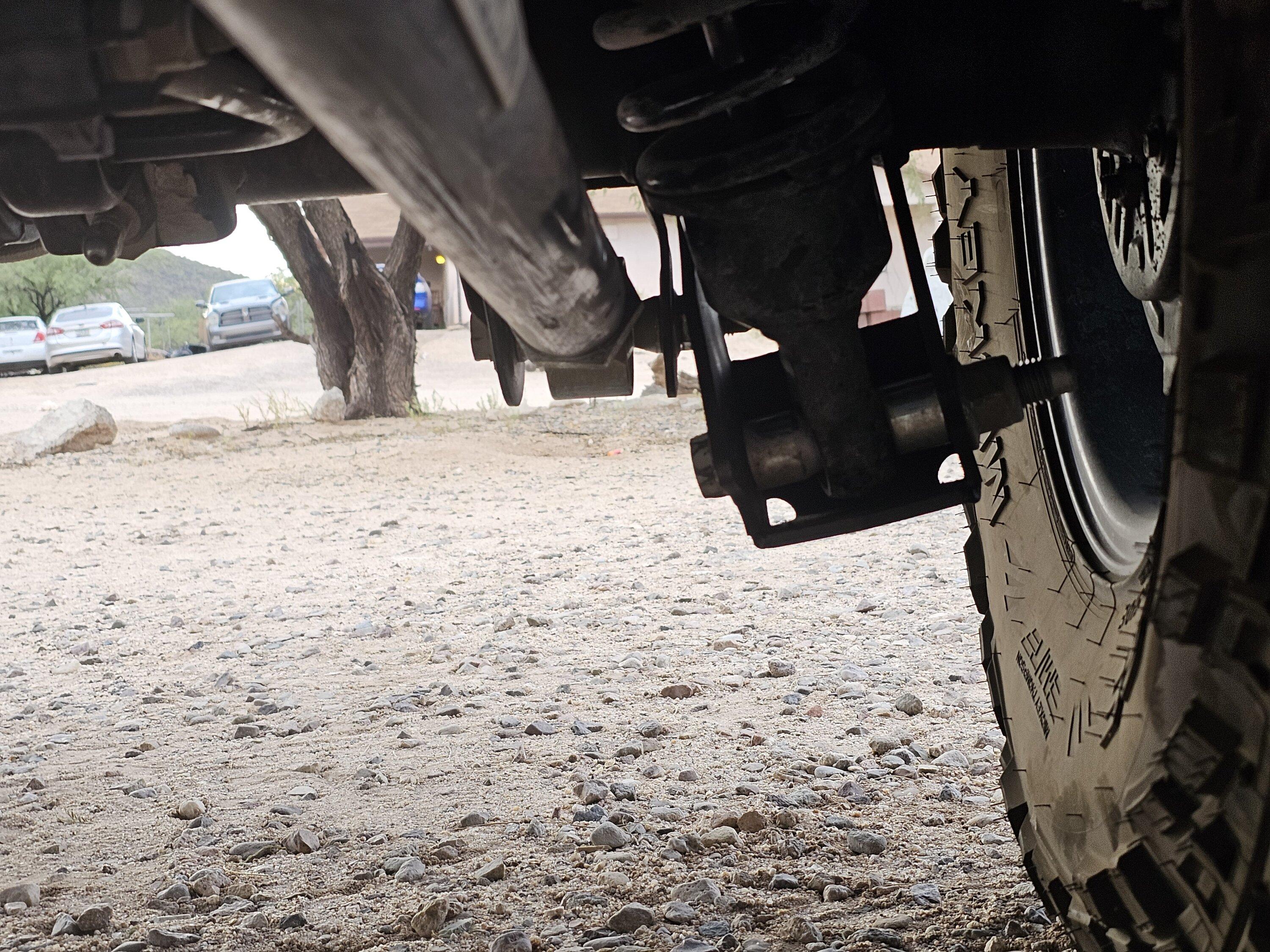

I bought some new mounts from Barnes 4WD. They are boxed on the bottom so they should be stronger and are a thicker steel than OEM. Even if you raise the mounting point they are still a weak point.

I think the winning combination would be to do boxed 1/4" like the Barnes but shorten them up a little bit to alleviate the leverage but still maintain a full size shock.

Most definitely need to be shortened. This will drastically reduce bending stresses and add some lift. Even 1-2” will make a big difference.

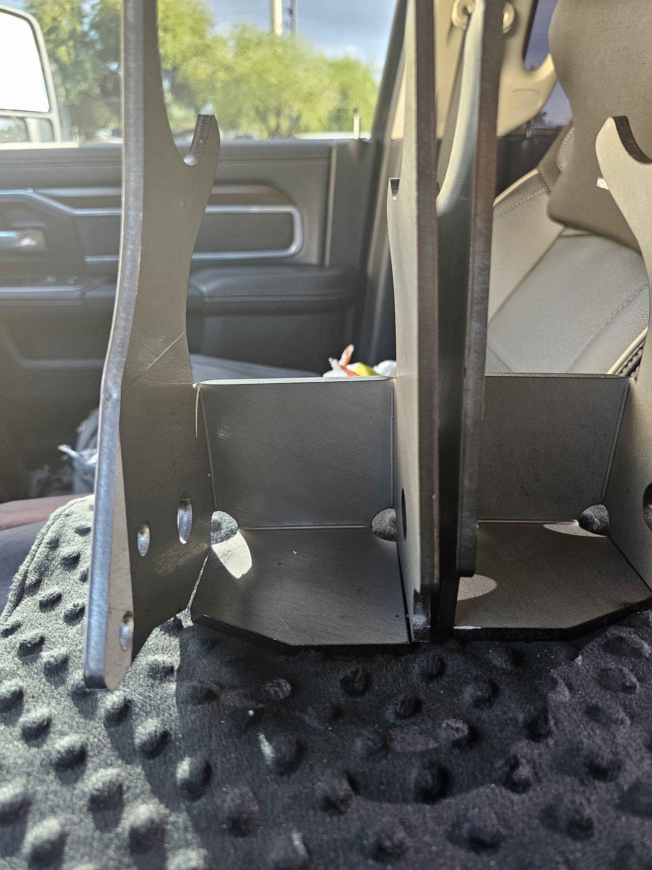

Had mine installed today.
