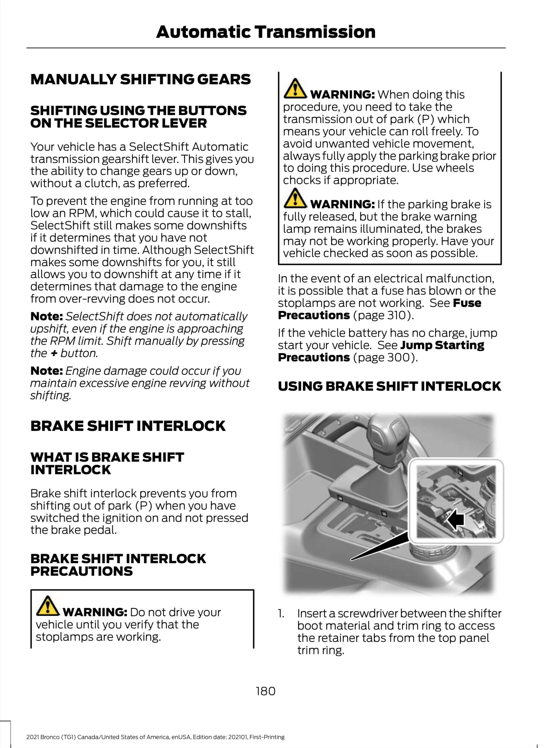

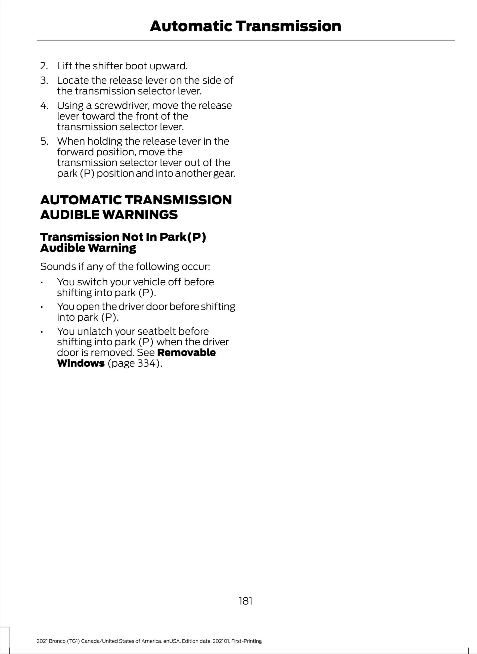

Well folks ,against my better judgement I decided to die the warranty route. I removed the battery and called the local Ford dealership. I just wanted a new battery but they insisted that the vehicle had to be brought in. They arranged the tow thru Ford roadside service. I must admit I am very apprehensive that they will get the vehicle and tell me since I removed the battery that it voids warranty and they will fix it for a price. I was told that even though without a battery I can't get it out of park that it can be safely towed, I'm not so sure. I honestly believe that is what's going to happen. I'm seriously considering cancelling the service and continue to do it myself. I know I'm just venting,but WTF over.

There is a procedure in the Owner's Manual for manually releasing the Brake Shift Interlock. It's detailed here.
For those who don’t want to dig through the links, it’s covered in the Owners Manual on the following pages…
Horse
Robert
Jan 30, 2022
52
Alabama
2021 badlands non sas
Thanks I thought their must be a procedure I was focused on the electrical side
