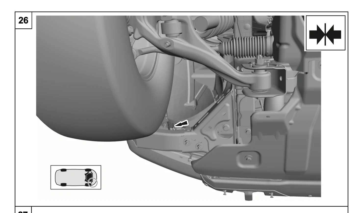

also...anyone know what this step of the instructions actually means??

Looks like a fog light or sensor connector?
It might be saying to remove the crash bars? I think that's what that looks like, but they would only be present if you don't have a sasquatch.
No idea honestly. It’s pointing near the crash bar - I don’t recall a wiring harness or anything that goes there. You don’t have to remove the crash bar for the bumper. Maybe something with a fender liner bumper clip or something.
nothing critical at any rate … it’s a whopping 6 bolts that matter - everything else is non-critical.

likley the fog light connector. When I put my aftermarket bumper on, for the recovery hooks, I removed mine and took a cut off wheel to remove them, shot of paint, and reinstalled. I also helped my buddy go from base bumper to mod using the ford kit. It's quite easy. you'll spend more time reading the instructions on how to assembly the mod bumper than anything else.
