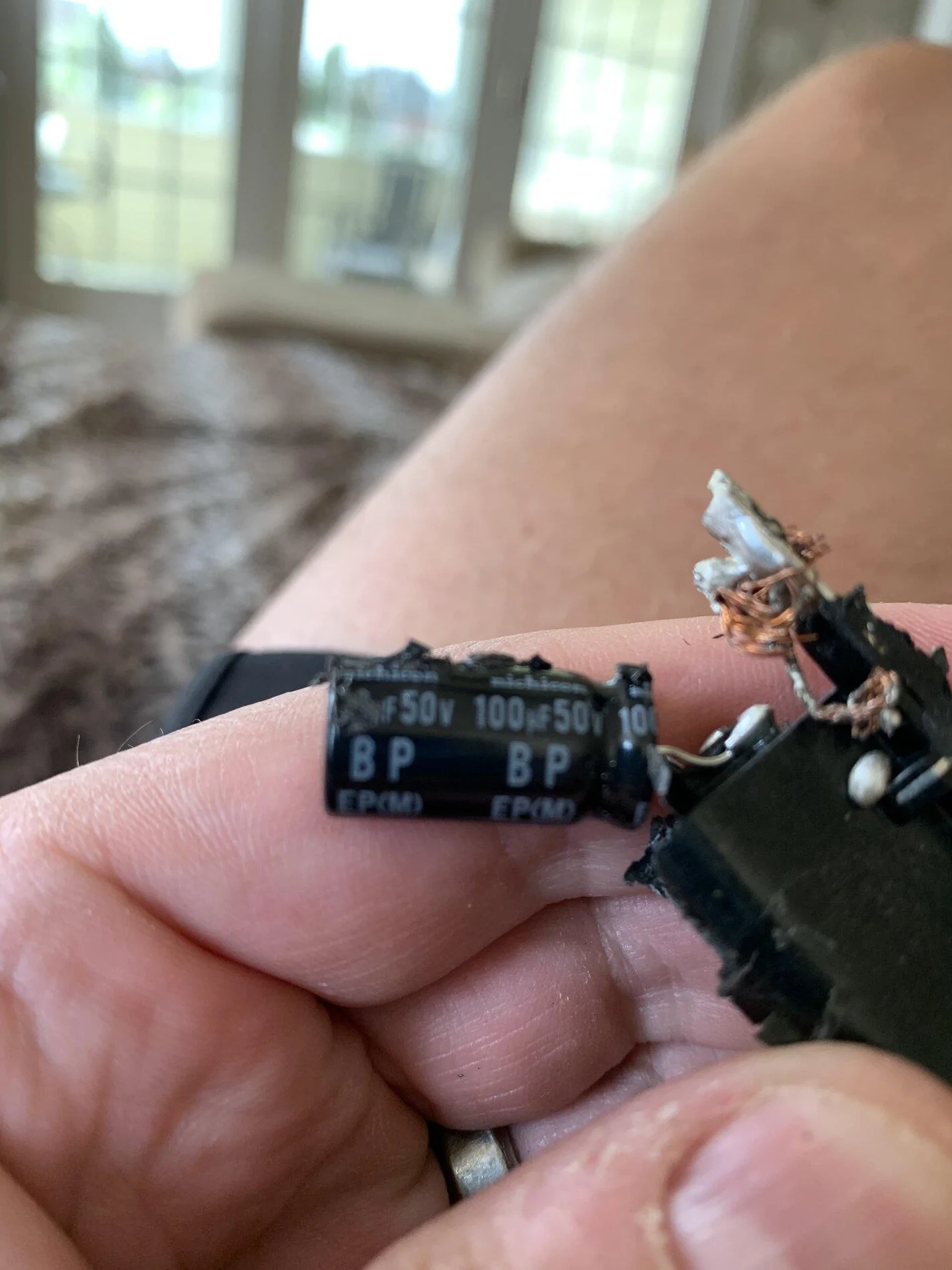

It says 100uf50v does that help? I don’t understand circuitry very well. Also says 105 c H2035 on the other side
Ignore my horrible soldering job. Found out the hard way that old solder loses its flux. Went to thinner, newer solder and my job looked great. I think the solder I had was my grandfathers.

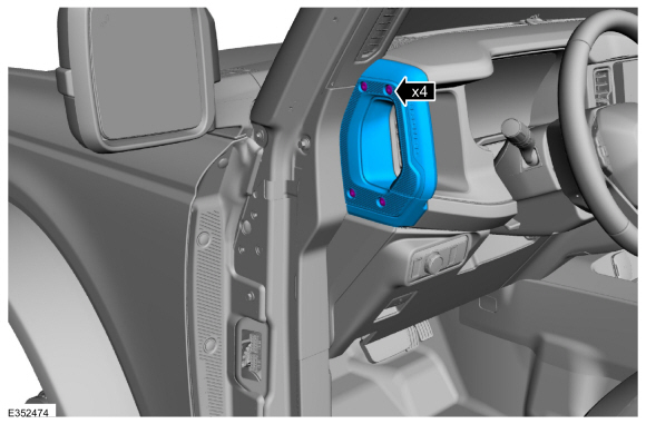

  1. Remove the screws and the instrument panel grab handle.
    Torque: 80 lb.in (9 Nm)

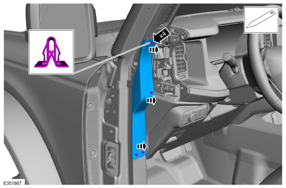

  1. Release the clips and remove the cowl side trim panel.

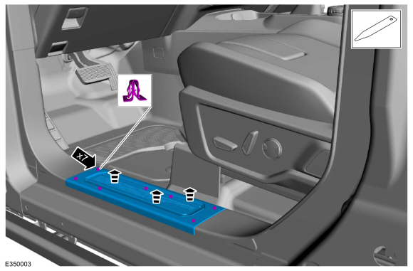

    Release the clips and remove the front scuff plate trim panel.

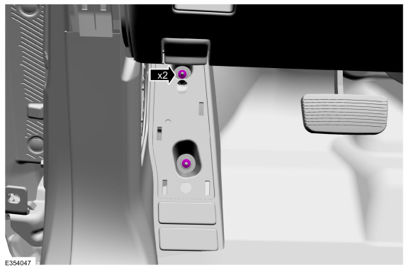

  1. Remove the driver foot rest nuts.
    Torque: 28 lb.in (3.2 Nm)

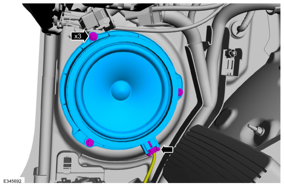

  1. Disconnect the electrical connector, remove the screws and the A-pillar speaker.
    Torque: 19 lb.in (2.2 Nm)
Ford Bronco Base Sound System Upgrade/Build Hel
Ford Bronco Base Sound System Upgrade/Build video
Ford Bronco {thread} {filename}
Yes perfect... 100uF at 4ohms is right around 400hz with a 6db rolloff. That seems about right... I will likely go down to 250hz (150uF capacitor)and might even experiment with 150hz (250uF capacitor) to see if the upgraded 4" woofers can handle a little more bass. But I'm still a long ways out... :(
This is much better than Jeep did... They had the tweeters crossed at above 12,000hz which has very little music up there. I brought them down to 6000hz and the system transformed. And now 6 years later, I'm unaware of a single tweeter failure due to the crossover point change.

Thanks Rod. Crutchfield has such great customer service. When I explained that my speakers sound distorted as they get louder they offered to send me some “bass buster” and insisted on providing them for free. But I think they are sending me 600hz, I’m thinking maybe I start with 300hz, if you are going down to 250. Any thoughts? 600 too much for the Infinity’s?

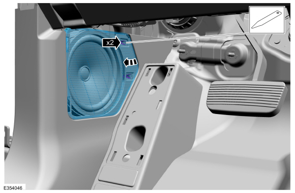

I can tomorrow. Most of the rocker trim just pulls off and held in by clips. Best to have a trim panel removal tool to minimize breaking a tab. We removed the back panels to install trailer wiring and still damaged a few and that was using several different tools. Just the way it is. They design them for ease of assembly at the factory, ease of removal is mostly an after thought.
Removal
NOTE:
Removal steps in this procedure may contain installation details.
All vehicles
NOTE:
Left hand (LH) shown, right hand (RH) similar.
    Use the General Equipment: Interior Trim Remover

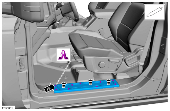

  1. On 5-door vehicles.

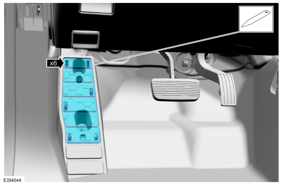

Left hand lower cowl side panel panel
  1. Release the clips and remove the driver foot rest trim panel.

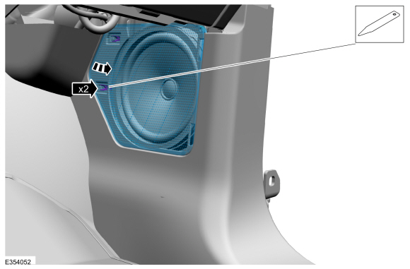

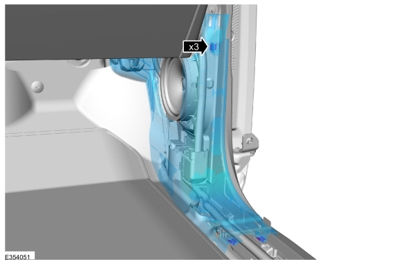

  1. Release the clips and remove the LH A-pillar speaker grille.
  1. Release the clips and remove the LH lower cowl side panel panel.
