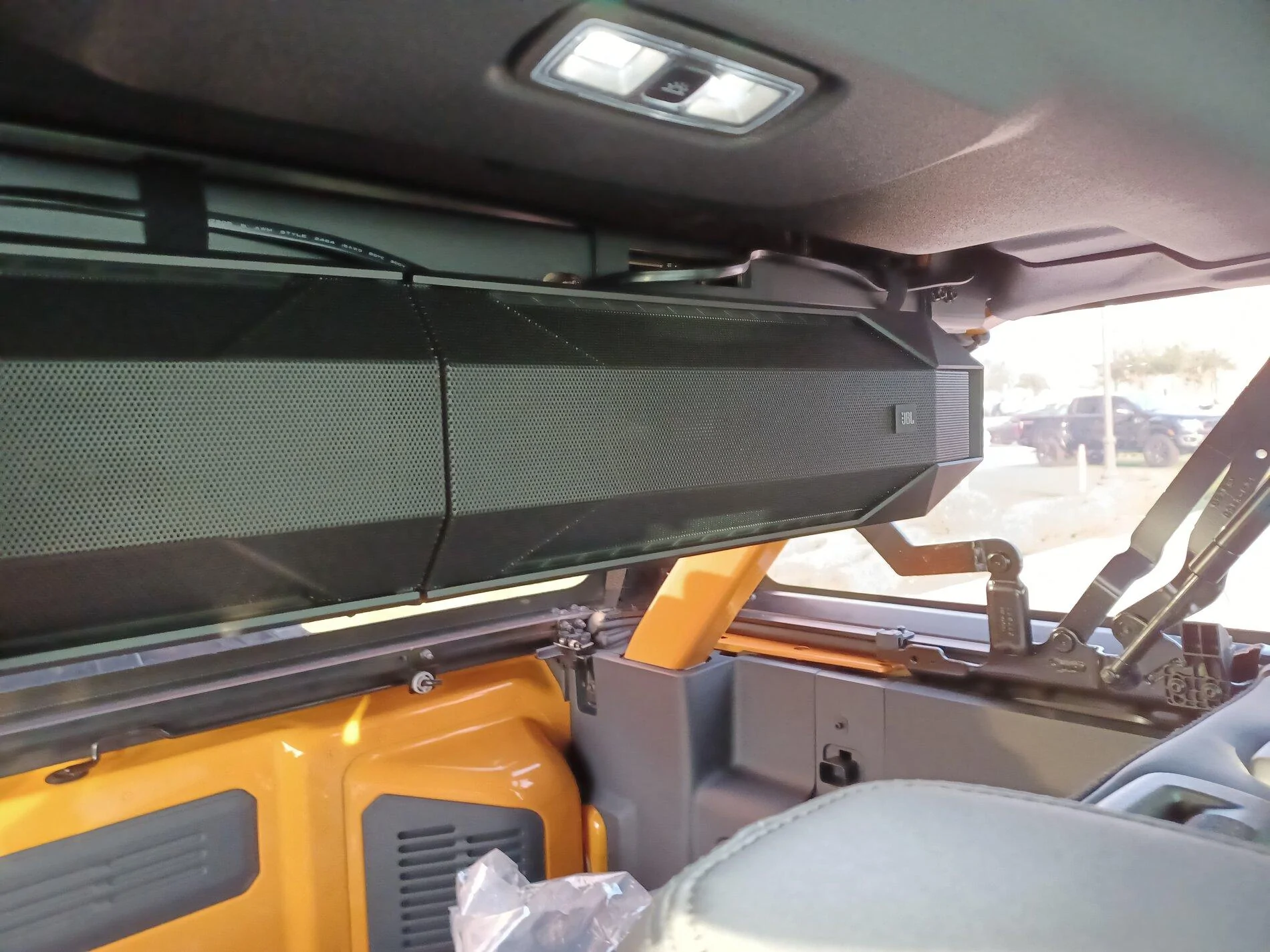

I went back and forth between setting them up as components or doing 4 coaxial speakers and ended up going coaxial for now! It's nice that you can "flash" the programing on the Key pretty easily and then I could reset it up as a bi-amp in the future if I want!
How do you “flash” the system and what does that mean? I read that the dealer would do that if they install the sound bar, but I am more interested in taking the approach of replacing the speakers and installing an amp. If I just replace the stock speakers do I need to flash the system? Thanks in advance to anyone explaining this
Ah sorry there is a bit of confusion here, I was talking about the aftermarket AMP I installed, not the factory one! There would not need to be anything done to the factory system if you were just replacing the speakers!
Thanks. For my education, and in case I want to install an aftermarket amp, could you explain? I‘m assuming based on your reply that the sound bar is powered, which requires the flash—I do like good sound so am not ruling out installing a better amp.
