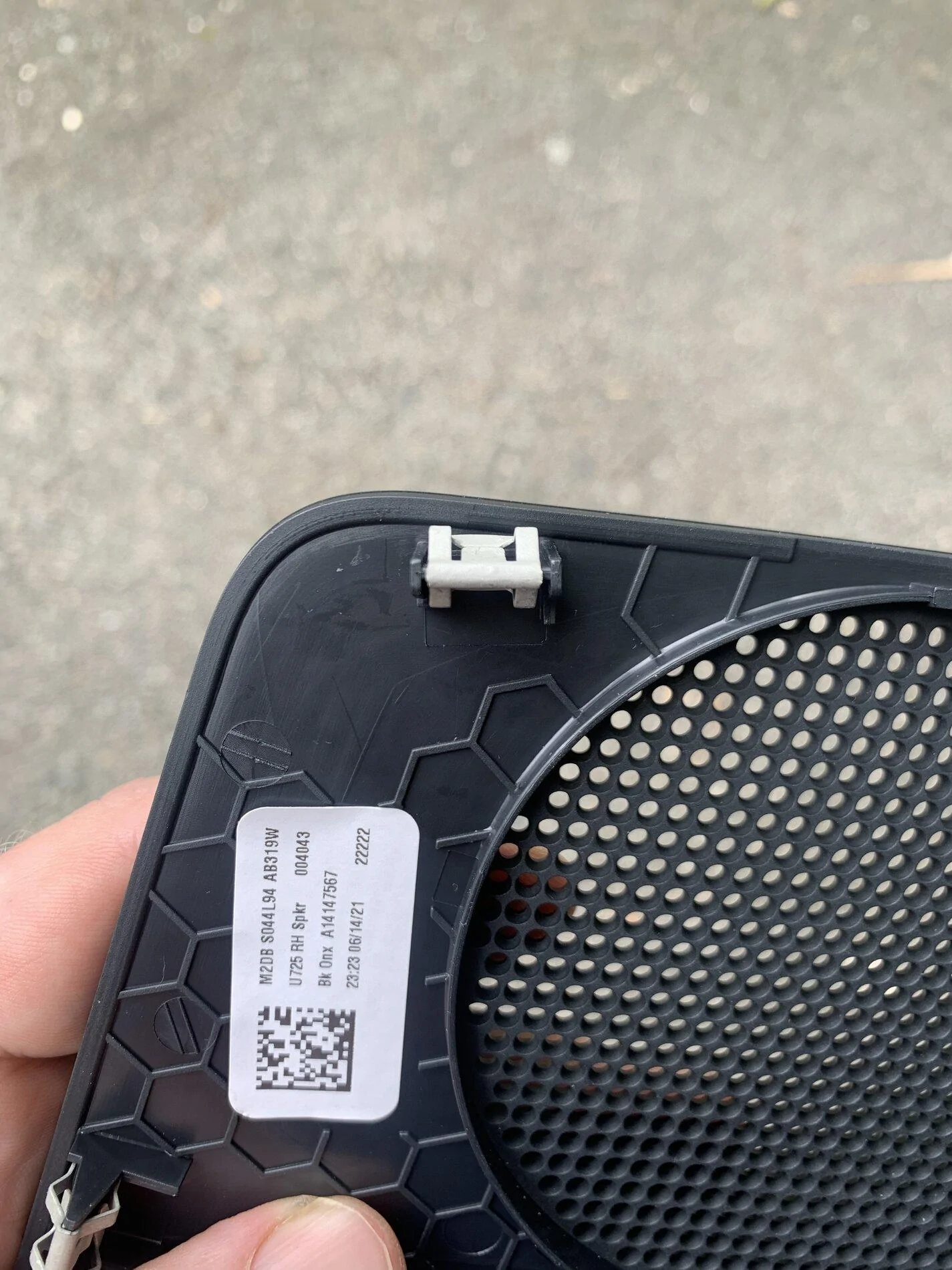

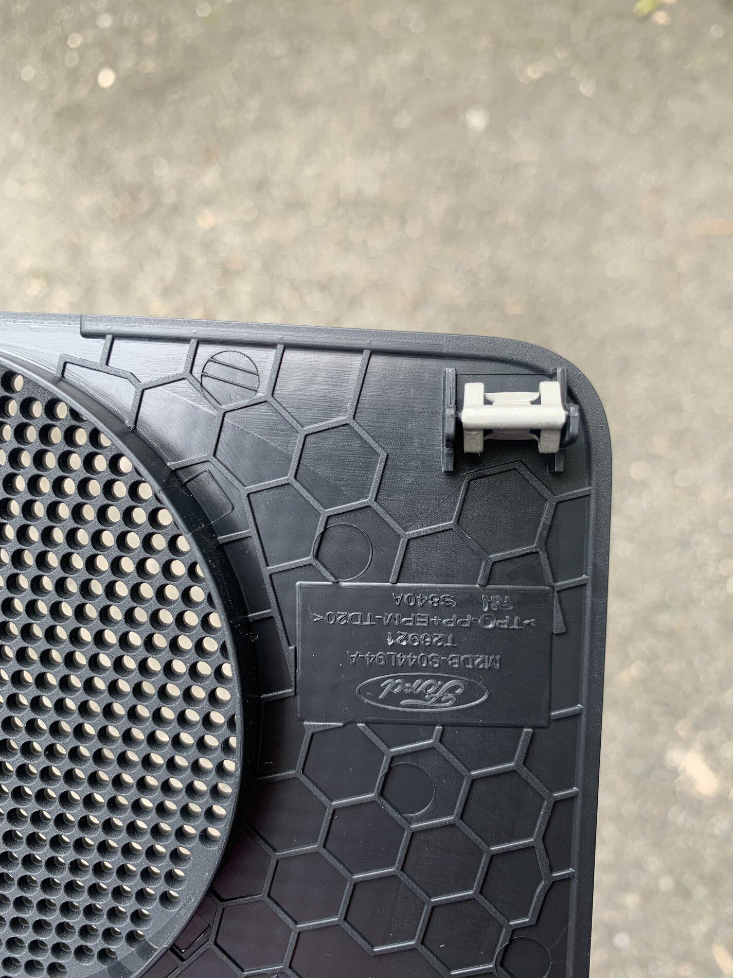

Be careful removing the dash covers. Even using the correct trim tools - one of the tabs broke off with minimal force. Bummer. Super thin plastic. The rest of the tabs are a bit more reinforced H shape - the one closest to the pillar has shortened “legs” and has zero leverage. See below.
Assuming this is going to rattle like hell now.

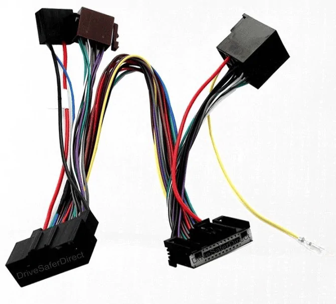

Its very likely the aftermarket will come up with a "T Harness" eventually, companies like Metra have made ones that plug into the factory head units for years, but it will probably be a while before Bronco is added to their catalog.

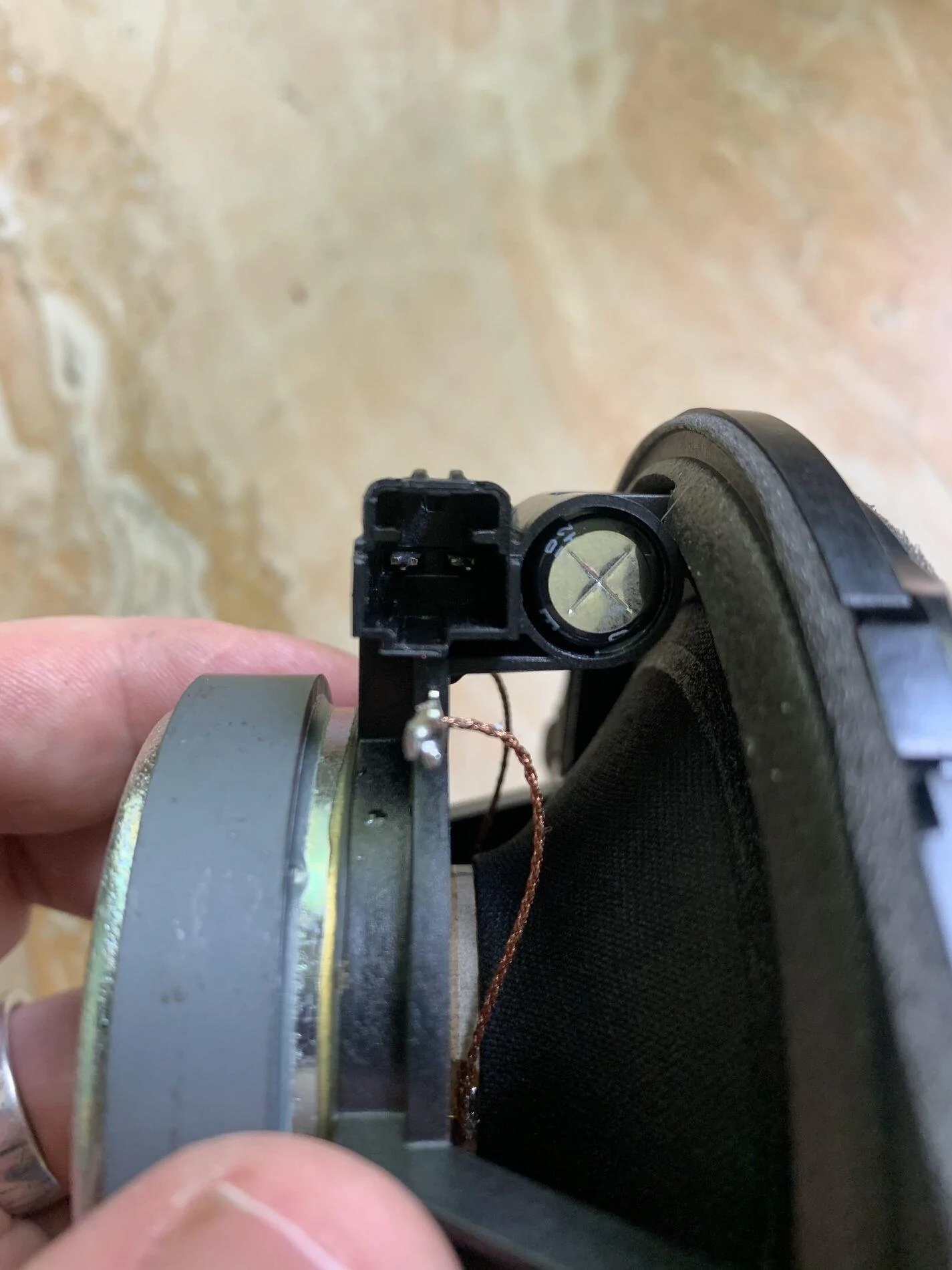

@Erock - I don’t think Metra has caught up yet. The connector looks like it’s new to the market and discussed in other threads. This is the speaker end:
Ford Bronco Base Sound System Upgrade/Build 58FC5F97-FAF4-4A3F-8411-75C70F5AB4A0
