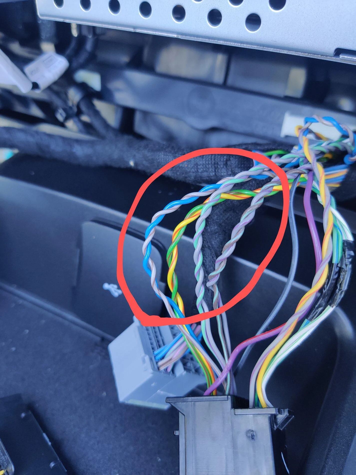

Hey, so the amp is wired into the factory speaker outputs circled in the picture below. As for the 12 volt, I'm guessing you mean the remote turn on, if so that's actually done by the amp itself when it detects power coming through the factory speaker wires.
One of the reasons I liked this amp is because I can then use the blue remote turn on wire that would be an input normally, to tell my sub amp to turn on in the back. So no tapping into the fuse box!

Anyone found a speaker harness yet without modifying original wiring?
Its very likely the aftermarket will come up with a "T Harness" eventually, companies like Metra have made ones that plug into the factory head units for years, but it will probably be a while before Bronco is added to their catalog.
