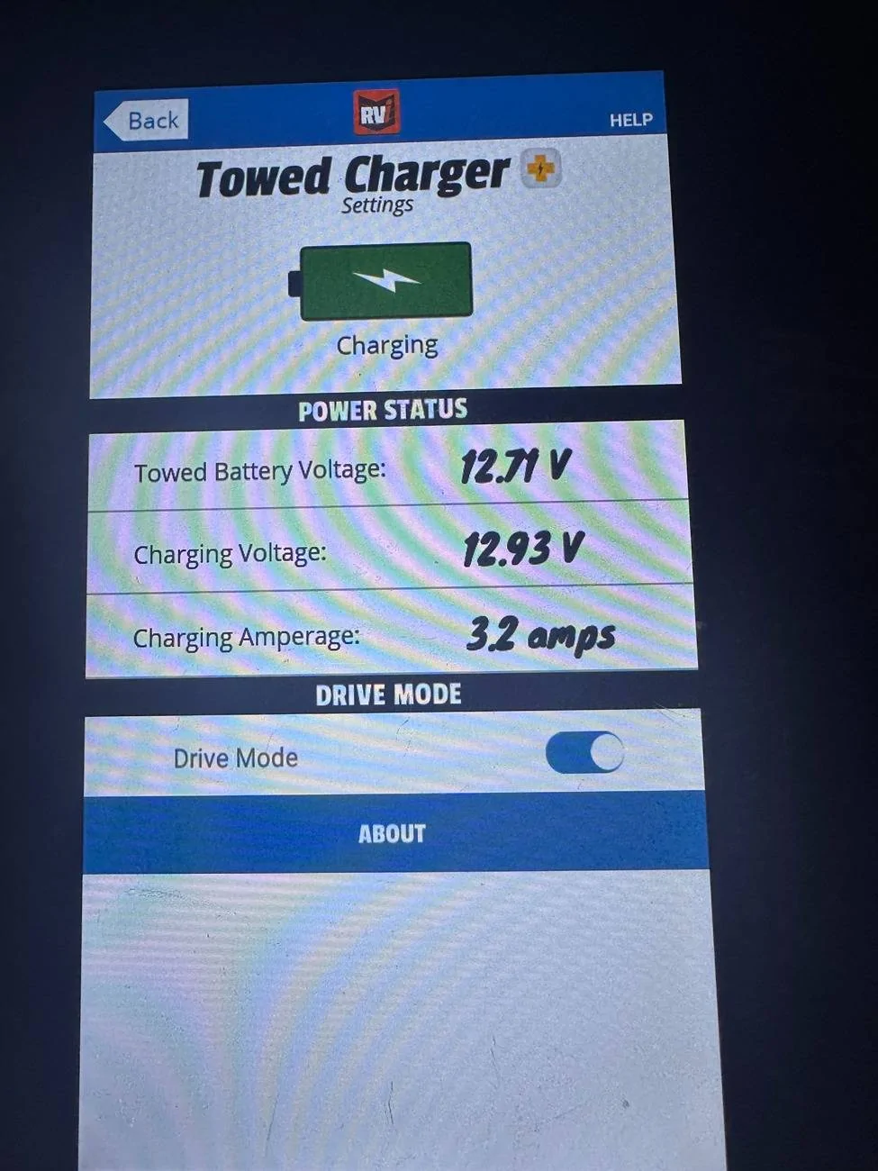

Bronco was just delivered.
RVI works fine and pumps juice. Attaching my work order, so you can see that they did an entire swap.
Ford Bronco Are Bronco Flat Tow Issues Resolved? IMG_7207
The above is pretty much like it was the entire trip, until the battery voltage started to drop despite the charge amps being the same.
Ford Bronco Are Bronco Flat Tow Issues Resolved? IMG_7209
