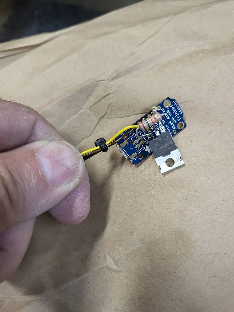

For me a simple solution seems to have worked quite well. I have the 23MY that does not keep the Forscan changes so needed a better solution.
That solution was make something that pushes the button and disables it for me...
One of the first accessories I got for my Bronco was the complete service manual with wiring diagrams, I noted that the ASS disable button has a line from the HVAC module, I measured the voltage in the inactive and active states of the button and even pulled the module that houses it open to see that it is a hard contact to ground when pushed.
At this point I threw together a simple $6 AdafruitTrinket controller with a MOSFET and a couple of resistors to bias it plus a few lines of code and presto! problem solved.
I had planned on cleaning it up as this was just a proof of concept, but it has worked flawlessly since day one so I never bothered to go back and make it pretty. It does not need the heavy duty MOSFET or 1/2 watt resistor, I was just using what I had in front of me at the time.
I did a non intrusive sneak a wire into housing to connect it to pin 7, white / brown wire which gets pulled to ground to simulate the button being pushed.
The board gets its power from tapping bottom fuse of BCM 'RUNSTART' power.
