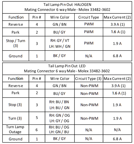

Yes, the picture I posted on pg. of this thread has the pin numbers in it for the taillight and the BCM side. if you download the electrical schematics zip that someone posted on Bronco6G, you can find both driver and passenger sides.

Thanks, I’ve found the wiring schematics, but am searching for what part number pins to order. Looks like the Molex part number (33482-3602) is listed in your post for the taillight plugs (attached), do you have that info for the BCM connector? This should help determine which pins to order from Mouser.

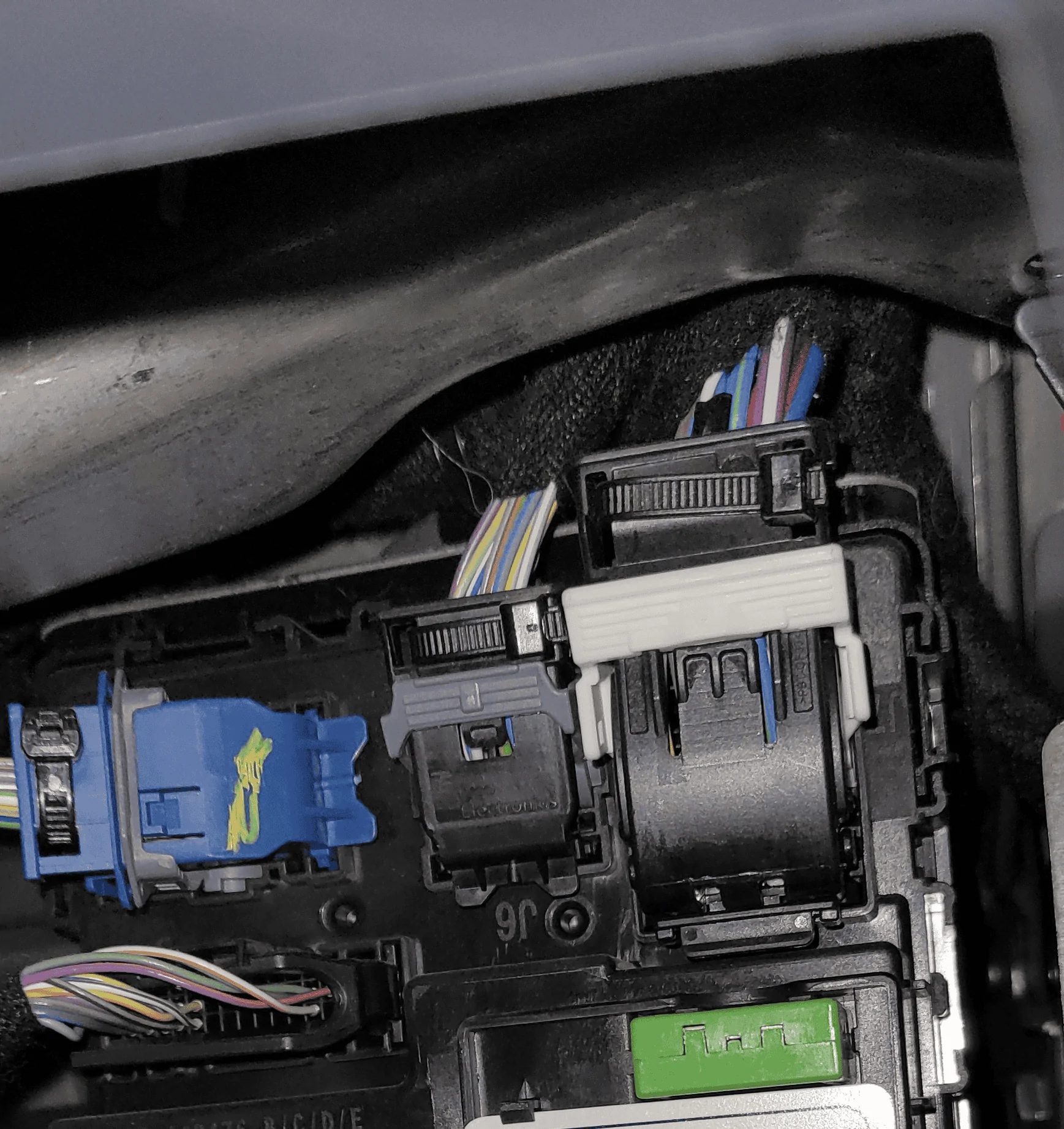

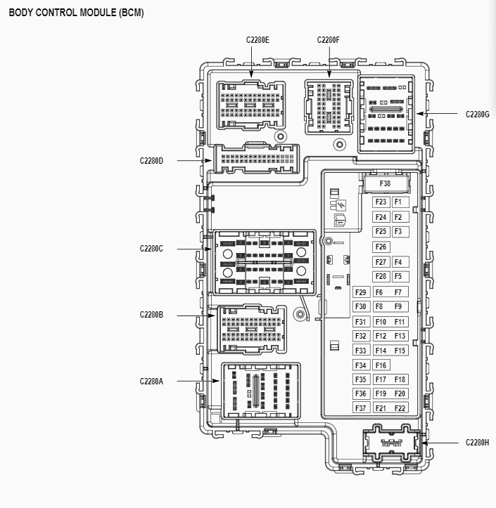

It is on C2280E which looks like the topleft-most connector. The top left Blue one in the picture I just took. I am not sure what connector P/N this is.
A longshot, but maybe @flip can help us figure out what connector P/N mates with C2280E on the BCM and from there we can figure out the pins easily.

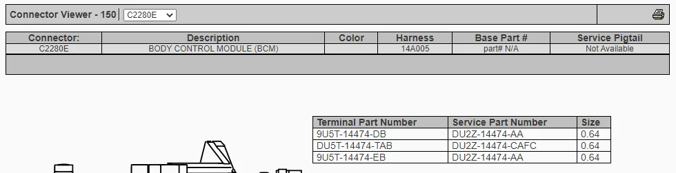

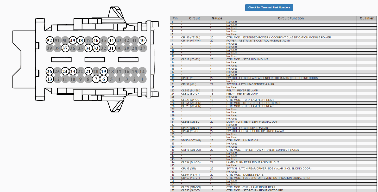

Awesome! Are you able to hit that "Check for Terminal Part Numbers" button and tell me what they are for pins 26 (18 AWG) and 31 (22 AWG)?
jh3113
Jake
Aug 9, 2020
260
261
Phoenix
Subaru Outback
@gringoloco I believe based on this information that for C2280E (this is a hypothesis, it has not been tested yet)
1924955-4 = 18 AWG terminals
1924955-3 = 22 AWG terminals
This was based on some F-150 forums i found and the above information and has yet to be verified.
