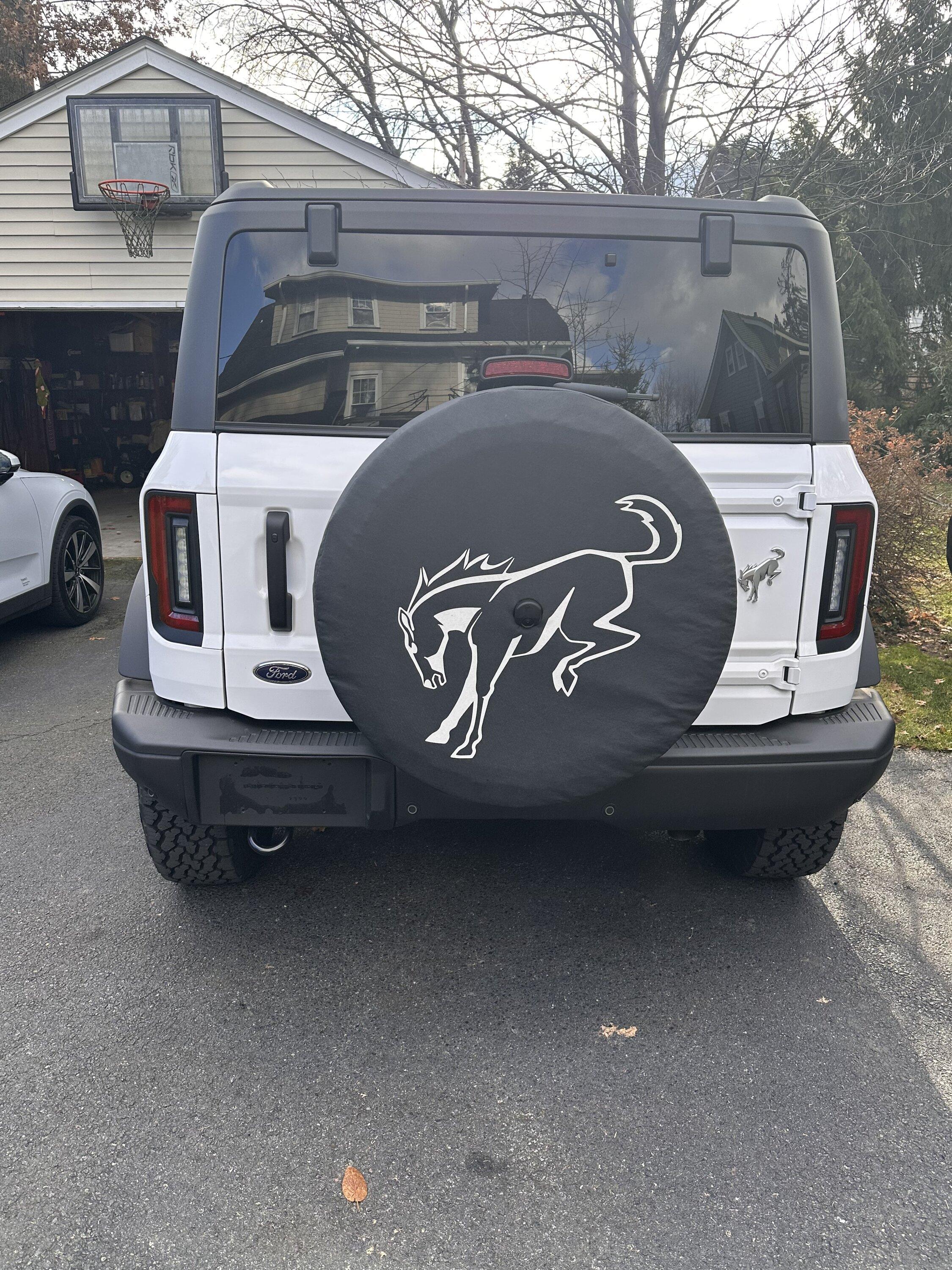

I know this topic has been discussed before, but I actually got a hold of an LED Tail Light and tested it on my BD.
Almost all of the light works, apart from the turn signal. Actually, it half works. The turn signal in the dashboard blinks fast (as when a light bulb is burnt) but the tail light actually blinks, but its the perimeter light that blinks and not the separate built it turn light (orange). Same happens when the emergency flashers are engaged.
Does anyone here know if this is a wiring issue ( unlikely to be resolved) or could be solved with ForScan and its coding ?
Thanks

It’s both, there are extra wires in the harness from the BCM. FORSCAN coding, too, for the bulb warning and separate blinker

I went down the Oracle path - so far happy - still have an OEM LED taillight that I purchased for my experiment
