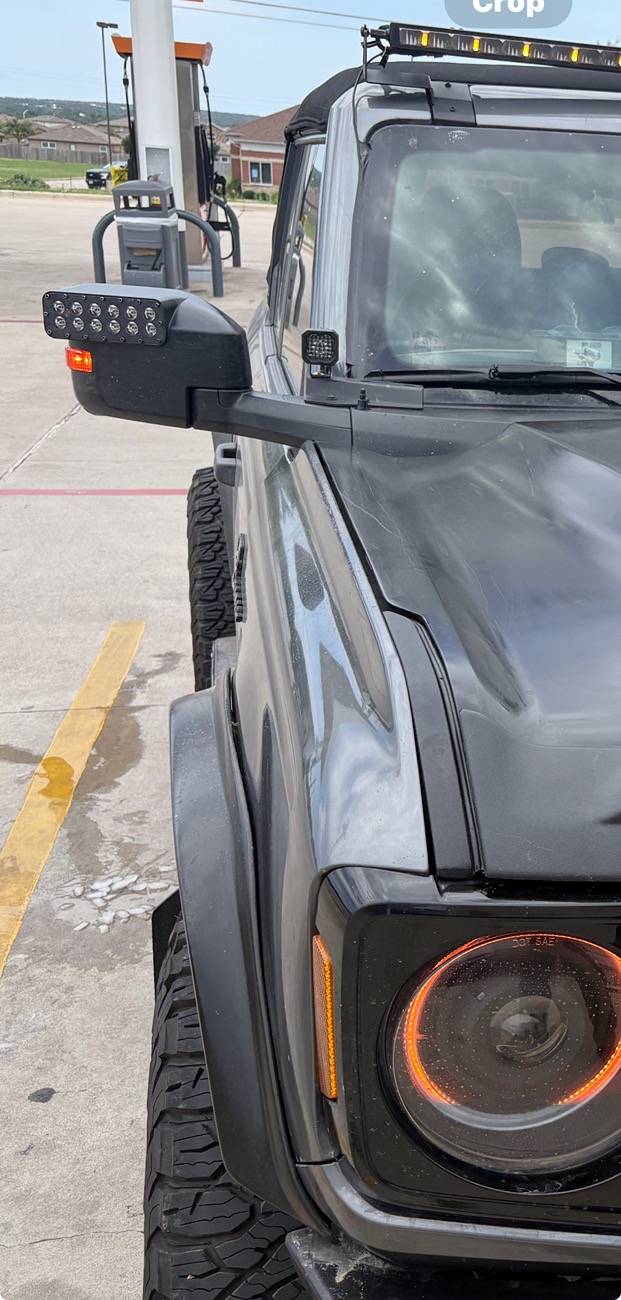

I did the always the “always on” wiring trick a few of us have done, via an Aux switch, and an amber lens cover. This DRL feature would be better as a DRL.

Is the DRL feature “always on” with vehicle running or is it switched inside someplace?

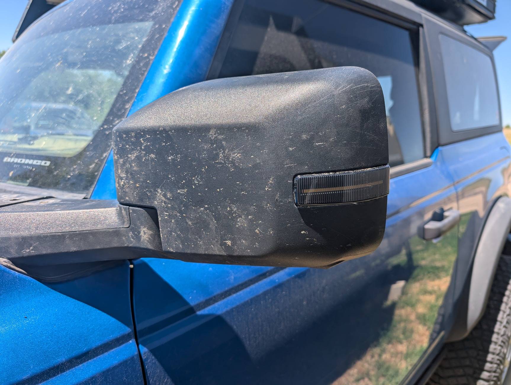

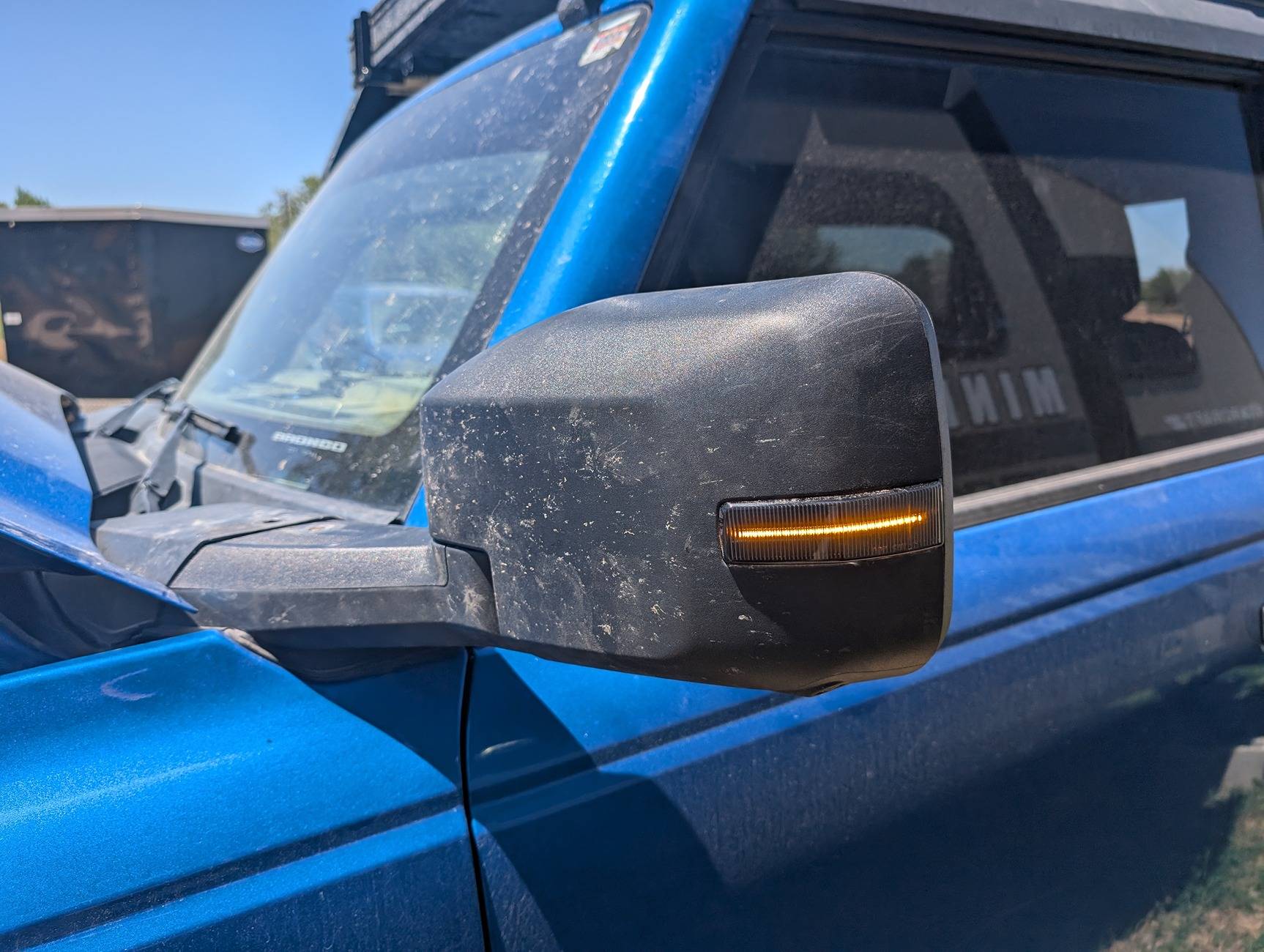

Excuse the bugs.
Ford Bronco New Amazon Find: Archaic LED Mirror Lights PXL_20250530_201409783
Ford Bronco New Amazon Find: Archaic LED Mirror Lights PXL_20250530_201440639
The white light? Comes on with the low beams, or you can remove that function altogether by connecting 2 wires in the supplied harness. The amber light is blinker only.
I have a correction. The amber light is on with low beams if you choose not to use the white light.
I have both sides done now.
