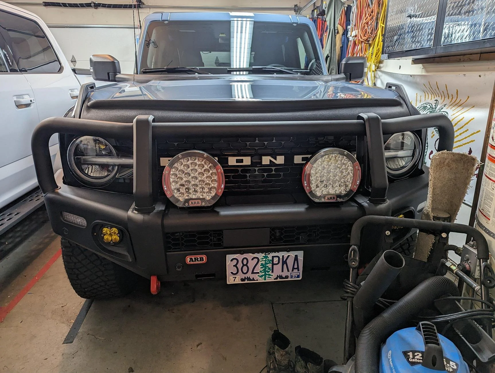

Doug_life
Apr 27, 2023
115
131
Oregon
23 wt, 78 bronco
Had a local off-road shop install mine. Estimated a 6-8hr install, took them 13hrs. They said out of all the arb bumpers they've installed on pretty much every truck offered for, this was by far a complicated install. All others are straight forward, quick and easy.
Either way super happy with the bumper.
I believe it! Part of what took me so long was that I started in the evening and had to buy hardware and tools (non common drill bit size!)

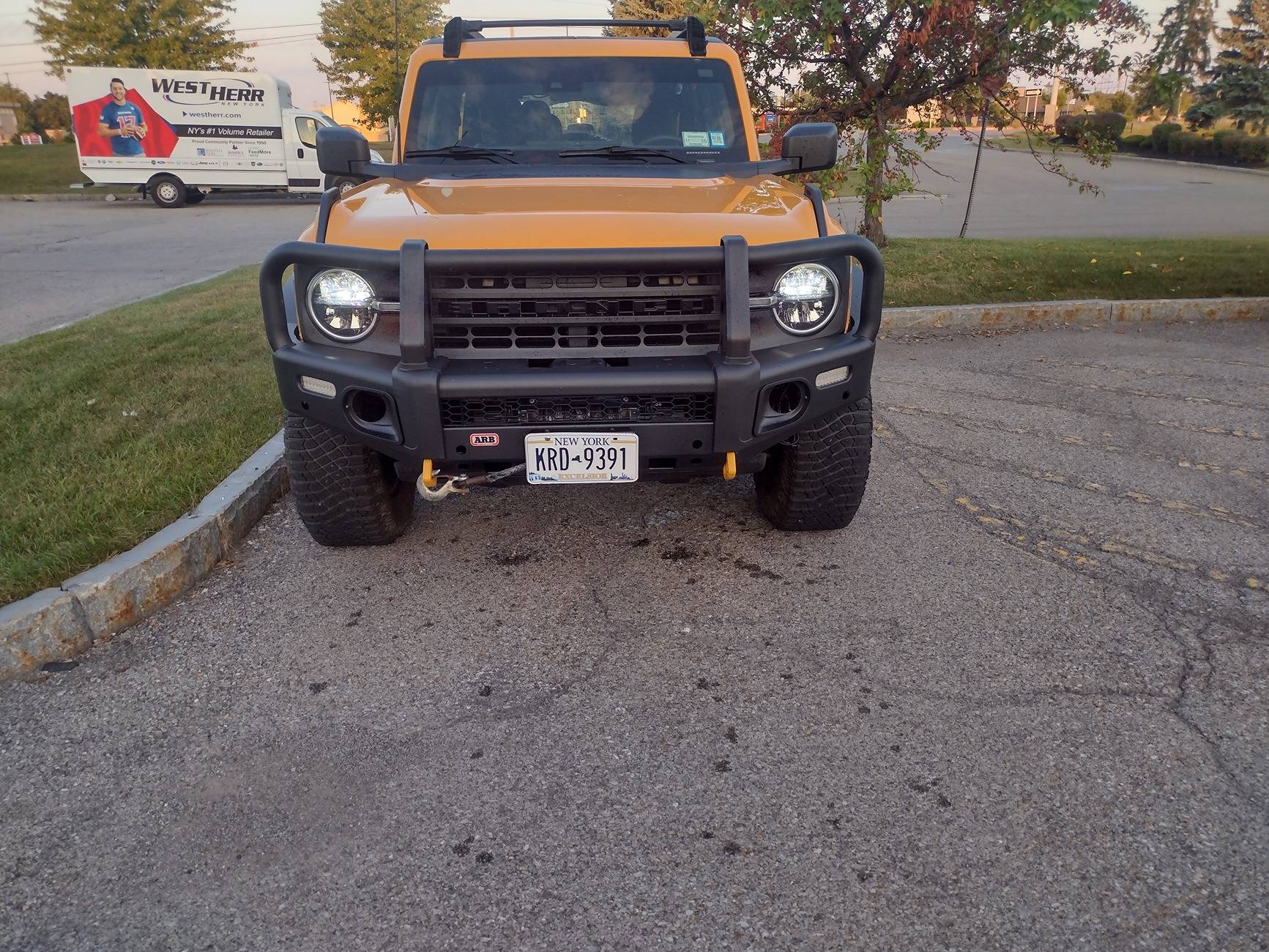

86Isuzu
Jul 13, 2021
99
119
Buffalo, NY
89 Bronco II, 03 Ranger Level II, 2022 Bronco
Installed mine yesterday along with a Warn Zeon 10S. Took about 4 hours of actual install time. Another 4 hours or so of prep.
Pro tip: when doing the intercooler bolts, unbolt the two bolts holding the radiator in and you gain about 2 inches of space above the intercooler.
