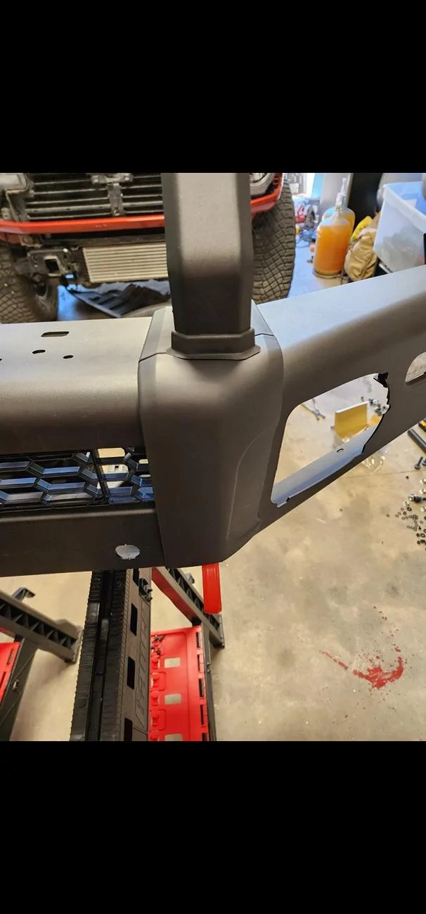

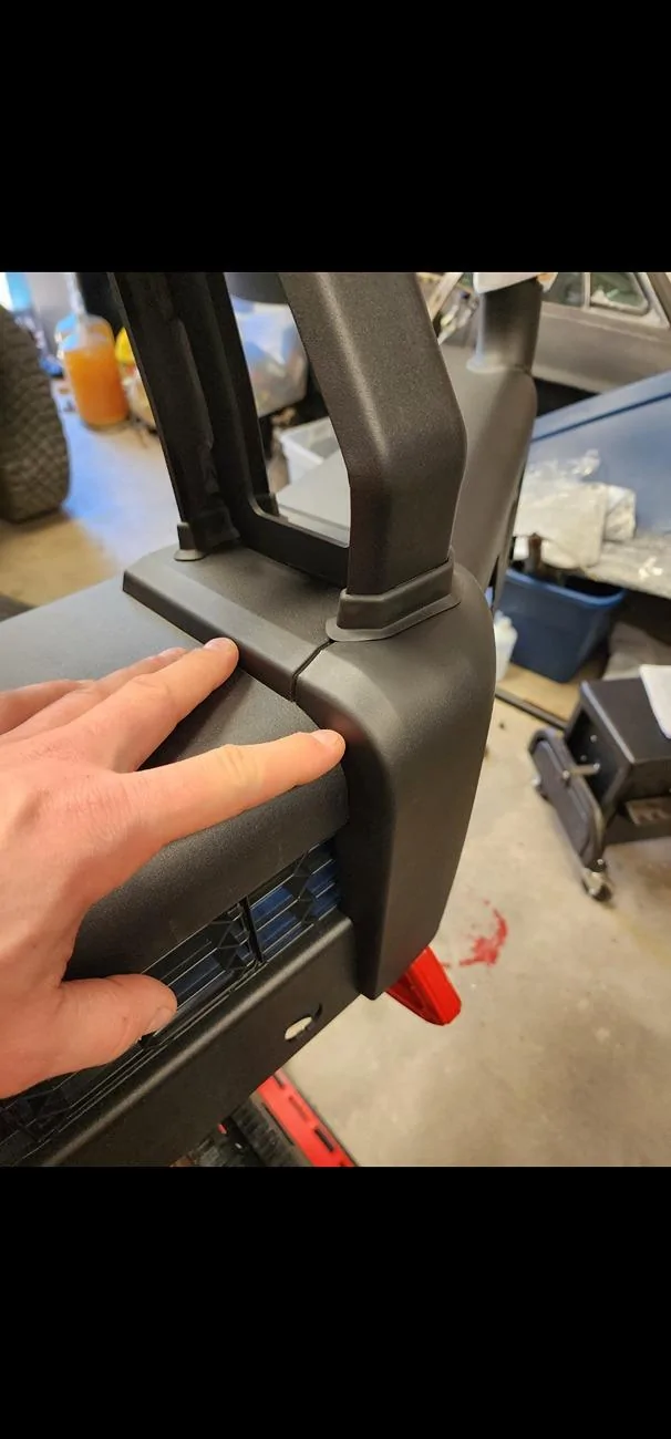

The plastic bumper guards were a minor inconvenience. There are e pieces. The rubber molding that slips into the bull bar base. Then a flat piece that slides between the bull bars and a front piece that mates to the flat piece. Unfortunately the plastic groove is very thin and the slightest misalignment will Mar the groove and prevent it from lining up correctly.
Other than being time consuming, it wasn't difficult to put together.

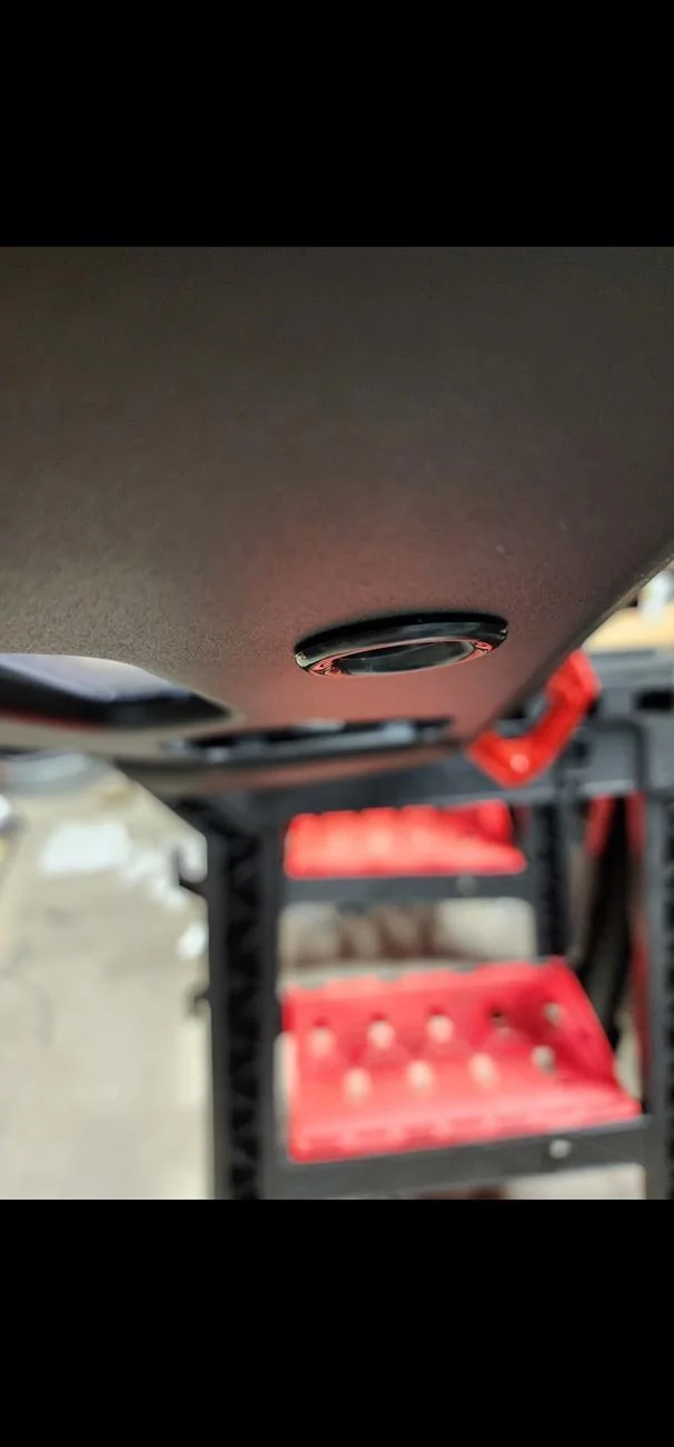

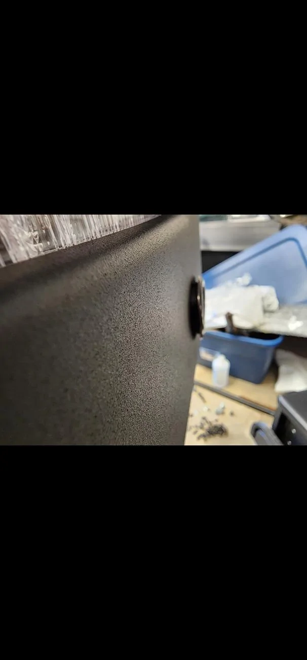

I'm struggling to find a way to get the parking sensor mounts to sit flush. They have a gap that looks bad.

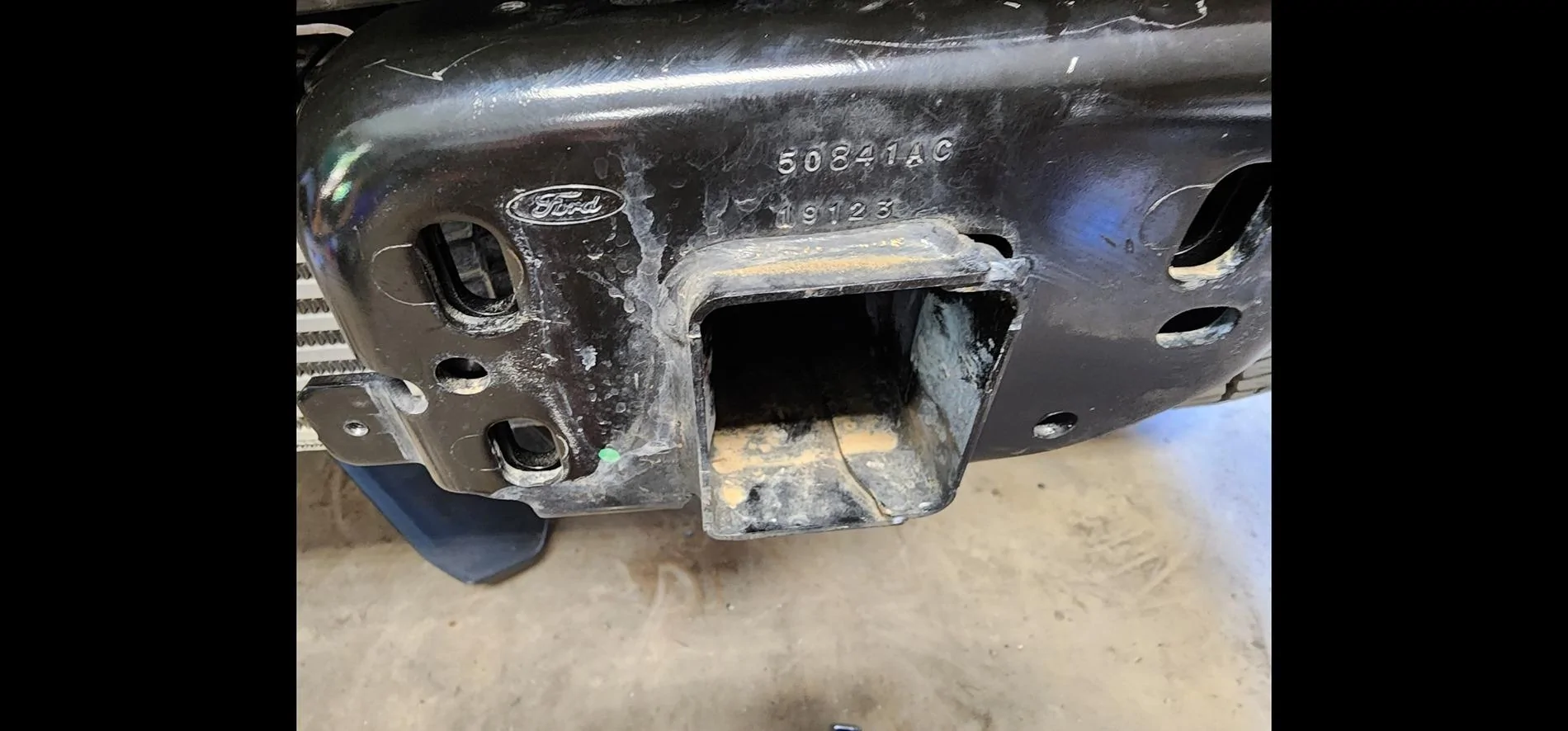

Last night I tore apart the chassis mounts from the frame again.
I found an arb zenith install video that the mounts are nearly the same.

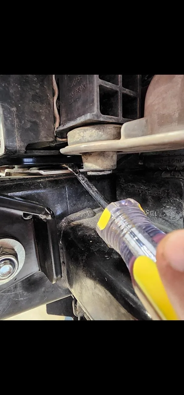

I watched the video and realized the packers are the 6mm thick metal washers.
The confusion I had was that the only packers listed in the instruction .manual inventory were the m6 nylon washers for the liscense plate install.
I tore it down (4th time) again and followed the zenith instructions. I had success!
The trick was to hold tension with a screw driver under the intercooler bracket. Once I did that, the packer slipped into the right slot and the entire assembly seated correctly.

Success!
Had to rotate the parking sensor bevel 90 degrees and it slipped in. It's still a bit loose fit wise.

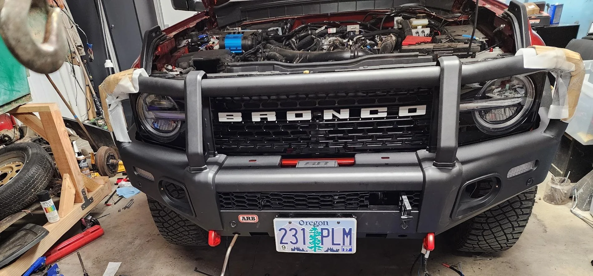

I got the bumper on solo. Used an engine hoist and some webbing. I wrapped the bumper corners with the bubble wrap from the packaging. Then manually adjusted it up and down while it was dangling from the hoist.
Once I got two bolts and nuts in per side. I crawled underneath and installed the rest.
The only hang up I'm having is the m10x40mm bolt is not long enough due to the gap.
I'll have to swing by the hardware store (again) and pick up an m10x50 to finish the install. After that, I have to route the camera, tie up the wiring harnesses, and wire the winch.
