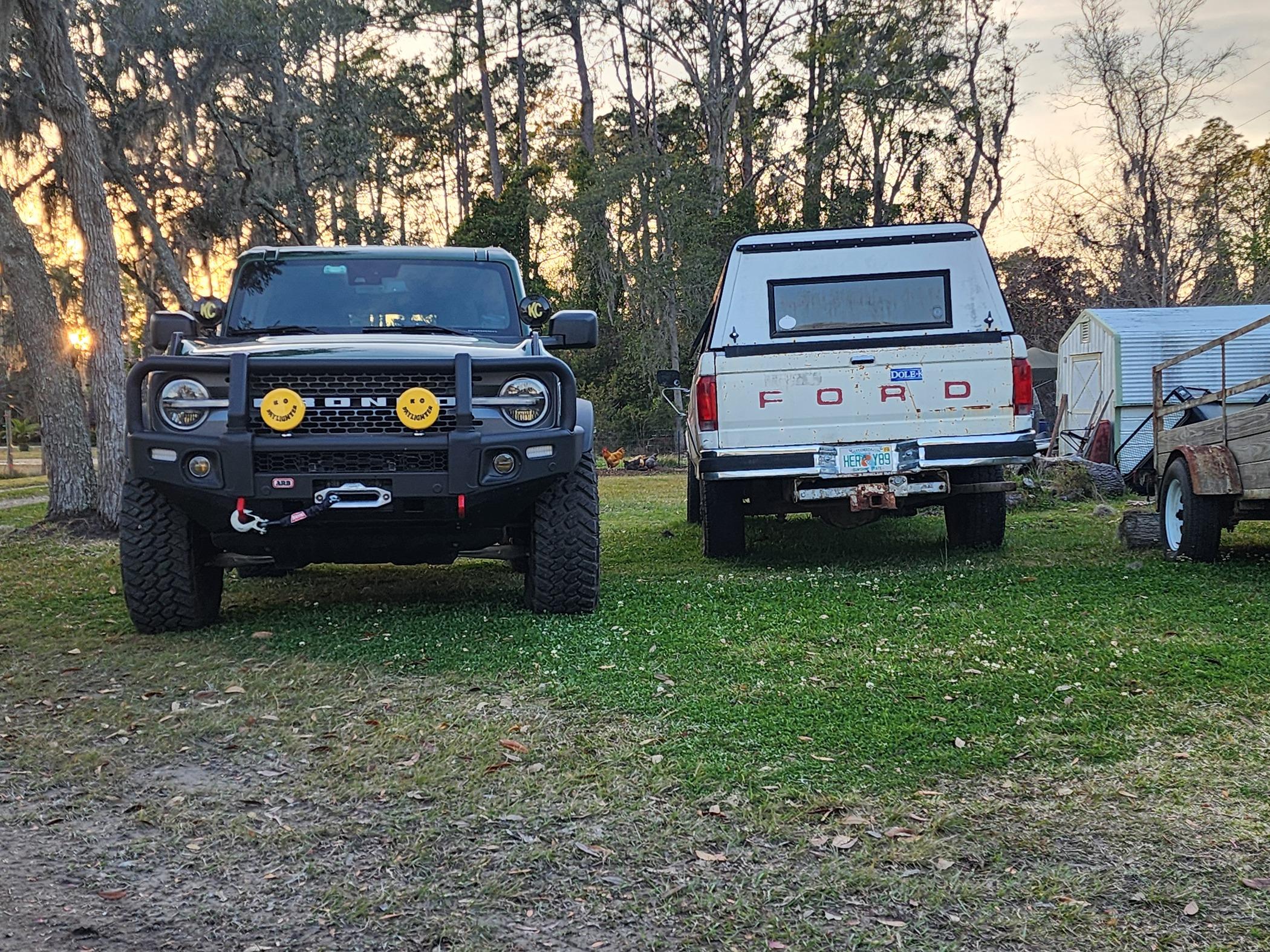

My new ARB summit bumper installed

Good looking Bronco! Curious if you notice anything from the extra weight up front?
I don't have the ARB but my front has a fairly heavy steel bumper and full steel skids. The front now sags a LOT more than it did after about a year of use. I can't make up a number, but it's bad enough it's time for new shocks/springs/something. It's very noticeable over time. Wear and tear I guess.

My SAS Badlands dropped 3/4" in the front with exact same bumper/winch setup. Though I installed Diode Dynamics fogs.
Same here. I even stopped short of installing the winch...
I feel the badlands suspension is so stiff that it might actually help counter it a little, but it def lost some height with the bumper.
