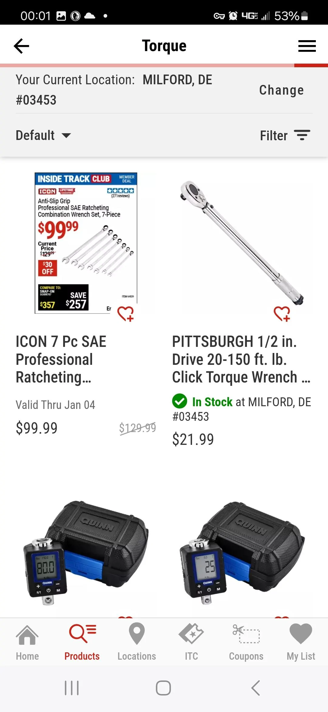

I have a HF 1/2” drive torque wrench in my Bronco bag of trail tools - it even came in an injection molded case. I wouldn’t use it to build a motor but for $10 it gives me peace of mind that my lugs will be “close enough”
HFT for me as well for a simple, quick, cheap torque check.
And the quality on HF tools has really improved that they're comproable or better than Craftsman/Cobalt, Husky and the low-end Grainger offerings.
