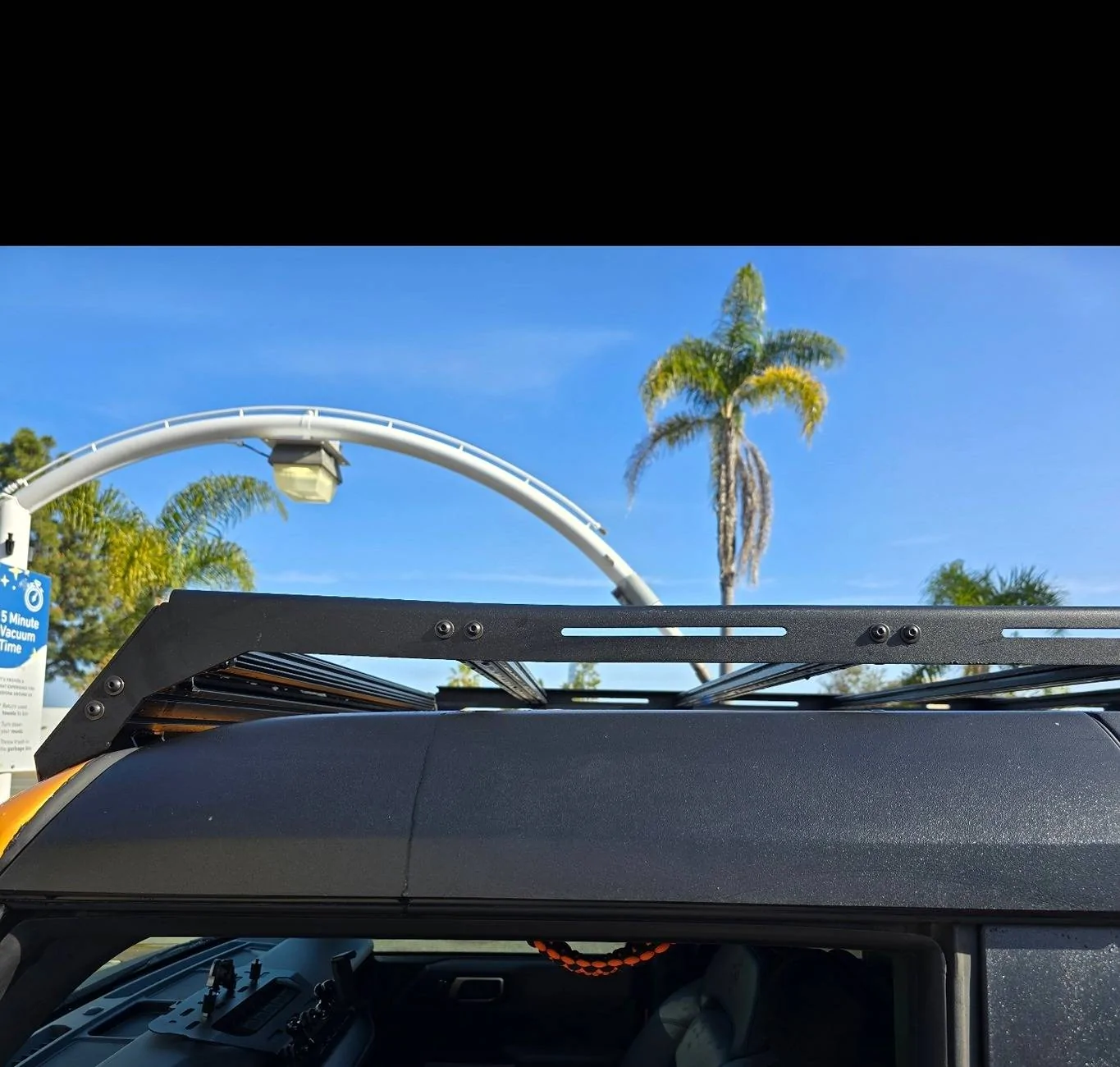

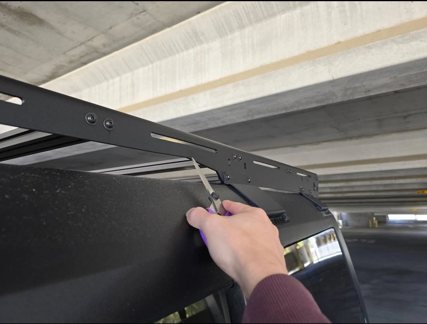

The reason I am interested in Prinsu is that my previous TrailRax side rail is slightly bent right above the driver seat and I don't carry any load at that time. IMHO, that part is the weakness. A long rail section with no clamp or support + a taper profile. Not saying Prinsu is better because I don't see it in person. But looks promising.

No, I checked the photo the first time I installed, it is straight.
My guess is the twist between windshield frame and body frame cause this. TBH, some extra load like rtt, IMHO, could reinforce the structure.
Actually, your bends are different from mine.

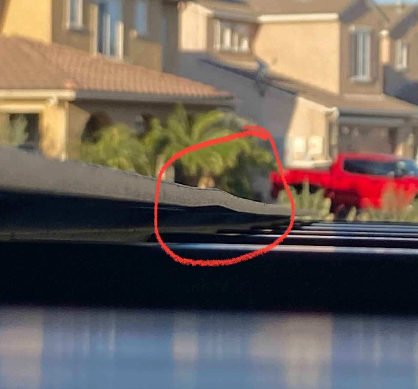

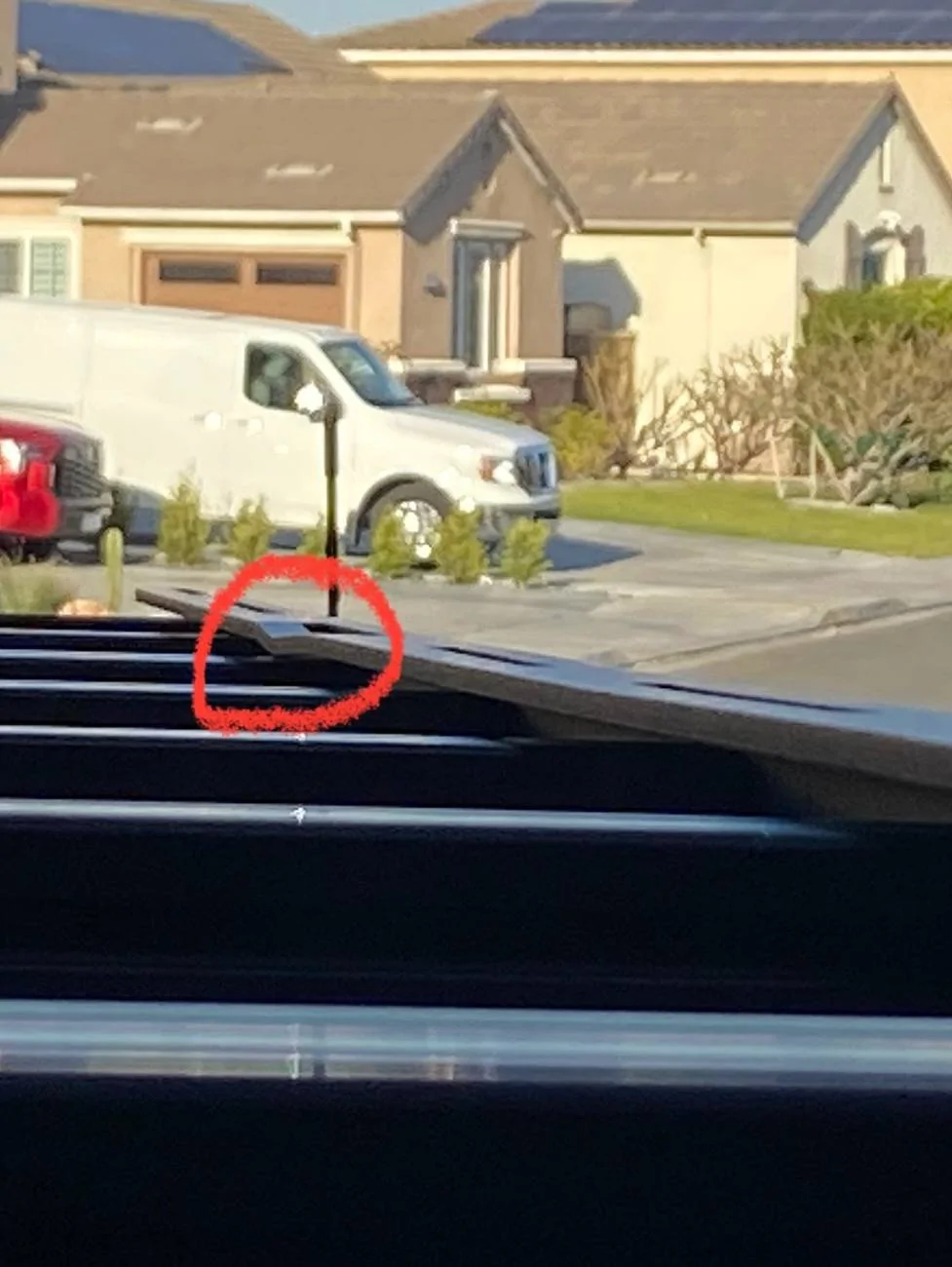

I have slight bends in the main support side structures of my Trailrax as well...the driver's side has a small concave "dent" on the top of the side structure and the passenger's side has a concave "buckle" on the top of the side structure. I have a feeling the Bronco has more body flex than we think and since the rack is bolted down at all 4 corners, the flexing ends up buckling the rack at the side structures.
I think you are right on the body flex.

Well y’all have convinced me to get those reinforcements but gosh it’s buckling in two places :O

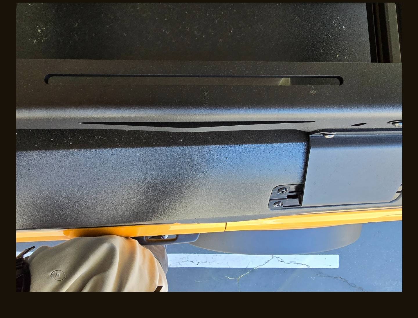

It’s hard to get a good picture showing the whole rack, but the first pic is towards the rear on the driver’s side, on the 2nd top slot from the back. Second pic is toward the front of the passenger side, on the 3rd slot from the front.

These buckles are on the edges of the long slots along the top of the side structures. I brought this up to Trailrax a year or two ago, when I noticed it and they did not feel it would impact the structural integrity. I have considered adding the additional braces that the Braptor has, but don't look forward to removing the rack and the hardtop again...those windshield nuts are a pain in the ass.
