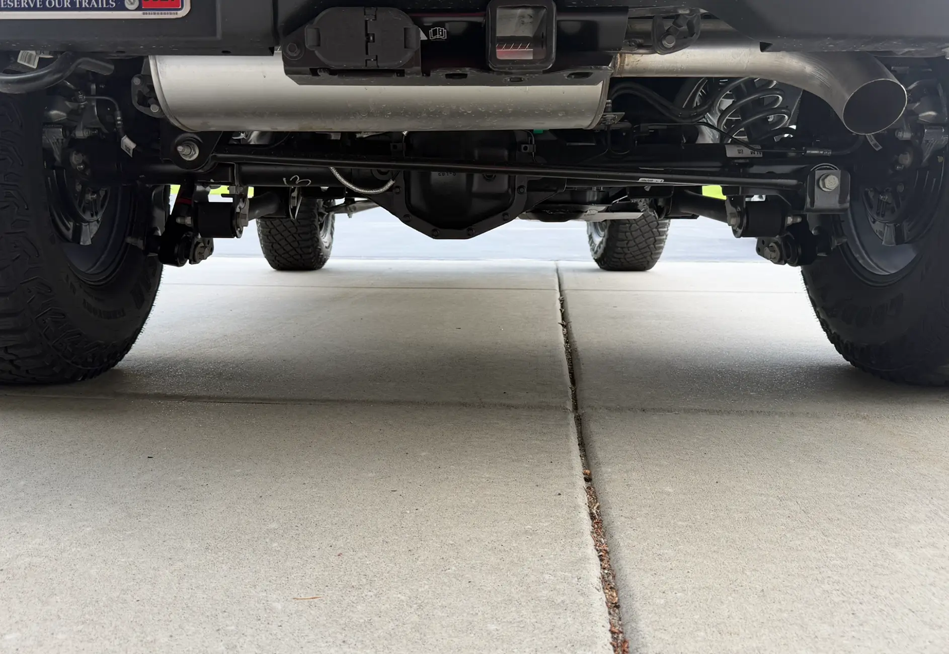

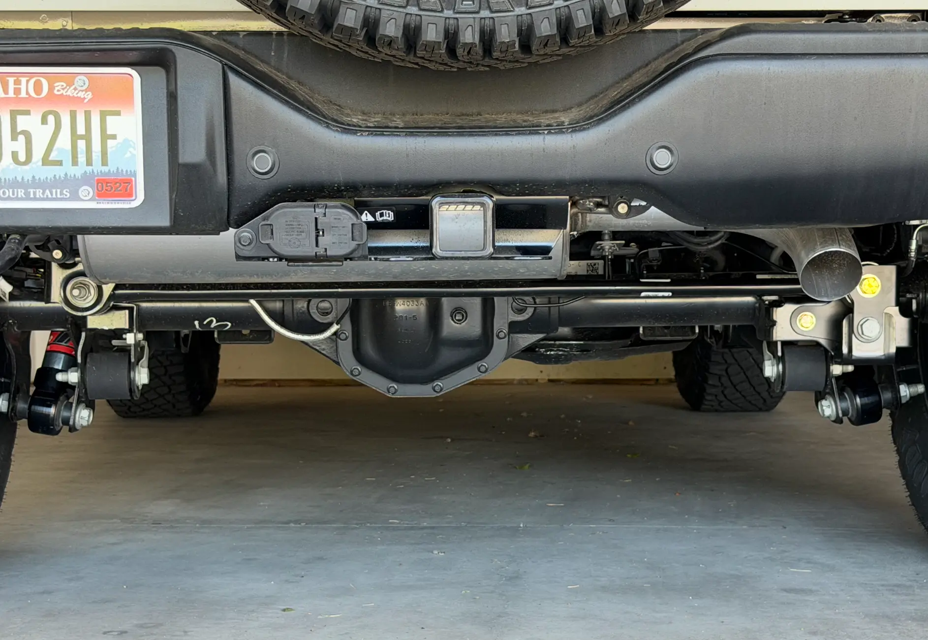

I got the Rock Jock track bar bracket and put it on this afternoon, totally leveled the bar at this lift height. Haven’t driven it much yet, will drop a note after I get some miles on it whether or not I can feel any difference.
Before….

After….
