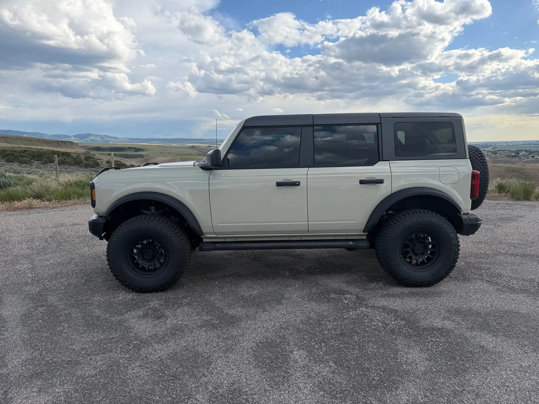

Did the Install myself in my driveway, came apart and went back together pretty easy using the drop the bottom control arm at the frame method instead of taking the knuckle apart. Some bloody knuckles and sore knees but well worth it making sure everything was put together and torqued properly. I did buy a huge torque wrench to get the 350 ft lbs on the lower rear coilovers, was actually surprised how easy I got the click with the large wrench.
I turned the rear coilovers all the way down so there is no threads showing under the collar. The front I turned down so there is 3/4” of threads under the collar. I’ve got the 2.3 engine, the stance turned out very level, will be interesting to see how much and where it settles once I have more miles on it.
The ride is super smooth, I would actually compare it to the ride of my neighbors F150 Raptor. It definitely took the harsh out of the stock non SAS suspension. Small bump compliance is very good. I feel like it quieted down some of the interior noises as a result of smoothing out the jarring stock suspension. Has a little more body roll but not bad. I haven’t noticed any acceleration squat or brake dive yet.

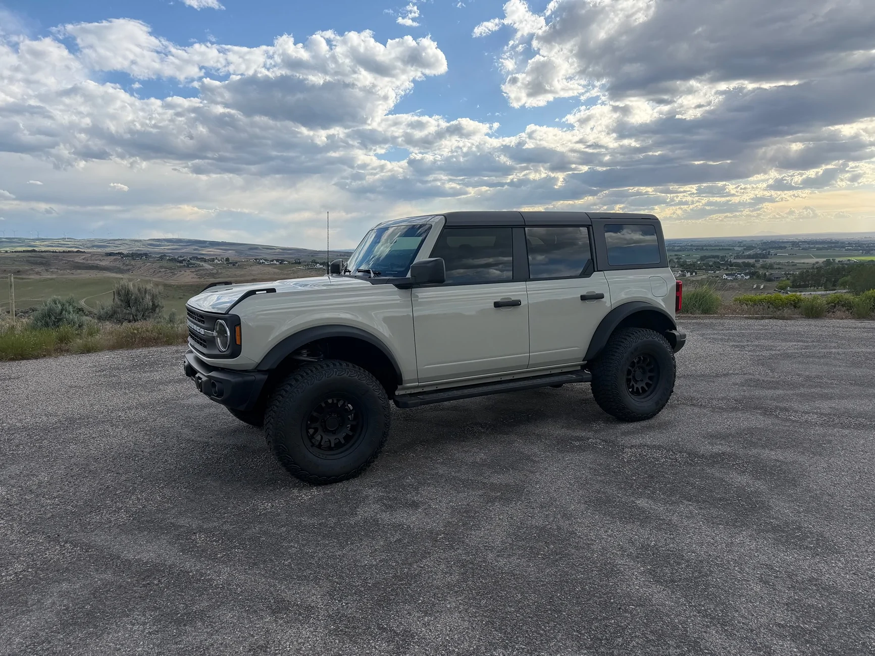

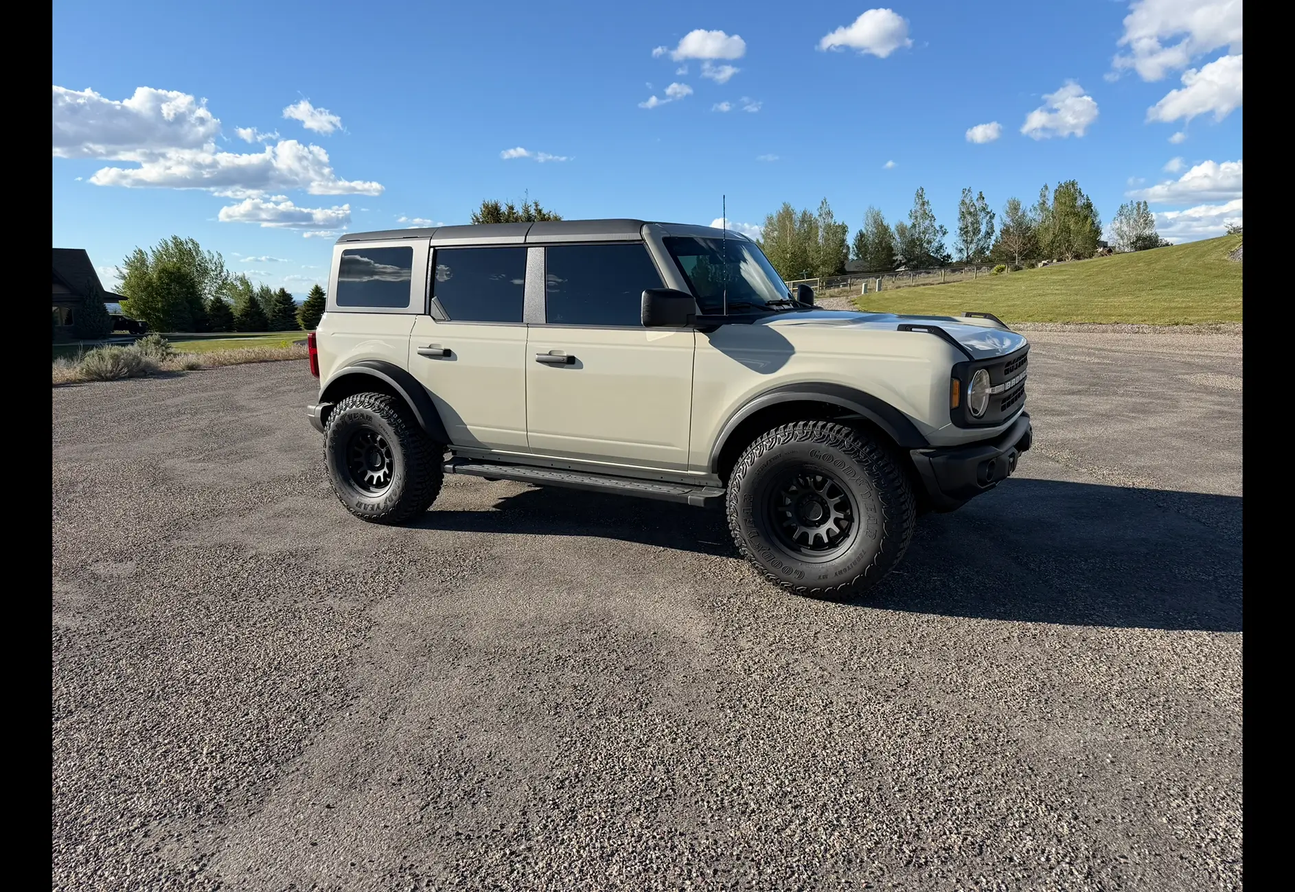

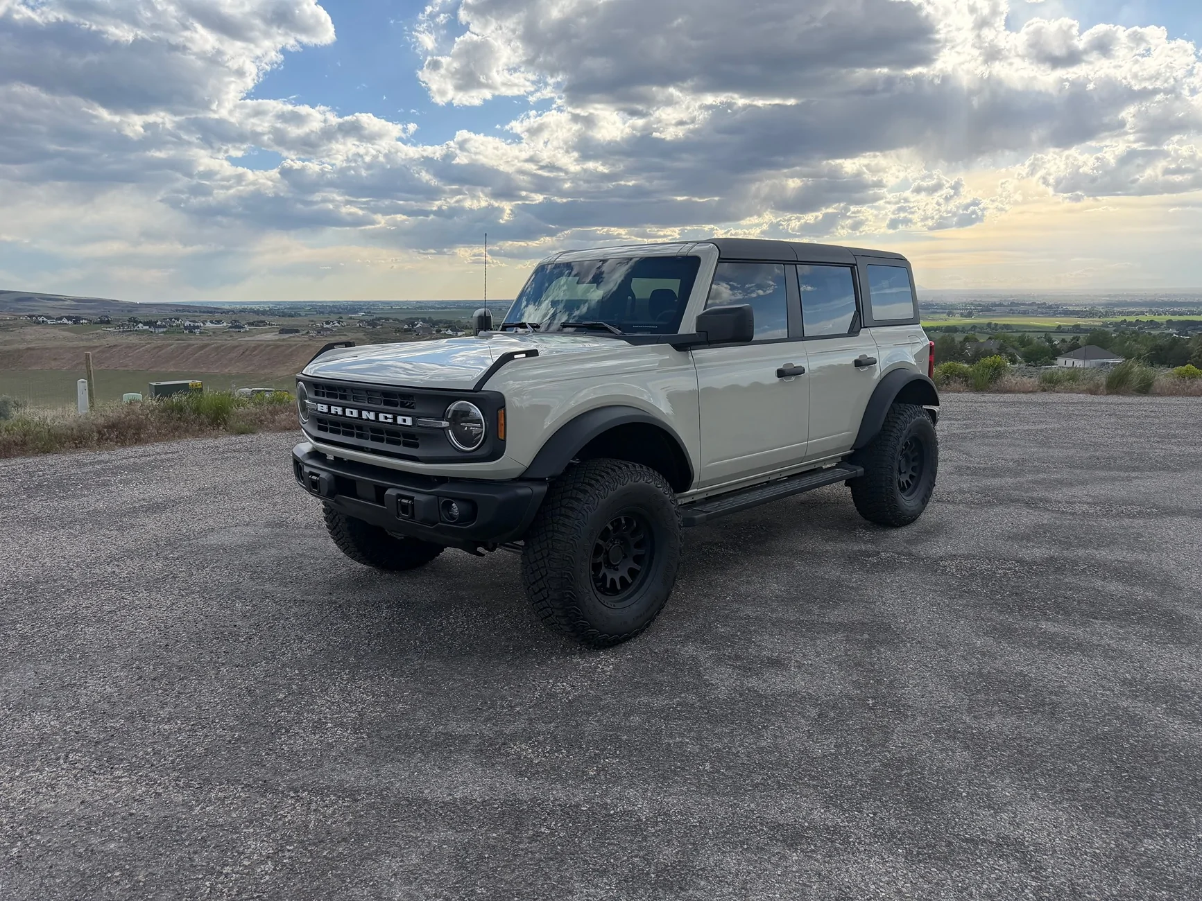

Pics of the 35’s on stock suspension and with the new suspension, and one of my garage helper…..

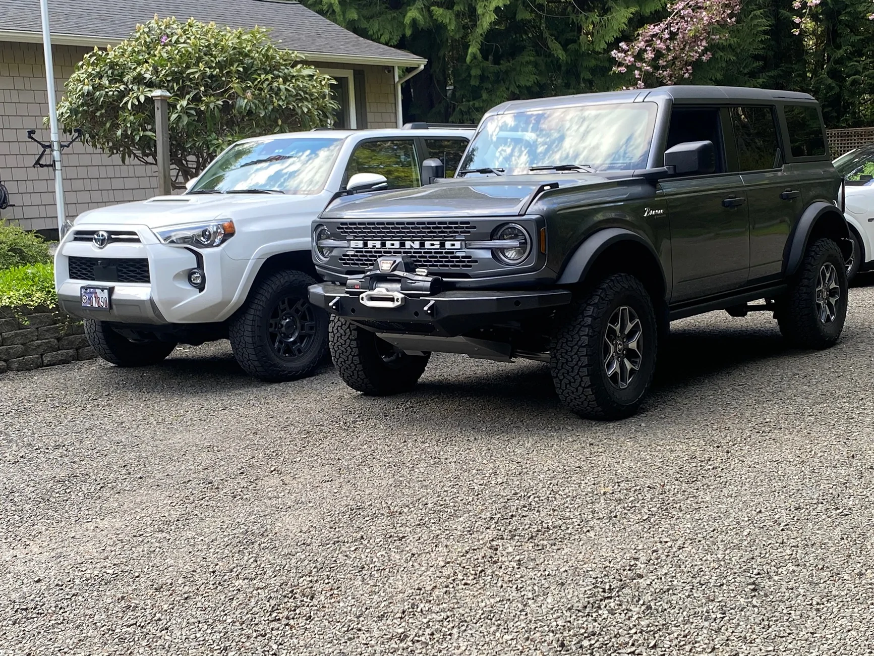

Nice. I did the same set with the HD springs a month ago. I also dialed them way down. I am a non SAS Badlands so my factory 33’s look really small. Have 35-skinnies 35x11.50/17 on order.
Ride quality is a big improvement over the HOSS 2.0. Much smoother and soaks up the small imperfections and greatly softens the bigger hits. These shocks plus airing down slightly is like a trail Cadillac.

Looks great! Do you happen to know what your tire to fender flare gap is? I just installed some Procomp coilovers and am curious of the difference. I still have room to raise it, but I find if I go up any higher it preloads too much and the smoothness is diminished.
I think I'm around a 2.5 inch lift and have 8 inches of gap with the stock 35 inch tires.
Thanks! The tire to fender gap is right at 7” all four corners. I was surprised that it was right at 7 and the same on all four corners after lowering the rear all the way and adjusting the fronts where I did. I’m really happy with the stance and the ride.
