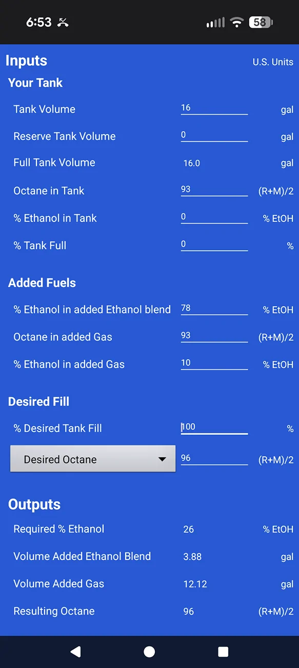

There is a lot to unpack and correct here...
Being frustrated by both the lack of availability and in many cases blatantly or obviously incorrect mixing tables/calculators, I did the detailed research and cracked the problem. Blending to a % ethanol goal is straightforward, however due to it being a non linear problem and with the complication of different ethanol levels in the base fuel and added fuels, blending to an octane goal is quite difficult, mathematically.
Specifically, your examples above can't be correct as they are incomplete. What ethanol level is in the base fuels? E85 is pretty well never 85% ethanol. The details absolutely matter.
In your first case, assuming 10% ethanol in the 93 and 78% in the E85 (a very common combo in the US) the volumes are close to correct, but resulting ethanol level isn't, it's actually 26%. You would also almost for sure want to take into account some tank reserve, which I've omitted so as to be as apples to apples as possible. The second blend you provided is significantly less accurate on both volumes and resulting ethanol!
Here is a screenshot from my Android App. More info on it at octanecalc.com .
Ford Bronco Another E85 Question (2.7L) Screenshot_20260513-185356

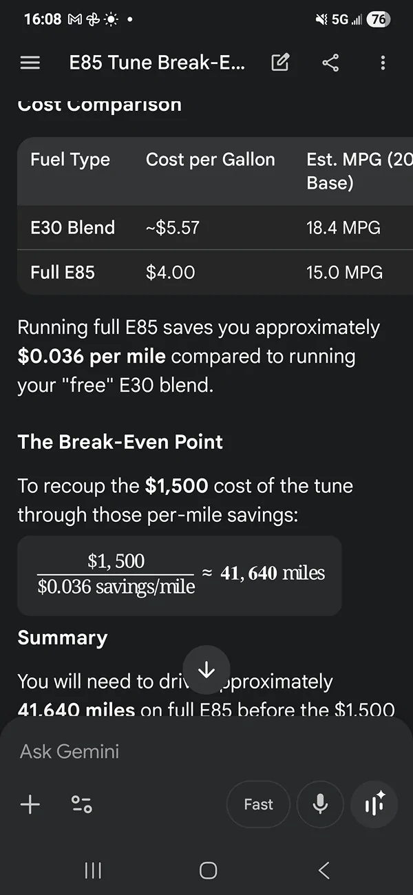

I appreciate the correction on the math. And I'm downloading the app now actually. Point still stands that it can take quite a while to recoup the cost of the tune if overall cost savings is your goal. If you're just looking for an excuse to get a tune, well I think we'll support you here and say it will pay for itself! ...at some point🤔😂
