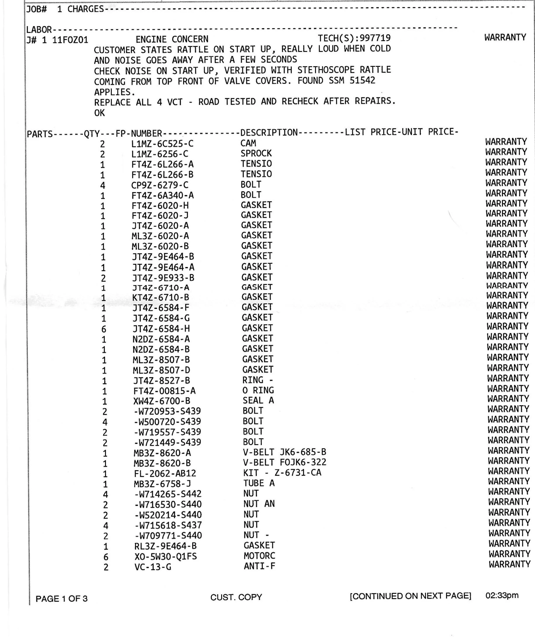

Ok just got back from the dealership to pick up my bronco from cam phaser replacement, dropped off 7/25, parts arrived 8/18 from backorder, picked up today 8/24. Havent really had any time yet to really go over it but seemed fine on the drive home. Here is the full parts list from my service, i know a few people have been asking for this. Let me know if you guys have any questions and ill try to answer best i can

Are you seeing these cam phaser failures to be widespread in the 2.7 ? Maybe in the Ford service technicians forum ?
What percentage of the engines do you think are failing ? Way less than 1% ?
Are they Bronco only ?
Or F-150 also ?
Here in B6g the 2.7 owners have been reporting these almost 2-years now. So they don't seem confined to any range of build-dates. And after the major repairs are done some owners have engine failure again several months later ( e.g. @MNRiderTTU )
Are you seeing these repeated failures frequently ?
Do you think the 2.7L is somehow risky or fragile in the cam phaser design ?
Why are so many owners having these failures ?
After delivery it seems the cam phasers can run fine for months and then somehow they go out of adjustment. You wonder if the 2.7L design is somehow non-robust or fragile, unreliable
It's a common problem with the 2.7, 3.0 and 3.5 Ecoboost motors. I just had them replaced in my wifes 2017 F-150 (3.5 Ecoboost) with 75,000 miles. It cost me $3,600 for the repair, including a new battery and belts since it was already apart.
