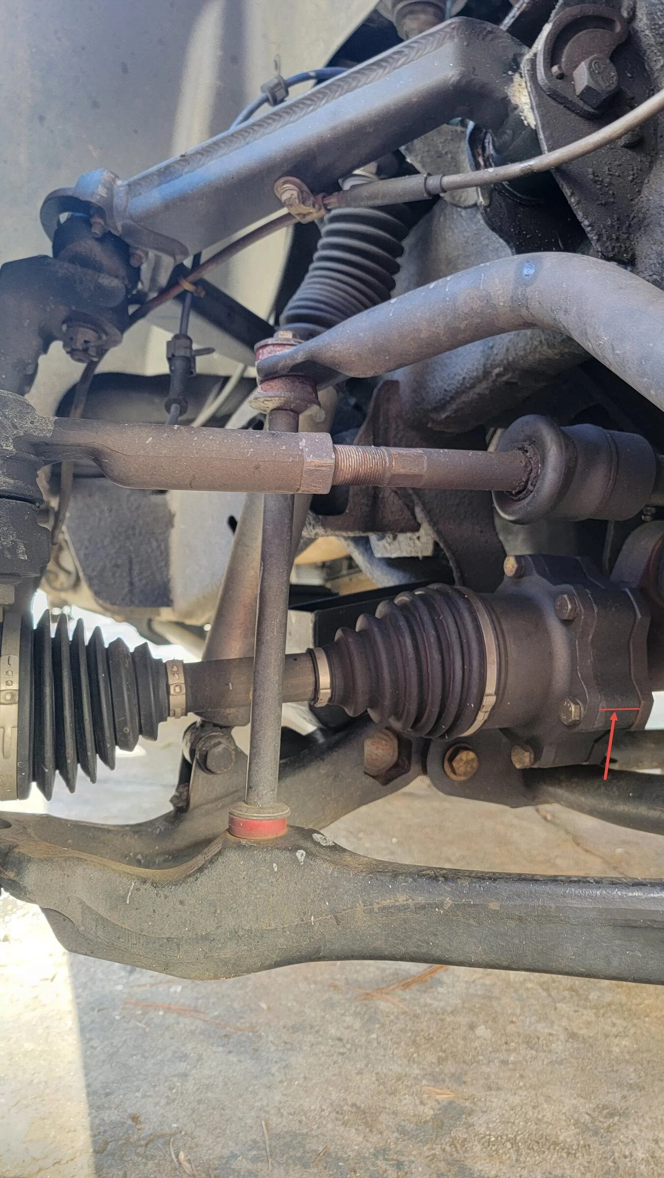

This sounds backwards. Dropping the front diff and installing a taller knuckle will maintain cv angle will it not? How will your driveline angle not be changed by lifting?
This is an H2/Duramax/Allision conversion. (not that it matters, I'm just proud of the beast. I know, it's too heavy and bulky for trails) with Rancho 4" true suspension lift. The spacers marked in red are necessary to maintain angles, With Spacer on top of coil, you are sitting on top of factory suspension, everything
Ford Bronco Another Broken Axle / CV Joint h2spac
below is in the same position. Think of it as a body lift, but this is easier since there are only 4 lift points.

Honestly not picking a fight here. But, a "proper lift" like a "Fox/King/Billstien coil over" looks no different to the CV angle than a "$50 Rough Country lift" or a stack of washers for that matter. The lifts you recommend will increase the CV angle - Period.
Lowering the differential can help control the CV angle on these lifts, but is also controversial in this community.
A spring preload can limit the amount of droop, at the expense of limiting travel, but this is no different than putting on a strap to limit the droop on a spacer lift. These will both limit the maximum droop, which will limit the maximum CV angle, but the CV angle is still increased at all times due to the lift imparted.
Control arm geometry does not impact the CV angle either. And, it is well documented that the stock upper control arm is quite capable of handling a 2 inch lift (with corresponding adjustment of the LCA).
No lift is more "proper". There is just the understanding and expectation of the end user.

As all of you know, there are many ways to make a vehicle taller. Bigger Tires, Body Lift, Coil-over spacer, the deluxe, most expensive is to drop the driveline. This method changes the CV angle and needs correction. For all but the driveline drop, CV and steering link angles will be exactly the same at the new ride height. That said, at full drop on a trail, the tire will drop 2" further and will change the angle. (assuming nothing else is limiting the drop, such as stops on the upper control arm, as is the case with GM 3/4 ton)
Coil over spacers absolutely will change the angle of the axles....
