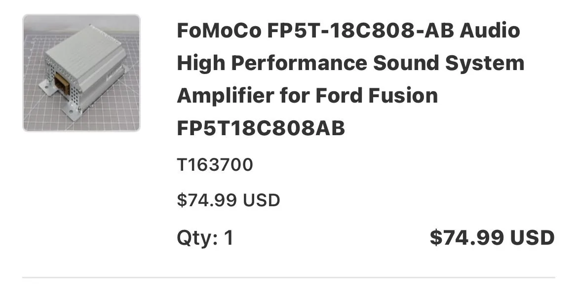

I have an FoMoCo FP5T-18C808-AB amp that I bought and never installed - it’s still in the original box. Happy to part with it if you need it. Send me a PM with your details and I will to sell it to you for what I paid it for. $74.99 plus shipping.
Ford Bronco Amp for new Subwoofer IMG_7582
