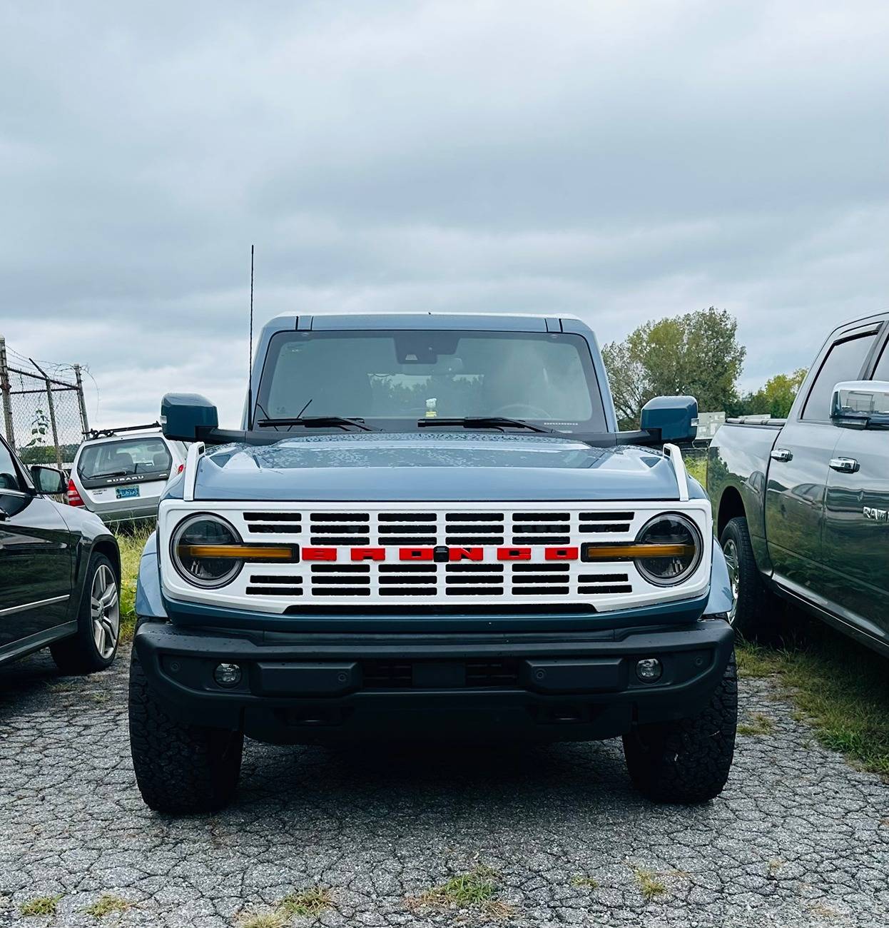

Hello, Everyone. Is it me, or am I actually seeing an Amber DRL on non Braptor rigs? Just the part for the turn signal, not the actual ring around the headlights. Wasn’t sure if I’m missing some sort of setting, or if this is an aftermarket thing. However, I thought it was stock headlights I saw them on.

It can be done with a simple change using Forscan. Mine are like that.

No kidding? Is it just the turn signal on yours, or the entire light? So you know what settings I would need?

Okay, it looks like they will only be Amber during day time. Once headlights are on, they will go back to normal.

I can't remember the settings. It is just the straight bar not the curve of the light. If you look at the Forscan thread it is on the common page.

That is correct - Amber DRL until headlights come on then back to white. No way to change that

I tried the Forscan change yesterday, and it worked on my 2023 Badlands. However, as much as I like the look, the amber DRLs are really bright, and I changed it back. Considering the height, that would be at eye level for most cars.

One thing I forgot to mention. After making the change on Forscan I noticed that the amber DRLs stayed on for 10 minutes after turning the truck off and locking it. I haven't read about that side effect anywhere, but since I changed it back to white I didn't dig further.

Well, that’s interesting. I’m probably just going to leave them as is. Even though it looks better as Amber.
