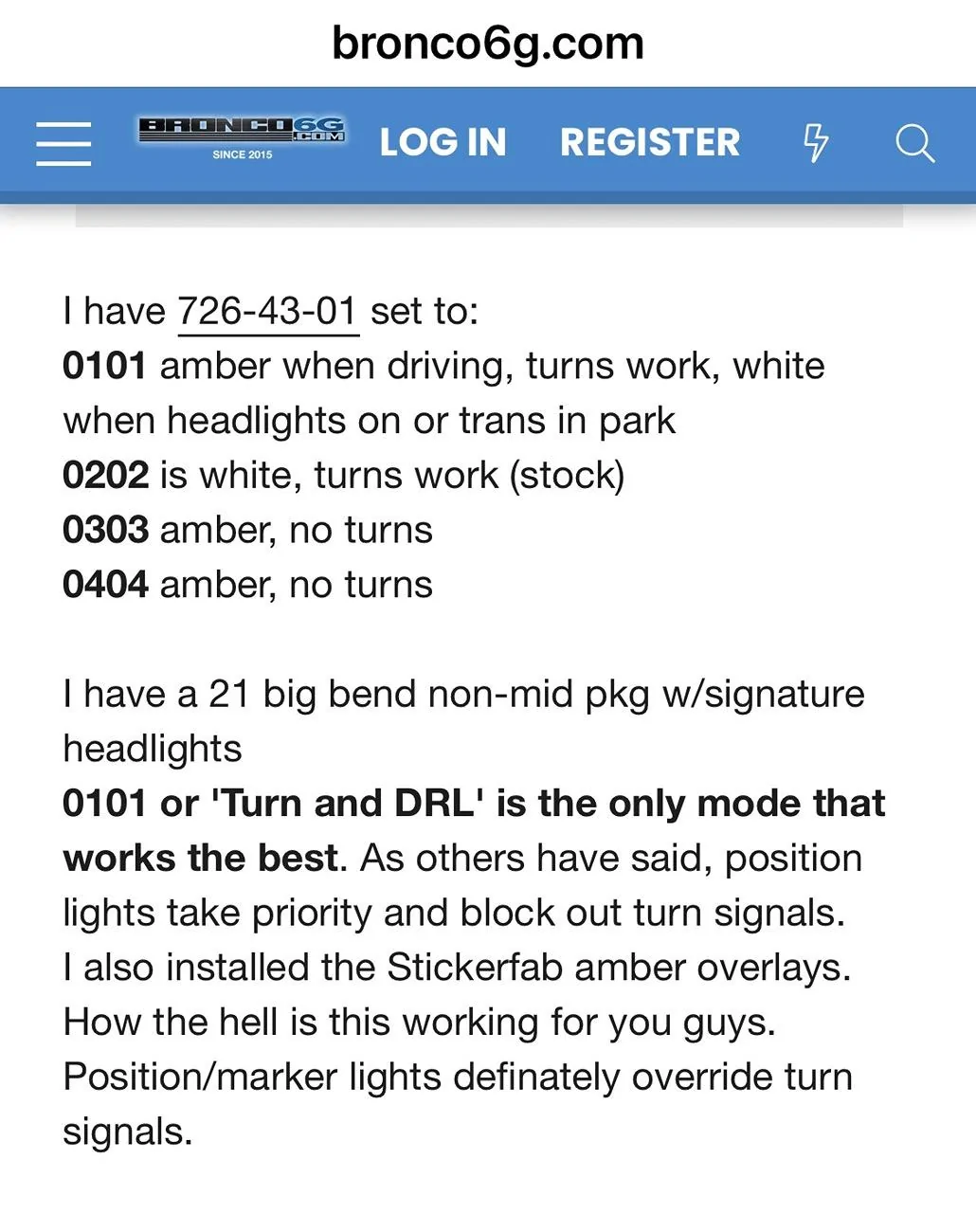

I believe you can make it work by using Forscan
Ford Bronco DRL when parked IMG_4049
