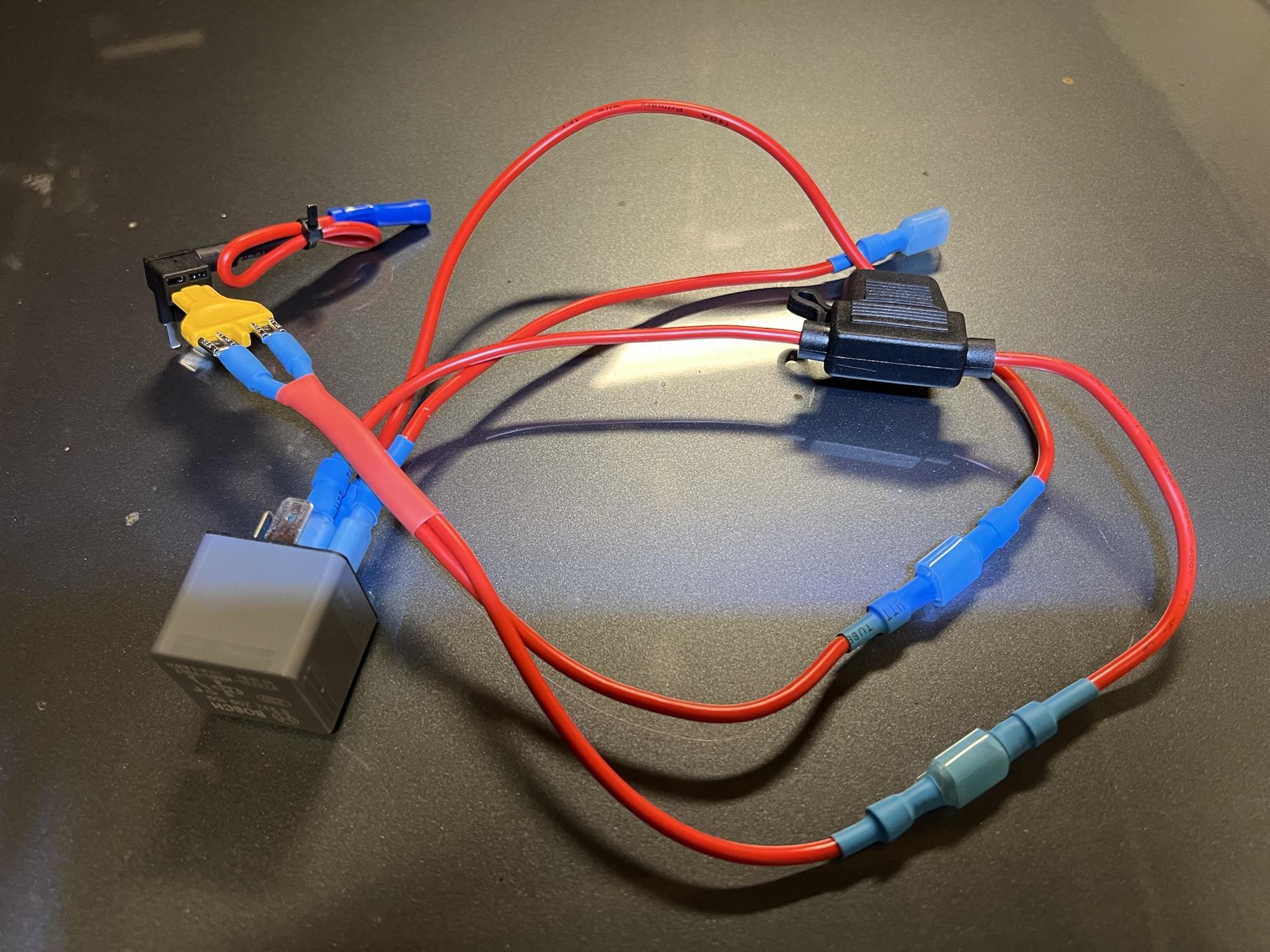

Here's my killswitch in action:
I ended up using the ignition coil fuse and used a regular add-a-tap adapter just to get a 90-degree bend (there's no room vertically for the socket connector). Overally, the wiring is pretty simple. A 20A inline fuse to replace the original fuse, and a 5-pin 20/30 relay. A 4-pin normally open relay won't work because at startup, the aux switches don't get any power until the car starts, and the car can't start without the aux switch being on and sending power to the relay to close the circuit. With a 5 pin relay, you can tap into pin 87a and leave 87 empty; when you flip the aux switch on it opens the circuit and kills the ignition coils.
