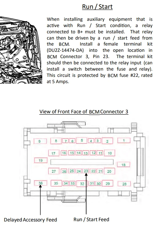

Fuse 18 in the under hood box is the starter circuit. It's 30 amps. AUX 1 is the only 30 amp rated switch. Fuse 34 in the interior box is the run/start relay. It is 30A as well. Or maybe fuse 19 in the interior box, which is just 5A and powers the ignition switch. Fuse 19 would allow use of any AUX switch.
I'm nervous about touching the circuits that involve the vehicle running (though the ignition switch idea could work, idk) so I had been planning to add a NO relay (normally open, ie no power flows through it unless you send it power to close the circuit) inline with the power to the starter solenoid (just assuming we have one and it's not all ecu controlled or something, have not done the research yet). That way I have to turn On the switch (upfitter, hidden toggle, etc) to power the relay, to close the circuit to the solenoid, then start the vehicle, then go ahead and turn off that circuit so when I park again it is safed.
Bonus points: daisy chain one switch & relay to another to even another so several have to be 'on' in order to start >: )
The switches are not powered unless the "key" is on. Might be a challenged to make them interrupt the start circuit when it is non-functional without power.
My first thought when I read your comment was "duh, of course the truck has to be On to Start so what's the problem?!" but then I tested and my a-pillar lights on upfit2, while they do turn on when the switch is on, they turn off during Start (so that was what you were referring to?), presumably to ensure enough current to turn over. Looks like if I decide to use an upfit will need to rewire. (or use a hidden toggle)
Anyone know if the Run/Start circuit described below will 'dip' like the upfitters do now? (would guess no but need to confirm) This could be an easy tap for the circuit power if not, especially since it's rated 5A and the relay should only need a fraction of an amp to do its thing:

Alright, I can tell you what didn't work.
I created a harness for myself to plug into the Mcase fuse location for the starter (it's really just 2 2.8mm female connectors) and relocated the fuse inline. That was then connected to a relay so that one of the aux switches would close the circuit. Unfortunately, it would appear that the aux switches are unpowered at startup, so the circuit remains open.
My new approach is to use a 5-prong relay and instead hook up either the ignition coil or fuel pump fuse to 87a. That way when the aux switch is on, the car will still start (since at startup all the auxes are off), but should immediately die once the aux switches are powered and the relay causes the circuit to open.
