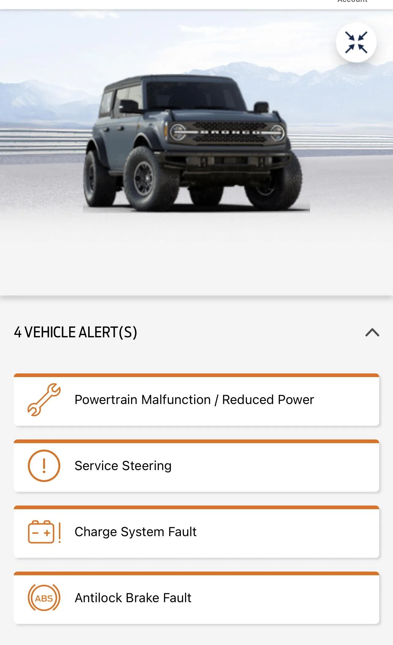

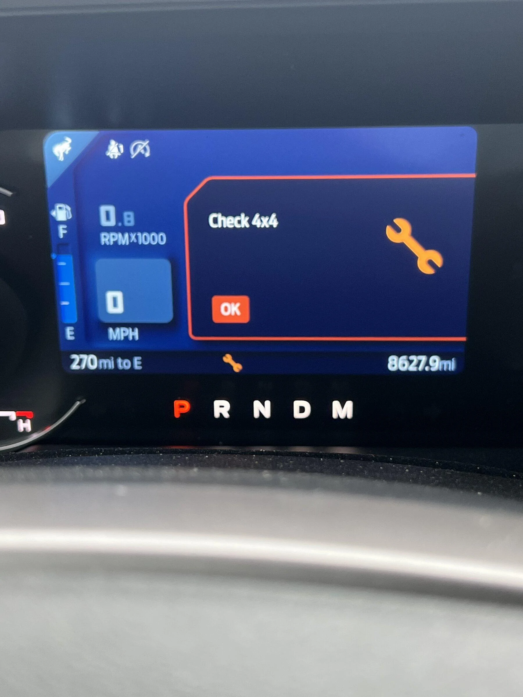

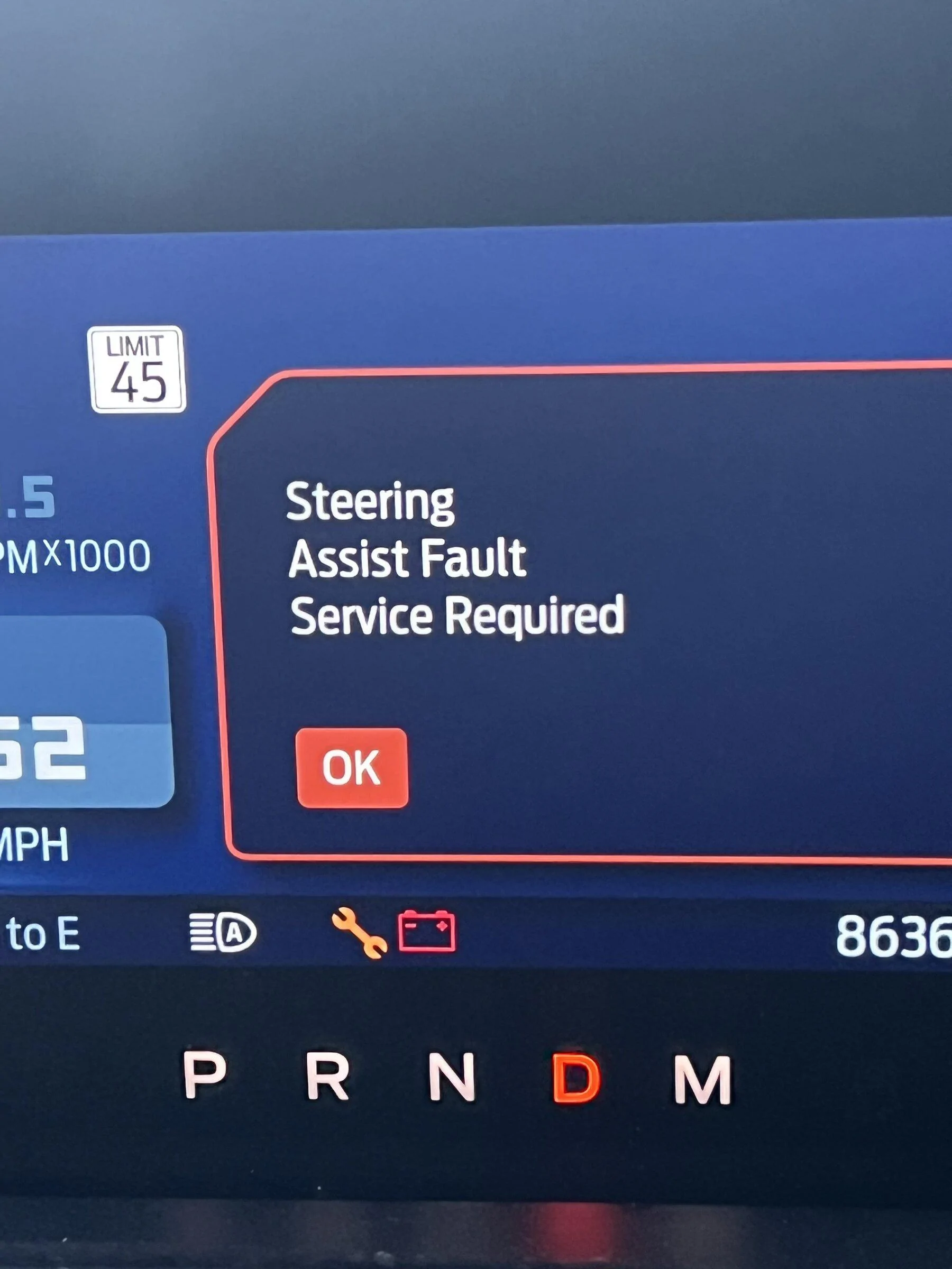

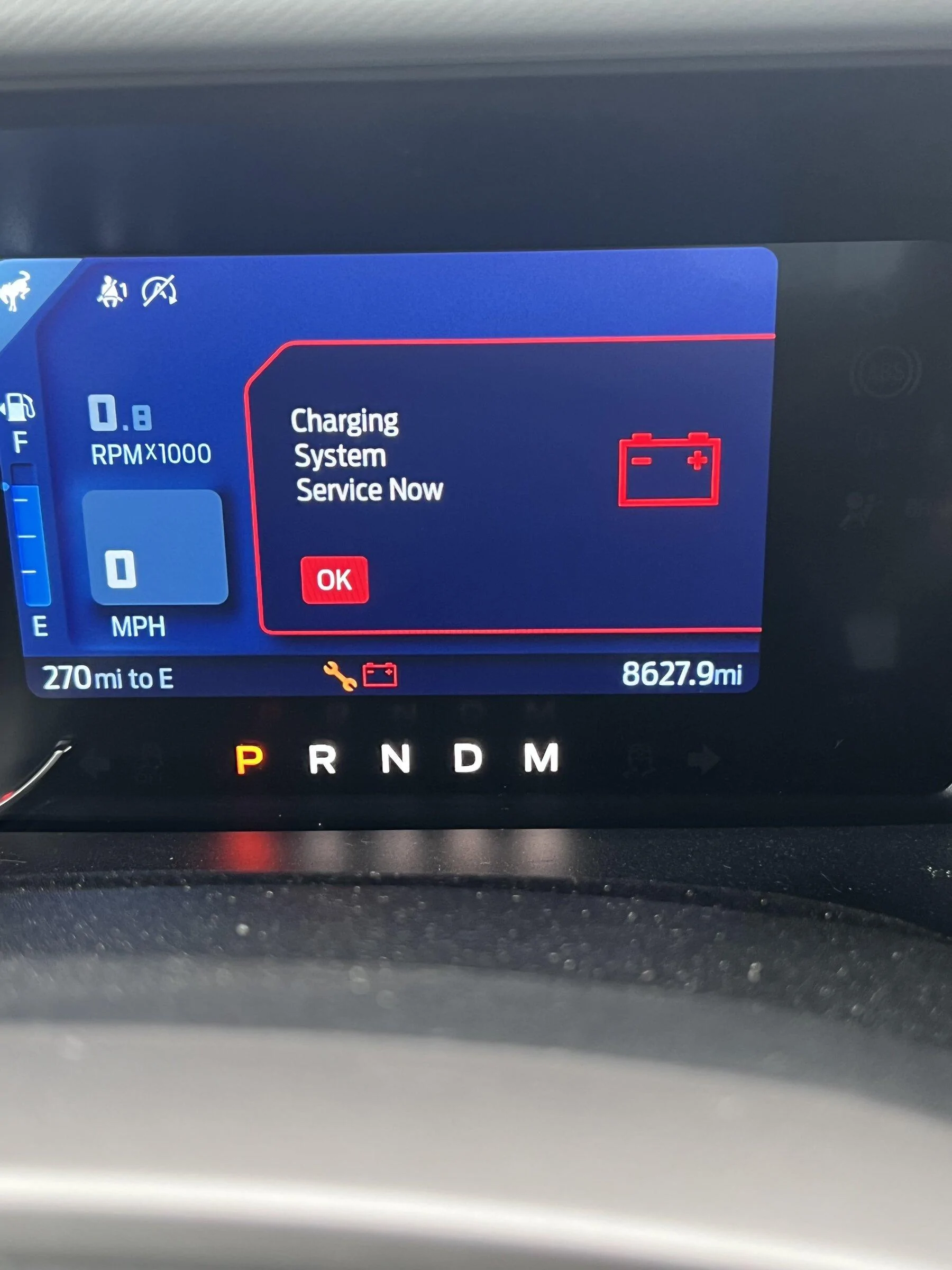

Welp, mine went out. 8600 miles. 3 day wait for the part. Caused every error possible to pop up as it slowly killed things off.
Welp mine went out Wednesday. 8627 miles.
As the voltage went down on the way to the dealer, more and more things shut off, then it died in an intersection and parking brake came on. Couldn’t open my tailgate to get inside my rear enclosure where my jumper cables were. Great time at 7:30am in the middle of one of the busiest intersections in town.
had been through many of mud puddles. But guess one from the Saturday before killed it, or washing the Bronco did? Hope to have the part in Monday.
