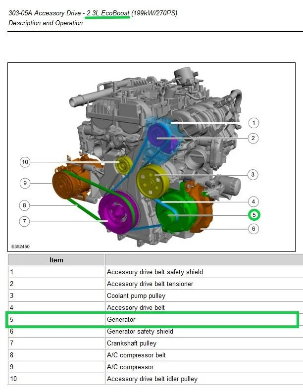

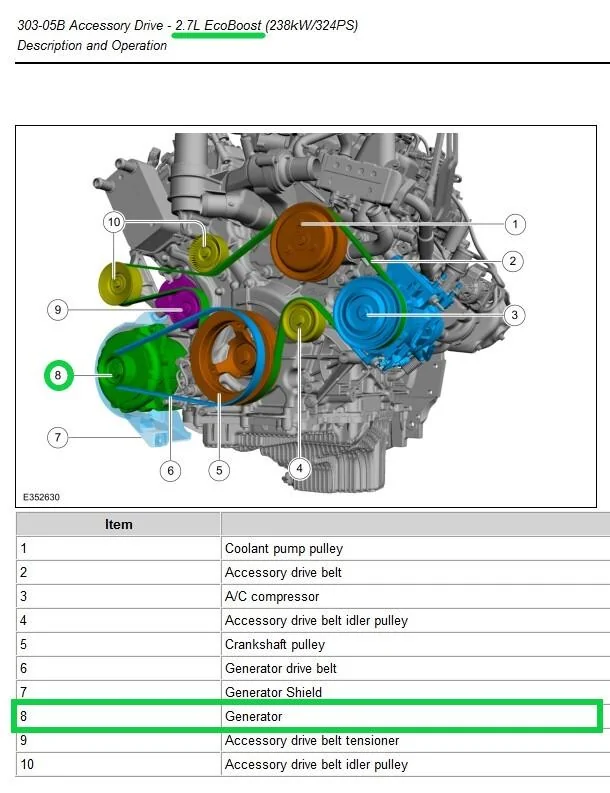

Please edit the title and original post with the engine you're referring to or, if it's both, make sure that that's clear in the post. Cheers.
The OP's failure (2.7L engine) was initially covered under a different thread, but Doug has now merged the two threads, so there should be less confusion going forward.
FWIW, both engines (2.7L V6 and 2.3L I4) have experienced some failures.
You just happened to have an unfortunate turn of events. Just because it sits low doesn't mean anything.
The physical location of the Generator (actual name in the Technical Service Manual) is not that dramatically different vertically between the two engines, although it is a little lower on the 2.7L, and it is located on the passenger's side of the 2.7L engine versus the driver's side of the 2.3L engine.
Ford Bronco Alternator stopped working (5,000 miles) 2.7L Generator Location
Ford Bronco Alternator stopped working (5,000 miles) 2.3L Generator Location
Was a Ford tech for 20yrs before leaving in 2018. I don't need a lesson as to why I said "generator".... wasn't going to waste time explaining why I said "generator" either because "actual name in service technical manual" or throwing out another random fact like "alternator" is trademarked by Chrysler motors.
If you read my post you would see that position of the generator serves no purpose in this matter. People get them wet all the time; be it submerging it doing some off-roading with a snorkel, driving around town on raining days with flooding, or just detailing the engine bay. It's very rare to one fail simply because it got a little wet.
I wasn’t trying to teach you a lesson. Just because I quoted your post, along with another user’s post, doesn’t mean that I disagree with you, and I didn’t even quote that part of your post. I was just adding additional information to the entire conversation. There are more people reading this thread than just you and me, and several people have mentioned the location of the alternator.
I only referenced the word “Generator” to minimize potential confusion about the two screenshots that I posted which clearly reference “Generator” and not “Alternator”. You and I know that Ford TSMs have referred to alternators as generators for years, but most other people don’t know that, and they might get confused by screenshots that reference “generator” if I was using the word “alternator”.
I agree with you that just because it sits low doesn’t mean anything. If you had read my prior post in this thread, you might recall that I actually demonstrated with a video that my alternator did not fail after driving through some pretty deep muddy water. 🤷‍♂️
