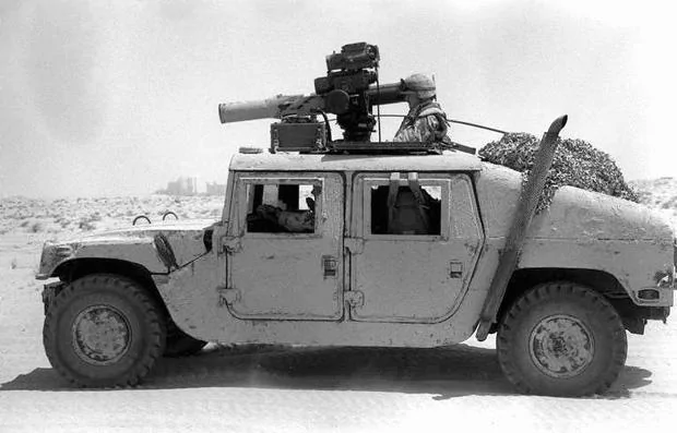

You know it’s funny the military humvees with snorkels also have a really high exhaust…that must be so the exhaust vents to dust free air…
the high exhaust is so if the vehicle has to stop while fording a waterway it can still restart the engine. If you don't do that, the exhaust will flood with water when the engine stops, and during starting water will be pulled into the cylinder and damage the engine.
i know that. I was using sarcasm. It was a response to someone that said snorkels are just to keep dust out of air filters.
