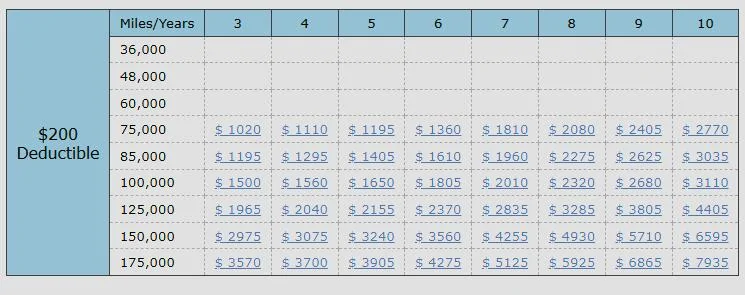

From my understanding you had a concern that your transmission for example might fail and you want to try prevent that by increasing the maintenance on it more frequently than the service manual is requiring.
Why not address the concern directly by getting an extended warranty to cover a transmission failure and do the regular service intervals?
For example, the manual calls for trans fluid at 150,000 miles. If you do a trans flush every 35K instead of 150K you would spend $1488.66X4= $5,954.64 at that 150K mark instead of $1,488.66.
Consider sticking to what the manual calls for, wait till 150K and instead of getting those extra flushes (saving $4,466) purchase the extended warranty so you don't have to worry about your transmission failing. Those savings could get you a 10 year 125K extended warranty, that covers way more than the transmission.

I think we are having a bit of a mis communication, probably my fault.
