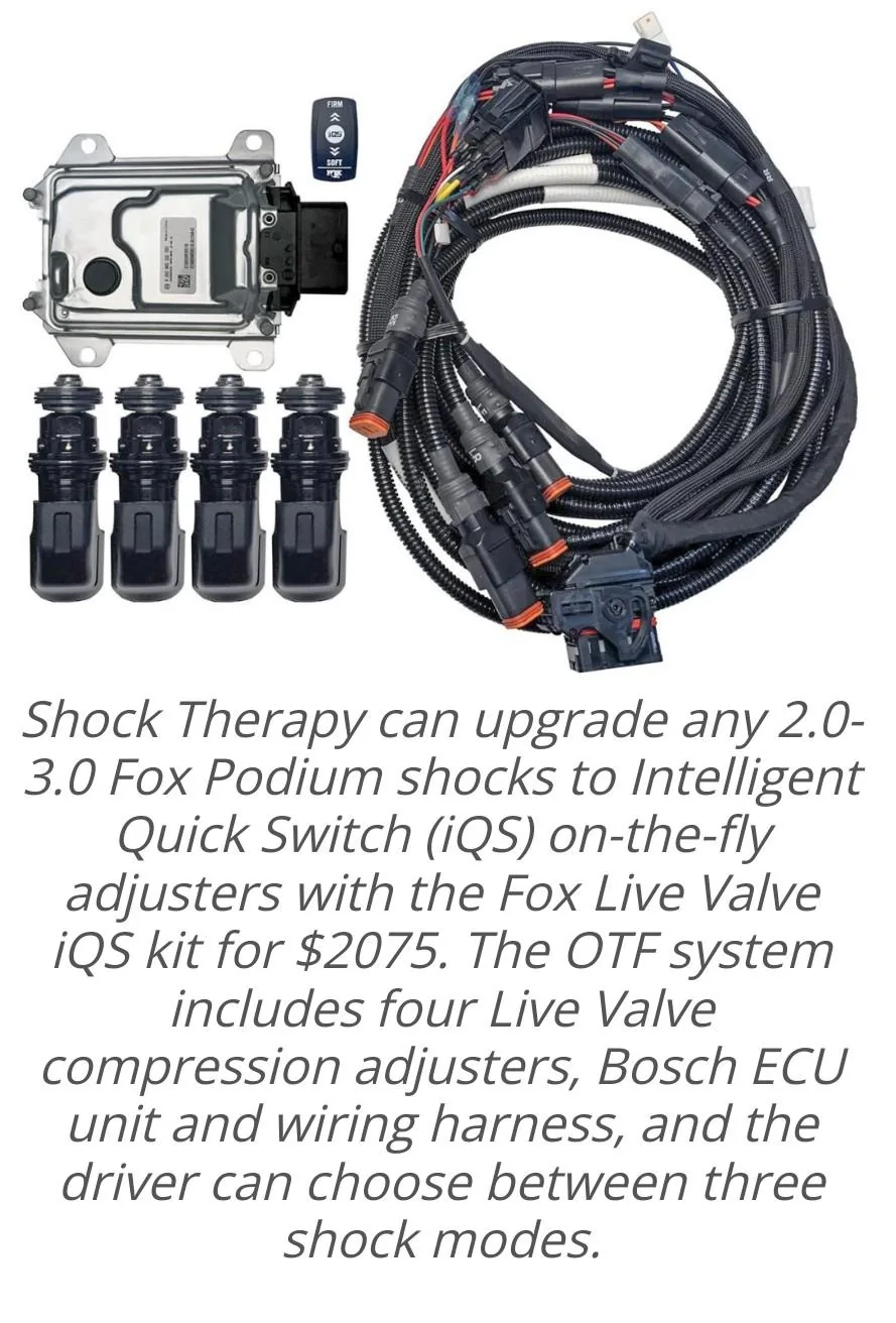

never ever....these computerized shocks have been available in the aftermarket for years especially in the side by sides, now in Jeeps, and soon whatever else you can imagine...even airplanes....
first 2 sec Google look shows these....I'm sure a deeper dive and there is more options... some with systems that integrate with OEM...
the Raptor active shocks are NOT special at all nowadays, more like fairly common

Your quick 2 second google search didn't get you past the conclusion that all electronic shocks are equal, which is patently false.
The Bronco Raptor system offers both a coarse electronic adjustment for overall damping levels but more importantly, through the travel position sensors and accelerometers, tunes the shocks actively at the millisecond level. Get airborne, the truck knows it is and it will stiffen up for landing. I strongly suspect the system also includes roll bar type stabilization by sensing vehicle roll and adjusting the shocks side by side in pairs. I haven't been able to verify this, but it's not at all out of the question from the hardware nor software perspective. Really these two examples probably only scratch the surface of what the real time system is up to.
On the other hand, the iQS system is effectively just a remote/motor driven damping clicker adjustment wheel, nothing more. It is not real time adjusting and it's not integrated into a vehicles real time sensors and systems.
